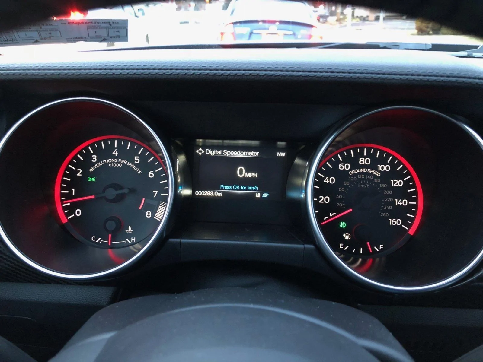

if installing an analog 18 cluster into a 15-17 and you change the vin to your 15-17 model would you be able to modify the odometer now or is it something in the 18 clusters programming that prevents it ? have read posts saying it can be done but wondering if anyone has actually done it. plan on trying it when mine comes in but just curious if someone already has tried changing the vin first and then programming the odo.FORscan is unable to update speedometer on 18 and 19 clusters.
Have been trying for a couple days and contacted the forscan team, gave them my logs and was informed it's not possible since the security in those clusters have changed. They are going to change the wording in the build notes to show that only 15-17 year models can the odometer write be used.
