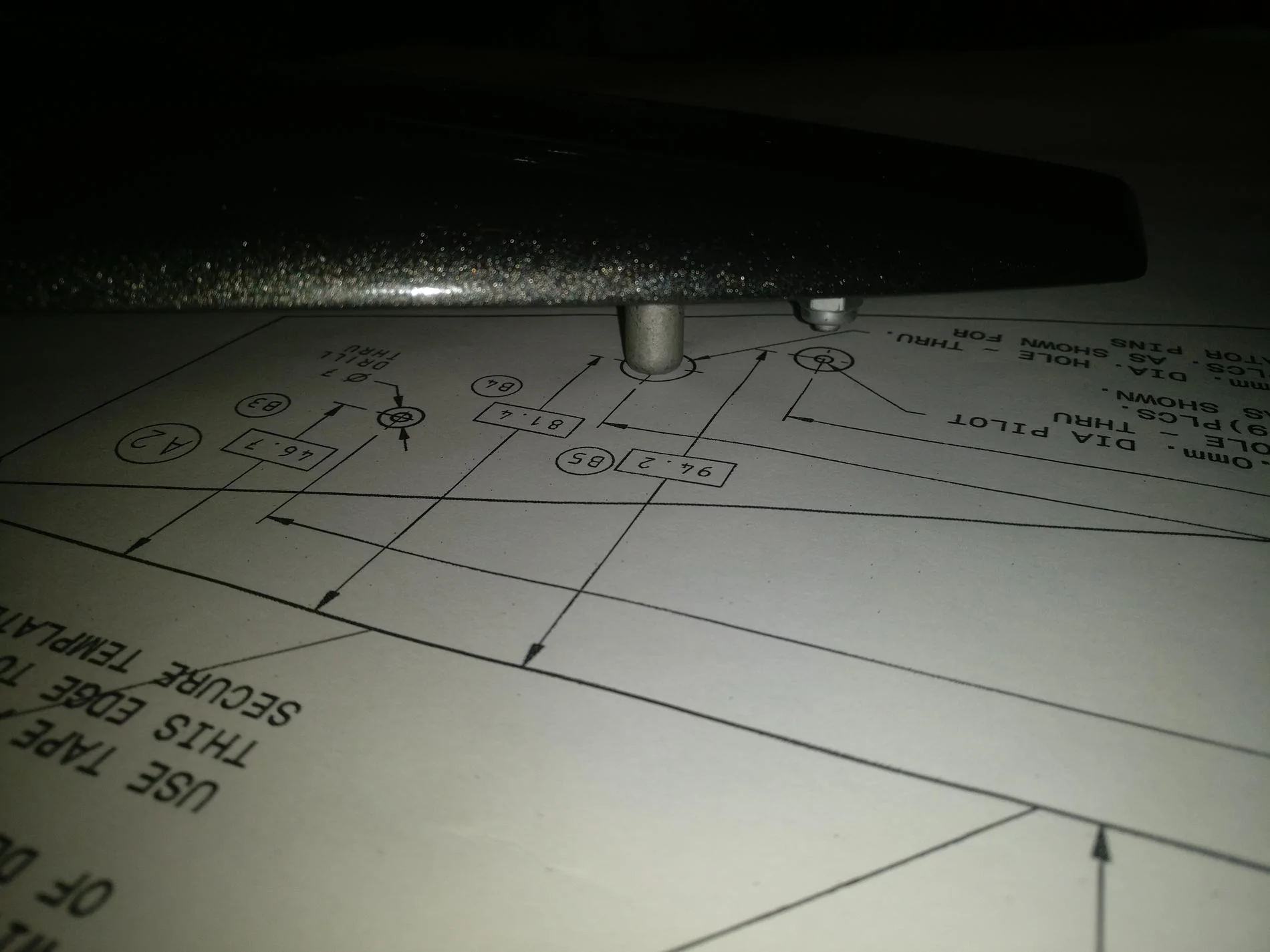

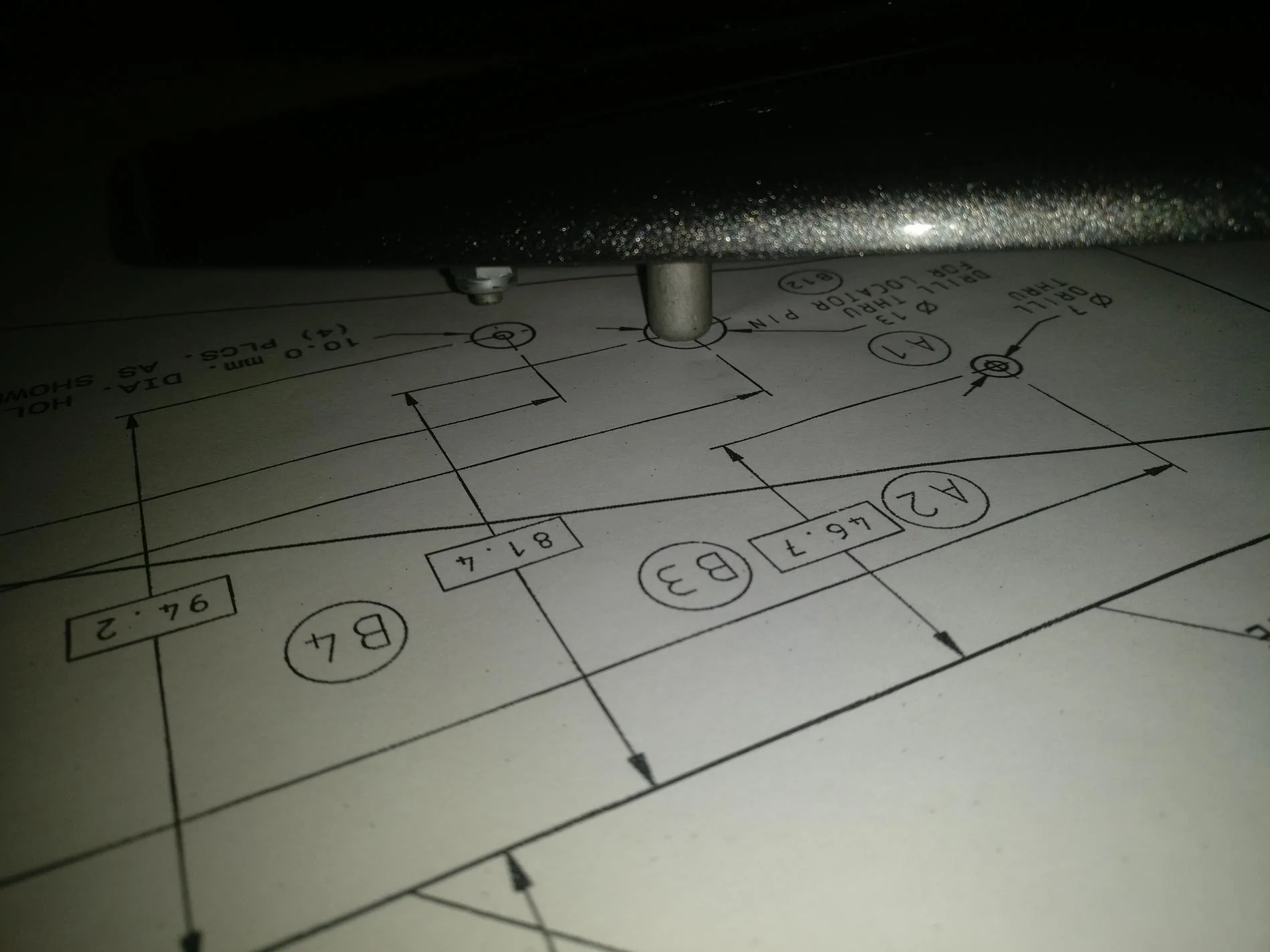

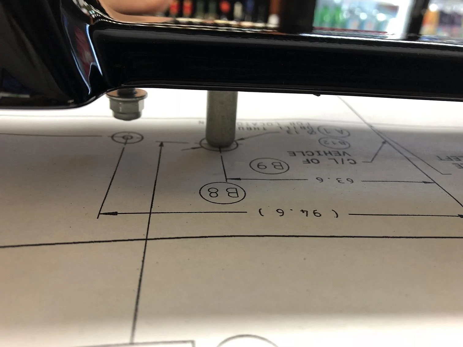

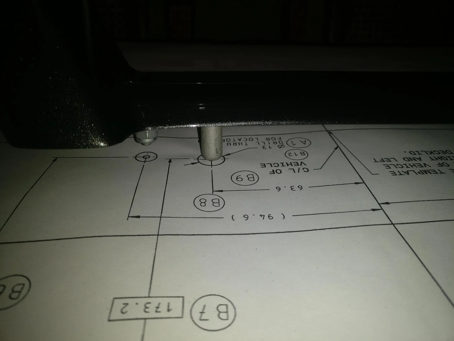

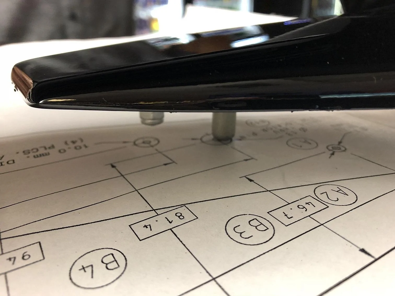

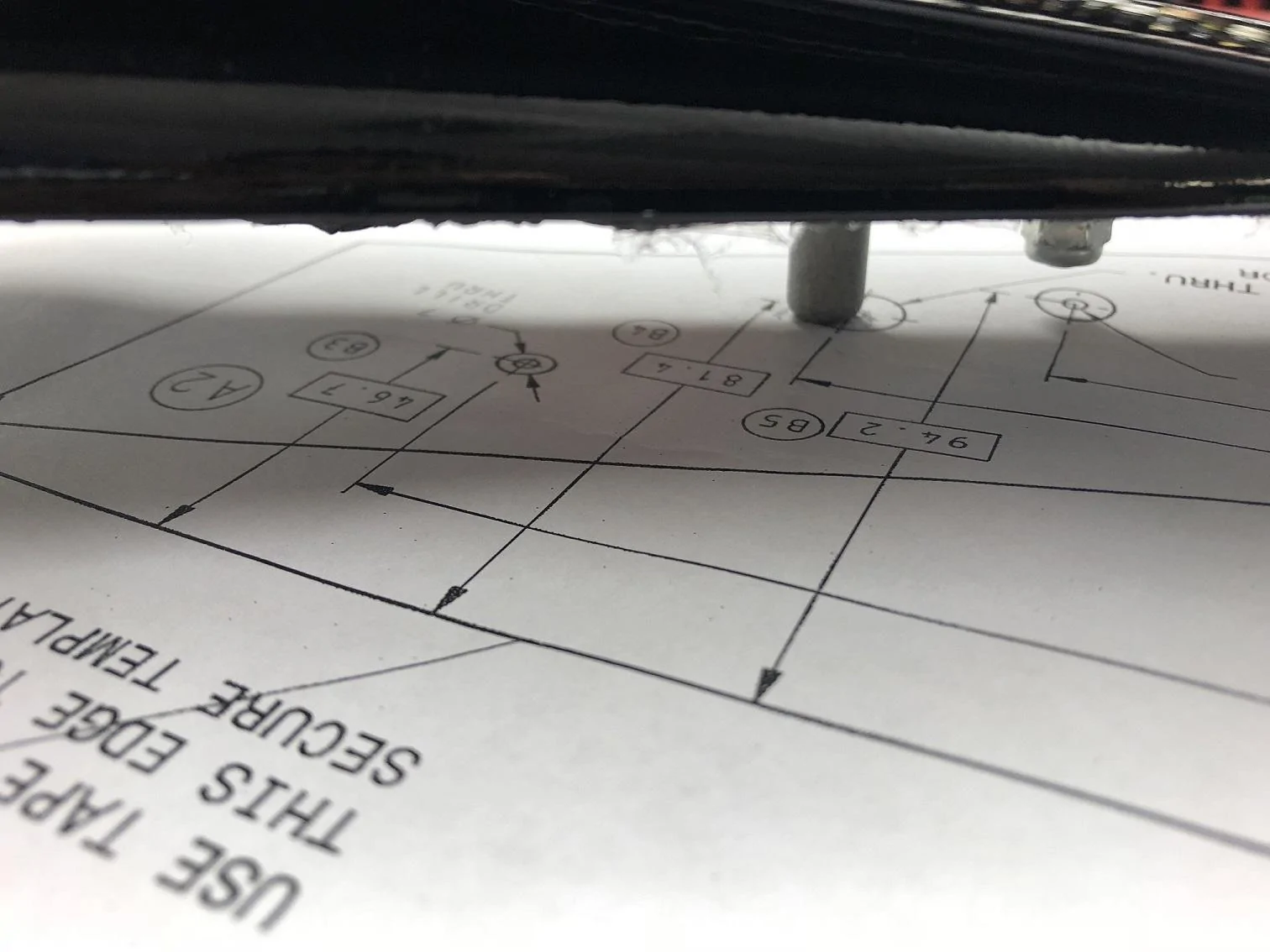

Like you, I was trying to install the 2018 pp spoiler.
I printed the template at 100% scale and verified with the 1 inch square on the drawing to make sure everything was to scale. My pins lined up pretty much perfectly and after drilling the holes based on the template, the spoiler slide right in. You should verify that your print was to scale on the drawing with 25mm/ 1 inch square.
What tape did you use? How did you figure out where to put the tape before installing? I’m about to start the same process as you.
ivans10
Jan 23, 2018
2016 Mustang GT
I used the 3MM tape but the one thats thick. I just stuck the tape all around the edge and also inside so that there are no gaps.
otherwise there will be water and debris going inside.
