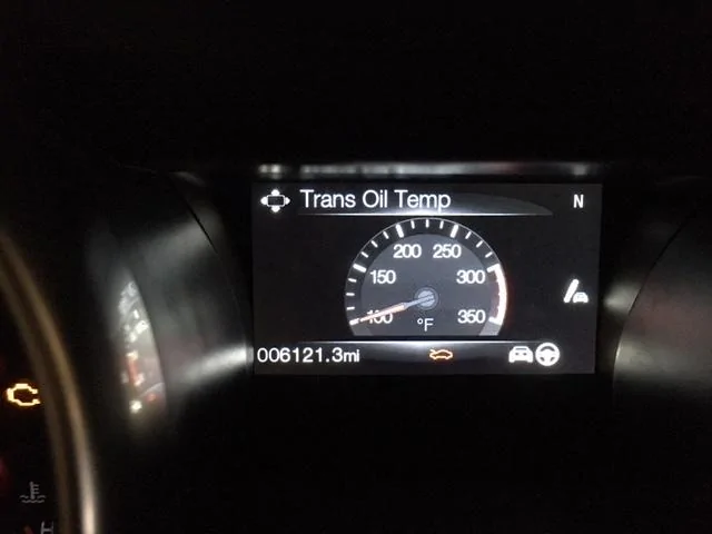

Alright guys, there's some good news and some bad news but we're making progress :thumbsup:
I just received my OBDLink MX today and began playing around with the settings like Epiphany and Mattlqx. Using the information Matt provided, I updated the Transmission Oil and Differential/Axle Oil temperature configuration (Address 720-06-01) in my As Built file (Tech Package) using ForScan.
After making those changes I was able to display both oil temperatures (transmission and differential) in my tech package, however the differential output shows up completely blank when you check under the Gauge Detail menu in the car.
Any thoughts on this?

You guys are awesome! I just got mine done this evening... now I can see transmission temps on my dash in my Tech Pack!
