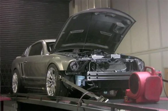

Bob wanted a four-digit dyno number from the rear wheels of his beautiful new Vapor Silver Shelby GT500. He knew what we had to do to get over 800 rear-wheel-horsepower from the previous Shelby project-more cubes via the Livernois custom big-bore sleeves, and the larger 4.0-liter Whipple blower were the two main differences in Bob's Shelby GT1000R. Horsepower is always a moving target.

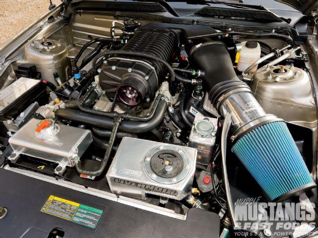

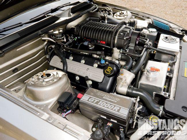

First, the Shelby's block was swapped for a wet-sump aluminum block with Livernois custom 3.705 big-bore sleeves, punching it out to 358 cubes. We then performed the usual decking and bore-honing. Once the block prep was done, we installed custom 9.3:1 forged pistons and Race Series H-beam rods on the Shelby's stock crank. Then porting Bob's stock Shelby heads to Race Series specs with its five-axis CNC. The stock valves were ground and back-cut to work better under the higher boost levels provided by the 4.0-liter Whipple twin-screw supercharger. Our CNC-valve machine was used to give these heads a killer multi-angle valve job.
The biggest trick to maintaining driveability is in the cams and tuning. Our team has learned a lot from using Ford's GT supercar cams in previous engine builds. The Powerstorm 1C cams are designed to work even better than the GT cams under high boost, and still drive like a stock Shelby the rest of the time.

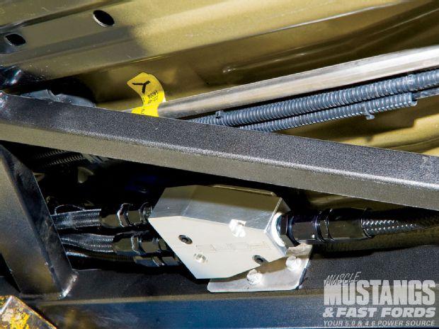

Keeping the fuel pressure high enough to make 1,006 rwhp requires sending large amounts of fuel to the injectors. This vital issue has been handled by the installation of Fore Precision Works triple-fuel-pump hat and Ford GT supercar fuel pumps. The pumps work with the Fore fuel rails, Ford Racing's 80-lb/hr injectors, and Fore fuel-pressure regulator to make sure there is always enough fuel to blend with the massive amounts of air going through the Ford Racing Performance Parts Cobra Jet mass air meter and Whipple Big Mouth throttle body.

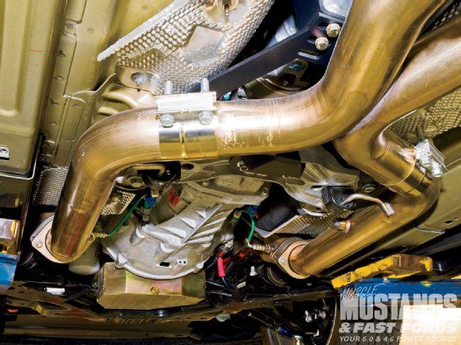

The team then slid the beast back into Bob's Shelby, and put the finishing touches on the driveline and rest of the car.The underside has been treated to Kook's 17/8-inch long-tubes with a custom 3-inch X-style midpipe feeding Magnaflow mufflers with 3-inch exhaust pipes. The Canton oil pan increases the volume and looks really cool. The bellhousing contains a Centerforce DFX Clutch designed to clamp all the power and send it back through the stock six-speed. We used an aluminum driveshaft to make the connection back to the 3.73 gears and Detroit Locker in the Shelby's 8.8 rearend.

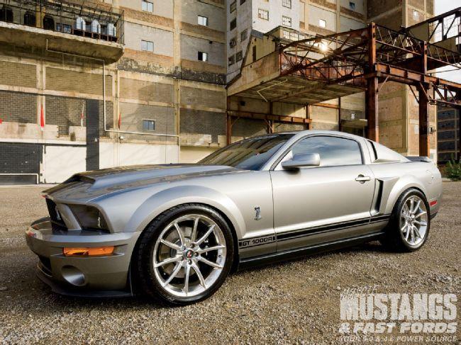

With the drivetrain handled, next was installing a set of 20-inch Shelby Super Snake wheels and Nitto NT555 tires. The QA1 adjustable coilovers and the BMR rear springs with QA1 shocks lower the Vapor Silver Shelby onto the wheels. The Super Snake wheels, along with the quarter-window scoops and Suncoast KR-style hood, provide a wicked, yet understated look.

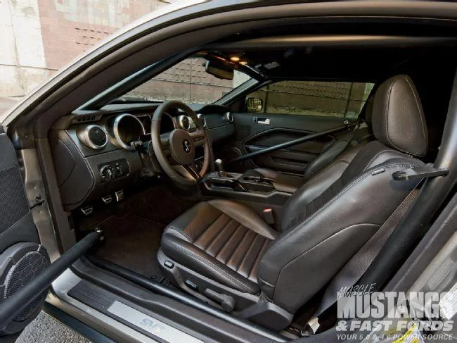

The interior of Bob's Shelby has retained all the creature comforts that it had from the factory . The door bars on the rollcage swing out and can be removed for easy access.
