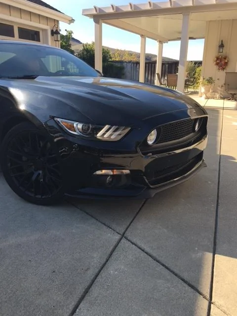

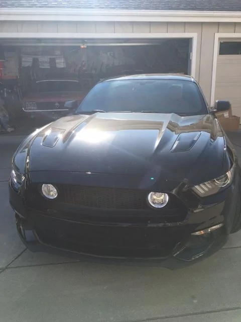

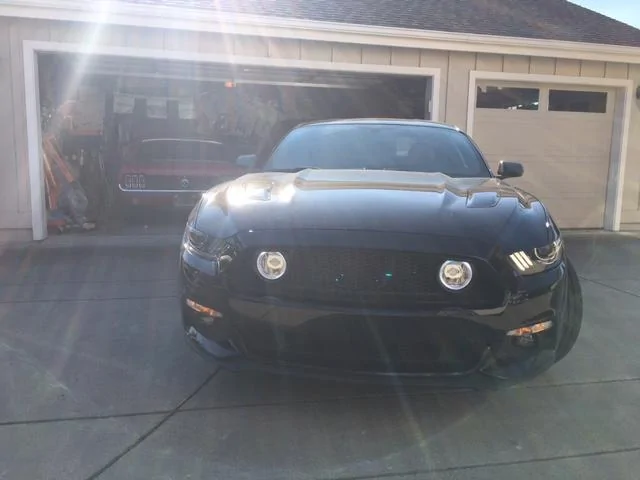

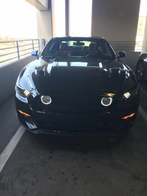

Hey guys this is my second attempt at making a grill with fog lights and I think this one definitely came out better in my opinion. I used a 50th anniversary grill and cut out the center. I ordered a grill from a 2013 Mustang GT and cut out just the fog light bezels. Then I ordered a mesh from customcargrills.com and glued it to the 50th grill. I cut holes for the bezels and used Raxiom halo fog lights. I'm going to add a tri bar emblem in the middle like the Boss 302.
