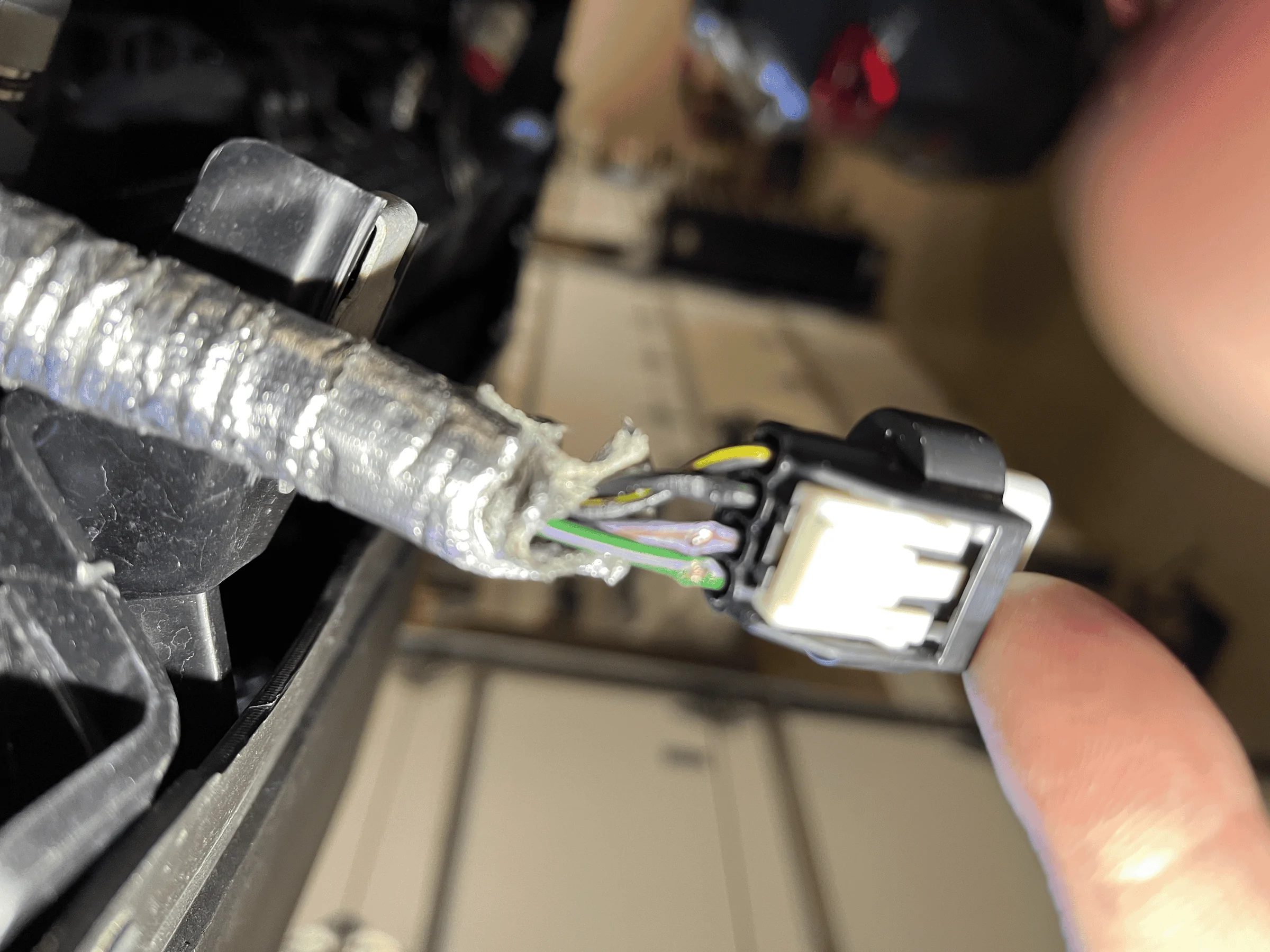

Driving home yesterday, got a message, unable to change active exhaust settings. Have seen this problem on other posts. I'm at 1,500 miles, didn't take long for my wires to wear through. I wish I would have marked the body where the sheet metal is wearing through the wires, but I didn't as I would have cut a notch there.
So what is the most durable fix for this other than just fixing the wires and putting it back in the same spot?

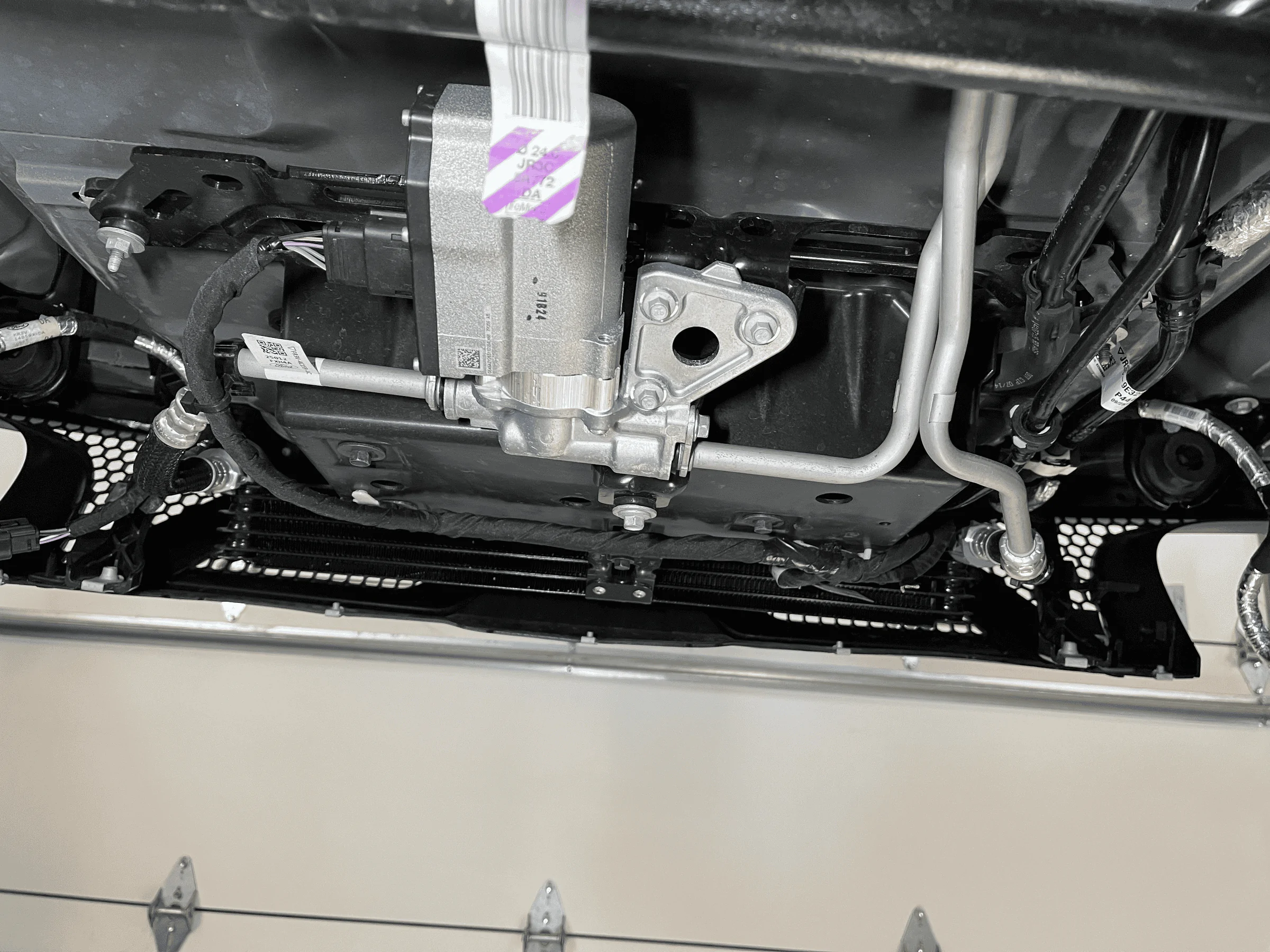

Yes, just a small radiator and the oil pump. It's dependent on air flow but is actually quite nicely ducted. I think it should work fine. Will test this summer when it's nice and hot at the track.
