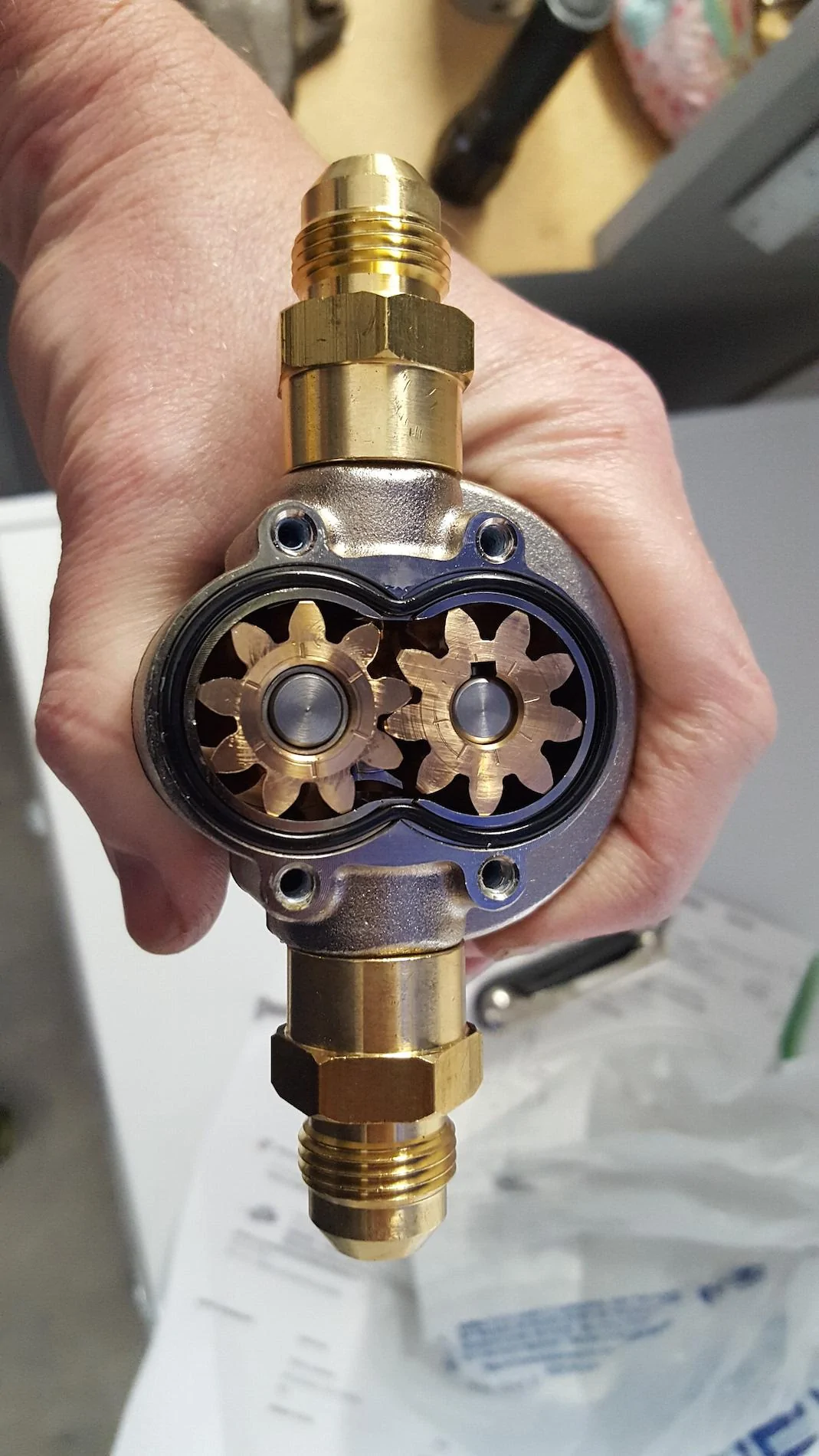

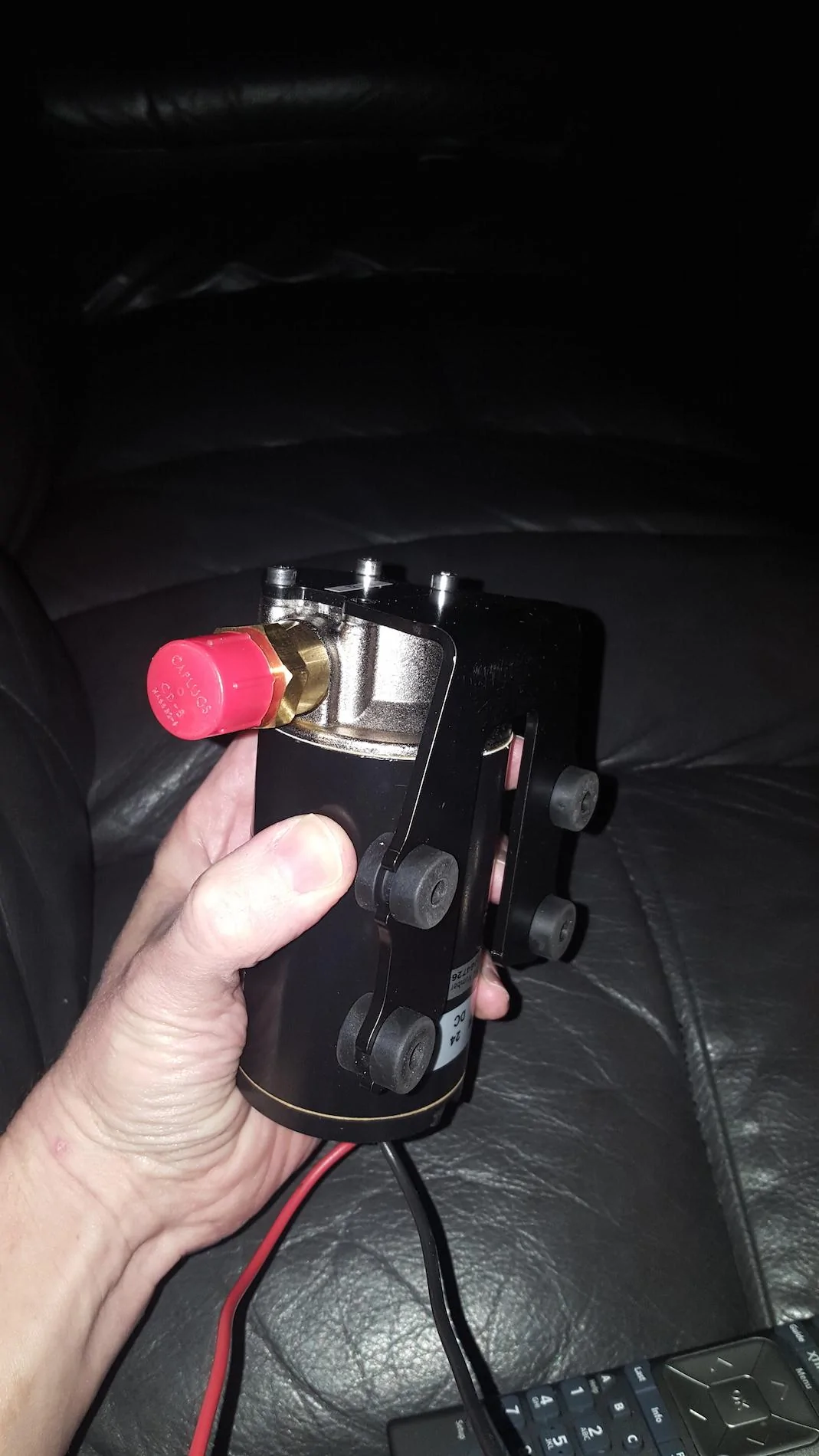

Great Deal on Mocal 17311 gear driven pump for trans/diff for you '15/16 guys without coolers. Regularly $300, with discount RPWLOVE now until Feb 14th, it's $257, no tax, free shipping. Already has brass 8AN male fittings attached and comes with a bracket with rubber insulators to reduce vibration. Shows white in the pic on their website, but it's actually black-

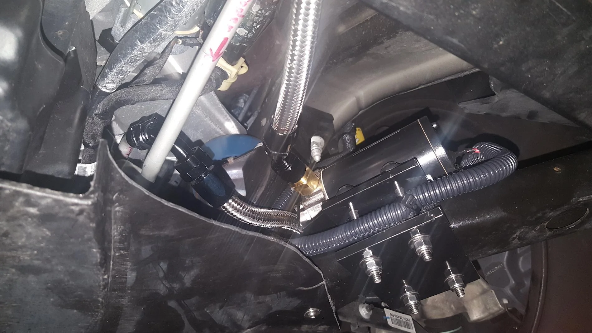

I am using this for my trans cooler, very quiet, can only hear it if ALL of these conditions are met: car stopped, at idle, windows up, radio off and A/C off. It then sounds similar to the noise when you turn on the A/C on low.
