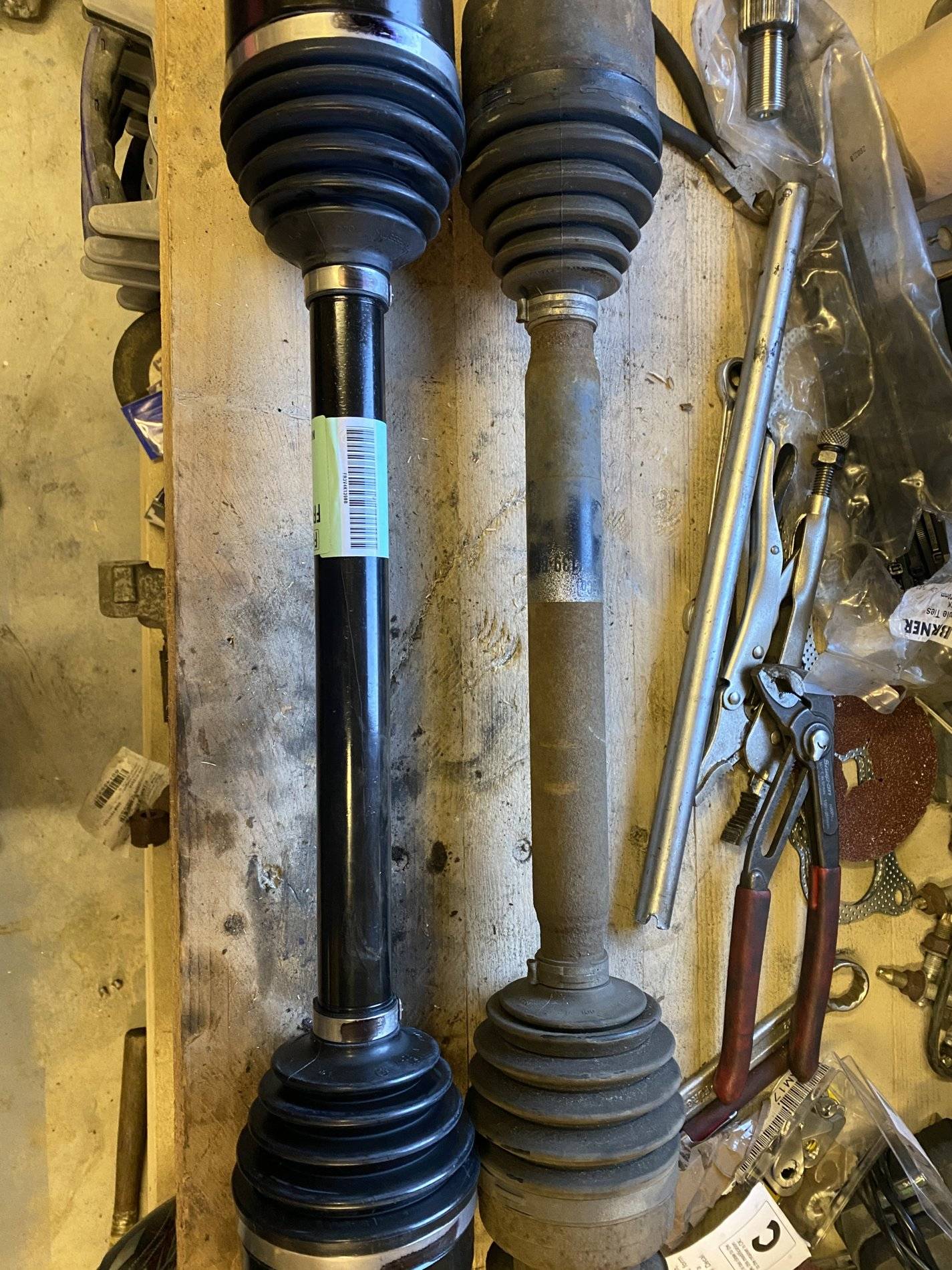

Just for information guys, l just finished putting a set of GT350 half shafts in my 2018 10r80 GT. The drivers side is noticeably different, no necking down on the axle at all. The passanger side axles were identical, no need in changing both axles. Had l known that l wouldn't of changed it, as my car only has 3800 miles on it. Just in case someone else is going to do the same change, you can save yourself a little unnecessary work, although l will say for doing it the first time it was very easy, no problems at all.

The GT350 axles are an upgrade for auto (18+) only it seems, on manual cars they're about the same.
The passenger side looks nearly identical from 15 and up, manual and auto.

Yep the left side is the same thickness all along and the CV’s are larger too.
right side is identical.
pic below of left side GT vs GT350
