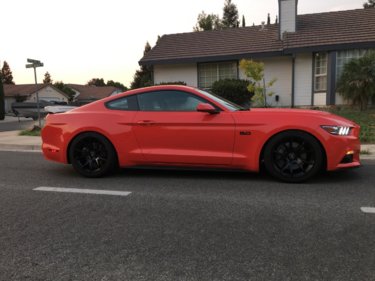

Here's my car with them installed. Available very soon! They had parts going out for anodizing, camber plates being machined etc. they are in production!Pretty much sold on this. Waiting for availability and installed photos
