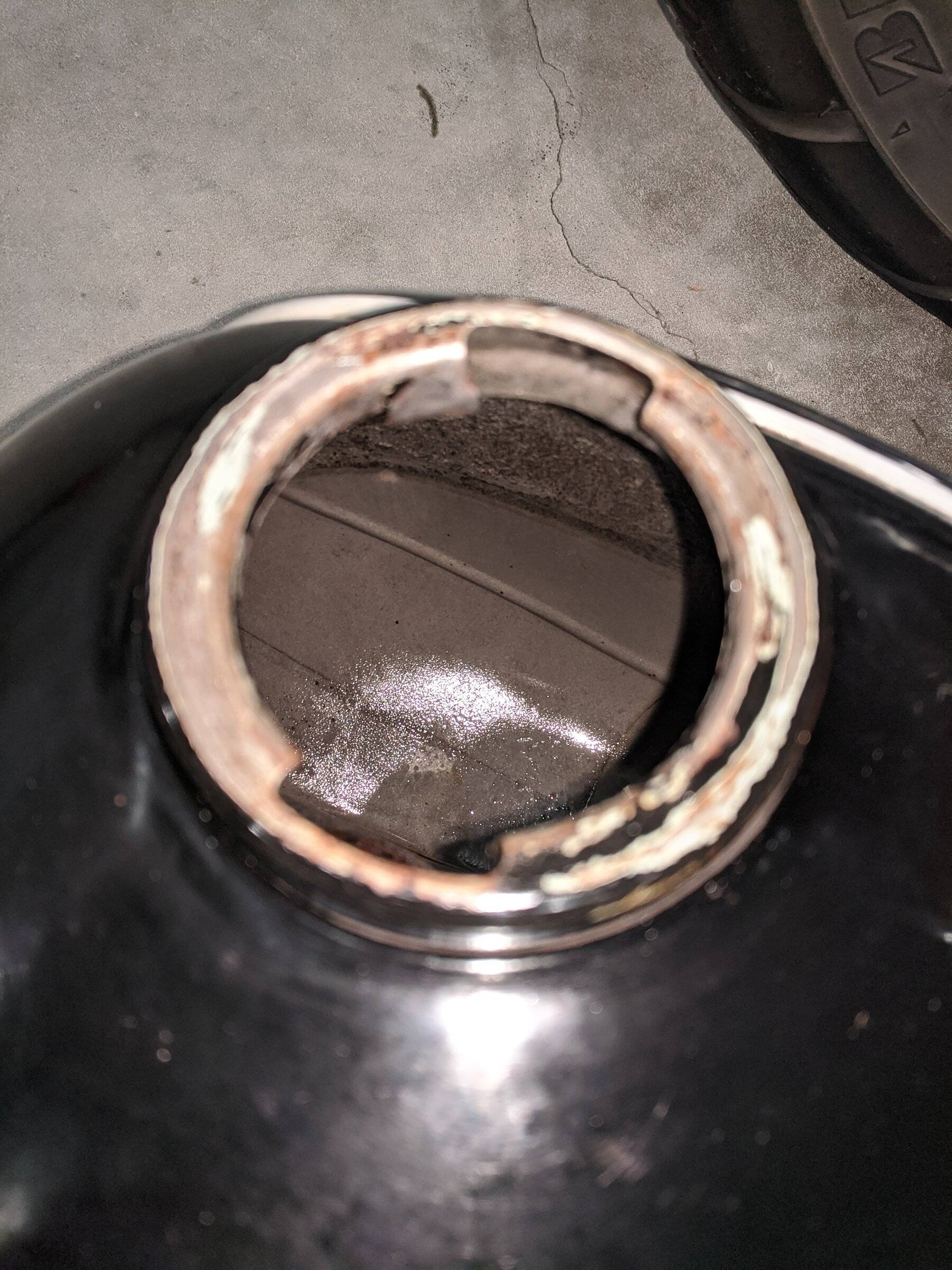

Hello; found an online article about removing rust from inside of metal gas tanks. It is about motorcycle tanks but I suppose will work on any metal gas tank. I have two old metal five gallon gas safety cans I may try this on. One of the things i look for when shopping old cars is the condition of the fuel tank. It will not be of value to newer vehicles which have plastic tanks.
