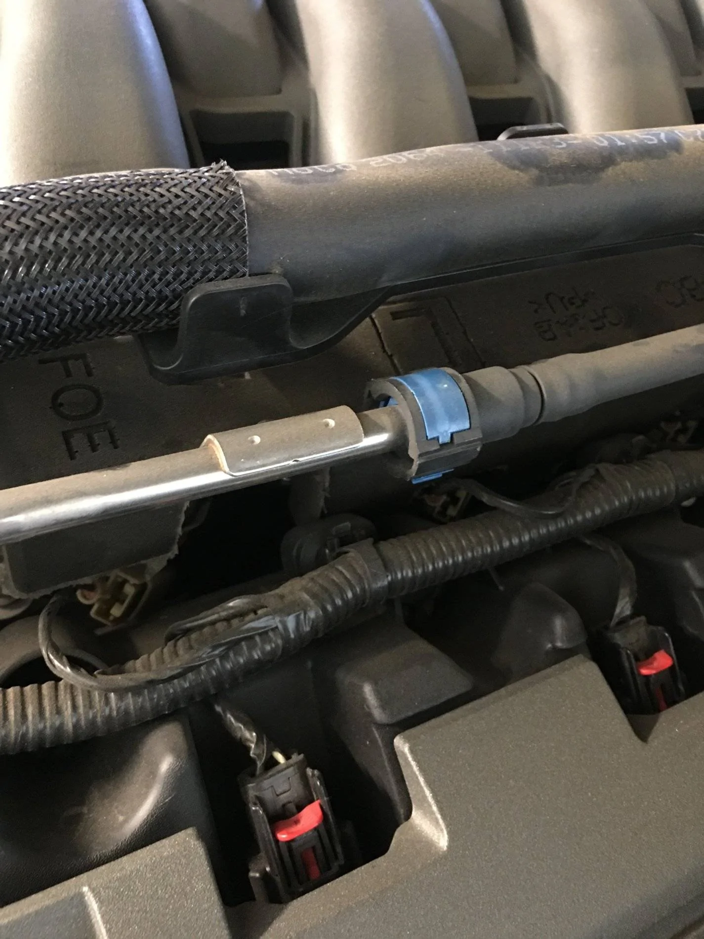

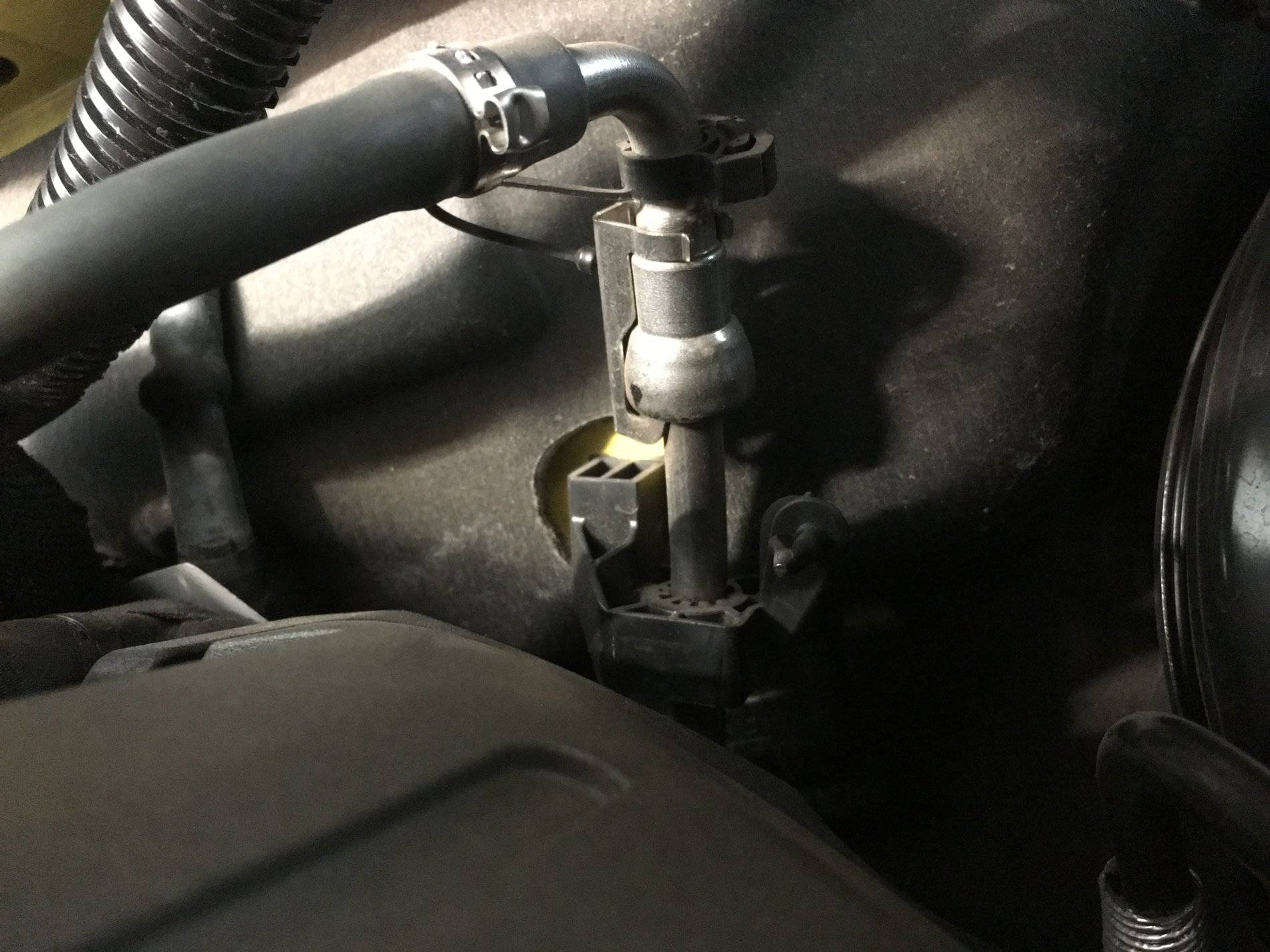

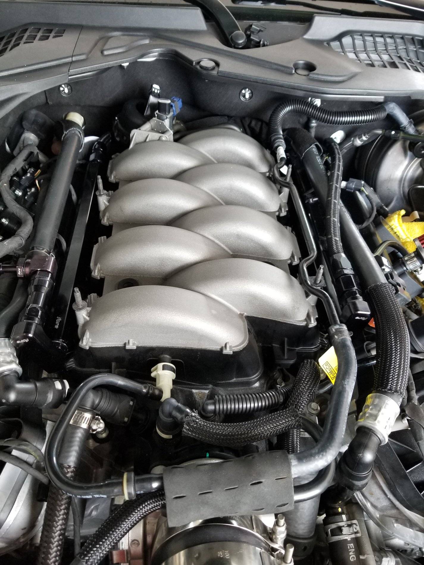

I'm trying to plumb a fuel filter in the engine bay and i'm curious if anyone knows...
...the steel retaining clip type connector that ford uses to transition from steel fuel line to plastic...
could i use a standard plastic quick connect ( like the one that attaches to the rails) to attach at that point or will it have to be the steel retaining clip type to work??

for reference...here are the two different types of connectors i am talking about...
any advice would be appreciated!

Thanks for the pictures!
Why would you recommend not installing a filter in that area?

I'm assuming the fuel supply line goes from the tank and routes under the car into the engine bay. If it were me, I'd run braided line from the tank and place the fuel filter under the car and finish running it with braided line all of the way to the engine bay. You could use simple rubber lines and plastic fittings from Dorman. Only difference is appearance and cost, functionality of both are the same.
On a side note, if you are going to ever use E85, get the ethanol compatible lines. Also if you are going to ever run a ethanol sensor, now would be the time to figure out the configuration. Good luck.

Well I’m using the sai li kit so I was hoping to keep the factory line and just put the filter right before the rails to save on cost.
I’ll be running e85. Others than seeing ethanol content, what’s the benefit of running a sensor? Are there people doing FI flex fuel tunes?
