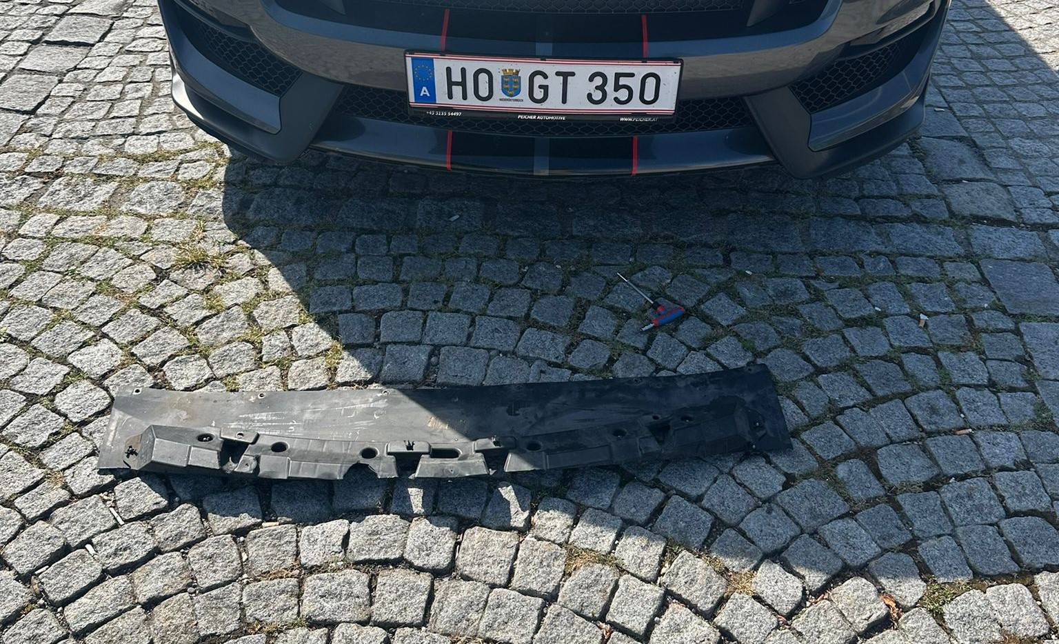

...Also my front splitter flew away.
So, back in 2016 when the GT350 was first introduced, the front splitters were shipped in the trunk for installation at the dealer. At the time, dealership techs didn't understand that the front splitter was an aerodynamic component - they thought it was just a decoration. So they clipped it in at the front, put in the back row of screws and sent the car on its way. At about 90MPH the splitters would detach and drag on the ground under the car. Sound familiar?
Here's how Ford said that they're supposed to be installed:
The fastest i went was 170mph, but at 90ish mph the splitter said goodbye. But the way it did detach was the same way you described it. I had to stop at a gas station and buy some tools to unscrew the part that dragging on the street. The only Problem was that the Car was to low so i searched for a big enough stone for clearance
