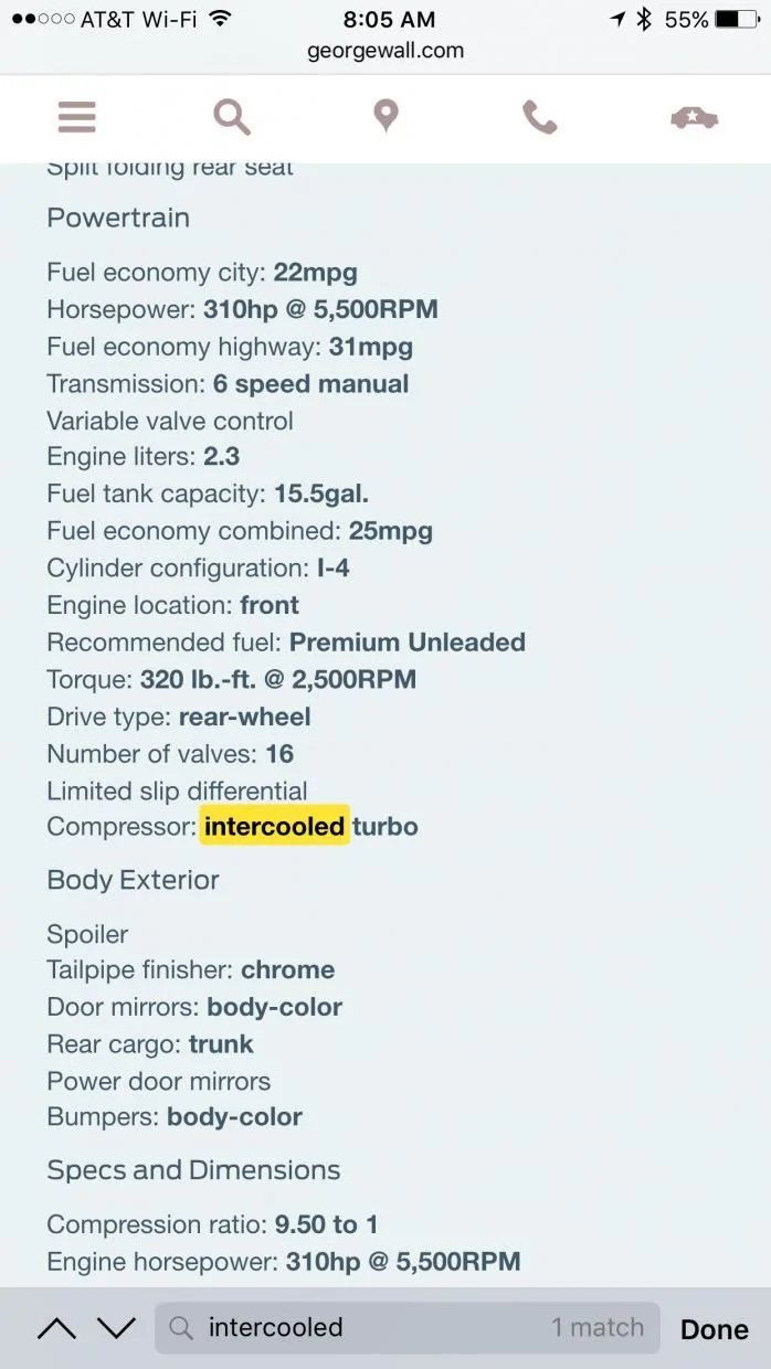

The factory intercooler is marginal even for a stock car. If you're tuned, tracking the car or even just live someplace warm, you probably want to swap in either a direct fit (like the cp-e that just arrived at my door) or if you're really pushing it one of the bigger ones like Levels or ATM.
Yeah, ecoboost turbos come with a intercooler but it's not very big and if you are in a hot area of the country and with the pedal to the floor all the time after awhile you are going to get heatsoak and reduced performance.
The solution is to put in a bigger and/or better intercooler, it will get rid of most of the heatsoak.
