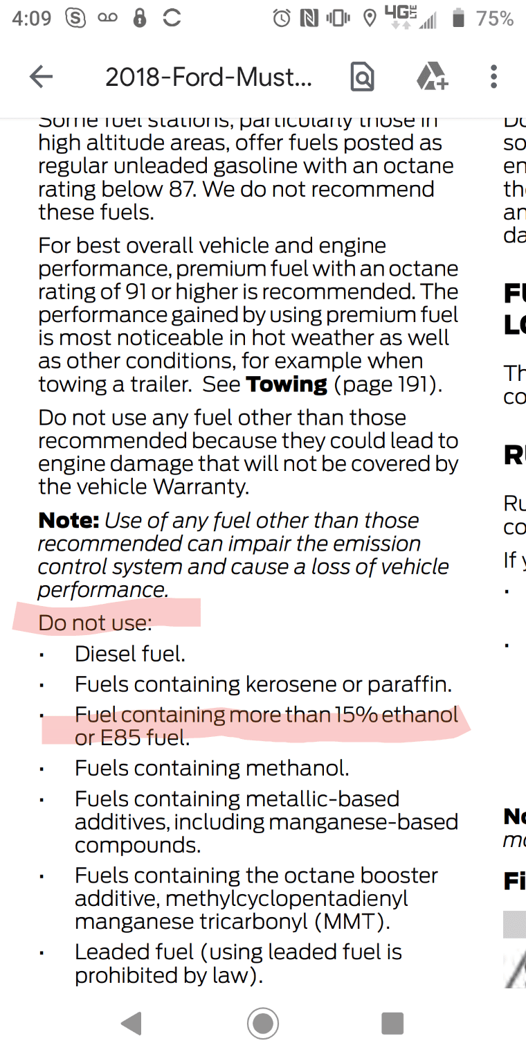

Also, per the owners manual, fuels containing more than 15% alcohol should not be used. Last time I checked, to get 95 octane by mixing e85 with 91 octane it resulted in ~e43.
That's the point I was making to Dave. E85 itself won't cause harm (as we see with all the e85 tunes cars) but the stock/FP tune may not have the right air/fuel ratio when running it. Although I have read about the stock tune adjusting for higher than e15. The unknown factor is what the FP tune will adjust for.

Although many do it with a tune, alcohol affects things other than A/F ratio. It's very corrosive to seals that aren't designed to handle it, and there are issues with water created by alcohol. For me personally, it's not worth the risk. I plan to have my car for a long time, and I'm not doing something that has potential long term to do damage. Ford says don't do it, that's good enough for me
