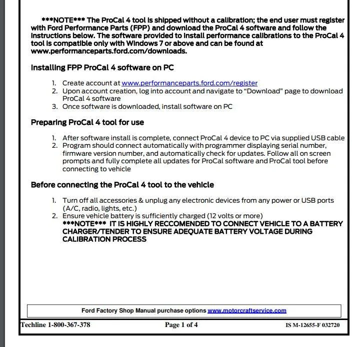

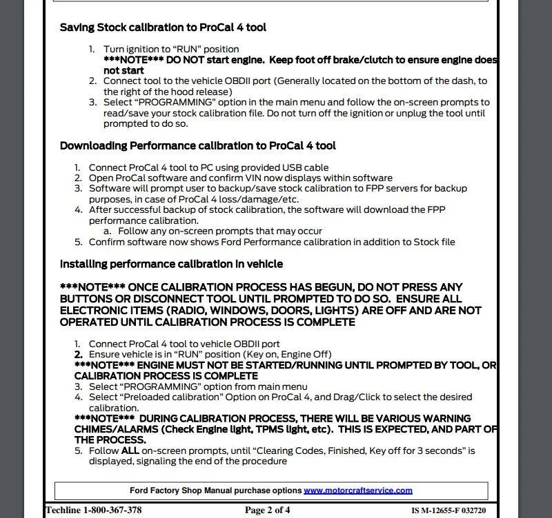

    That is literally what the instruction sheet says...If you follow each step in the order they are on the instruction sheet, it's exactly what you said. Instruction 1.JPG Instruction 2.JPG
