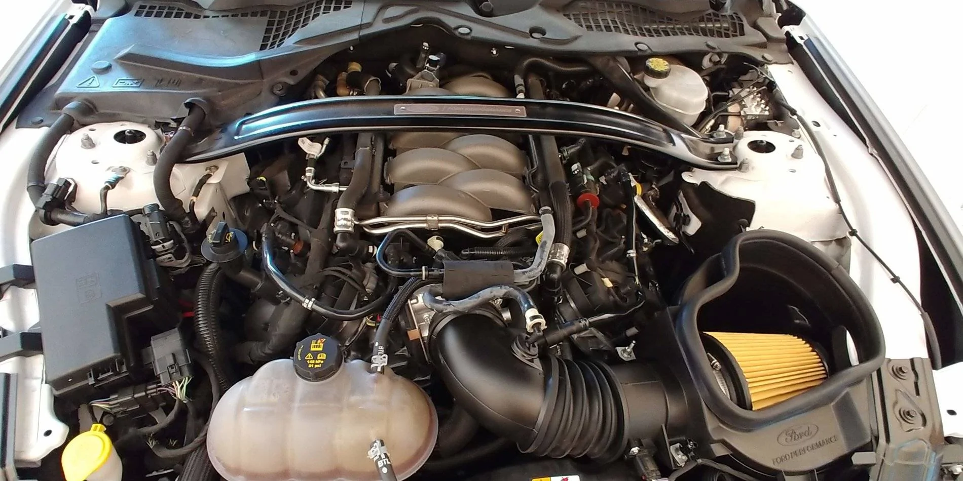

Installed but not yet driven.
The install is pretty easy. I didn't have to go thru the inter fender to remove the sound symposer assembly.
The angle of the throttle body and thus the intake hose wasn't ideal to match the air "box" or the inlet rubber is not flexible enough to make it all line up nicely.
Perhaps after a few heat cycles it will soften or conform to the position.
The pad on the side of the air box and interface to the air box is also a little wonky.
Rerouted brake booster hose and crankcase vent are also not ideal. Note per the instructions you have to modify the plastic engine dress cover.
I had plenty of wire harness length to connect to the MAF. Instructions say you may need to lengthen the harness.
Hood is a little harder to close. Is it flexing a little and increased the gap?
I would like to see others installs to see if they had similar experience/results.
Thanks for your observations about the install. I will take some before and after shots of the hood to see if I have similar issues. Currently mine is lined up pretty well, though I’ve seen people add some washers to help their alignment. Hoping to find time this weekend.

Installed and drove today. Felt much smoother, much more power under acceleration and it's more enthusiastic to kick out the rear on the wet roads I was on. Normal mode feels more like Sport+ now, and Sport+/Track is just an absolute blast. It sounds louder under WOT and I've noticed a lot more rumbling and pops when I put in the clutch or engine brake (pairs nicely with my AWE Touring Catback). The throttle comes on much sooner and definitely feels like a quicker response, more inline with how the throttle cable felt on my 1996 Mustang GT.
Install was simple, I had previously literally yanked the sound symposer out with a delete kit, so it was just a matter of swapping the throttle body, switching out the MAF bracket to the new equipment and bolting everything on. The calibration tool was extremely simple as well, update it via the ProCal4 software on your PC, then plug into the OBDII port and store the stock calibration (it makes you do this, I don't think you can even put the performance calibration on it without storing the stock tune and uploading to Ford Performance Parts cloud servers first). Once the stock calibration is done being written (in addition to the tool taking your VIN for the computer software) after about 30-40 minutes, plug back into your PC. It will have you log in to the account you create on the performanceparts.ford.com website and type in your voucher ID. It will automatically download the performance calibration to the tool. Then, simply plug it back into the OBDII port, and select Programming. The Performance Calibration will be one of the options along with the Stock Calibration.
The ProCal4 tool also has some neat features that I noticed on the user guide, such as the ability to set your tire width and gear ratio settings on your PCM directly from the tool. You can also of course diagnose and clear and DTCs.
I didn't notice any spacing issues with the hood closed, but I can take a better look once I get home from work. I also removed the engine cover the same day I bought the car, so that was a non-factor for me.
EDIT: I took another look today at the front of the car with the hood closed, I didn't notice the corner with the intake bulging due to spacing.
