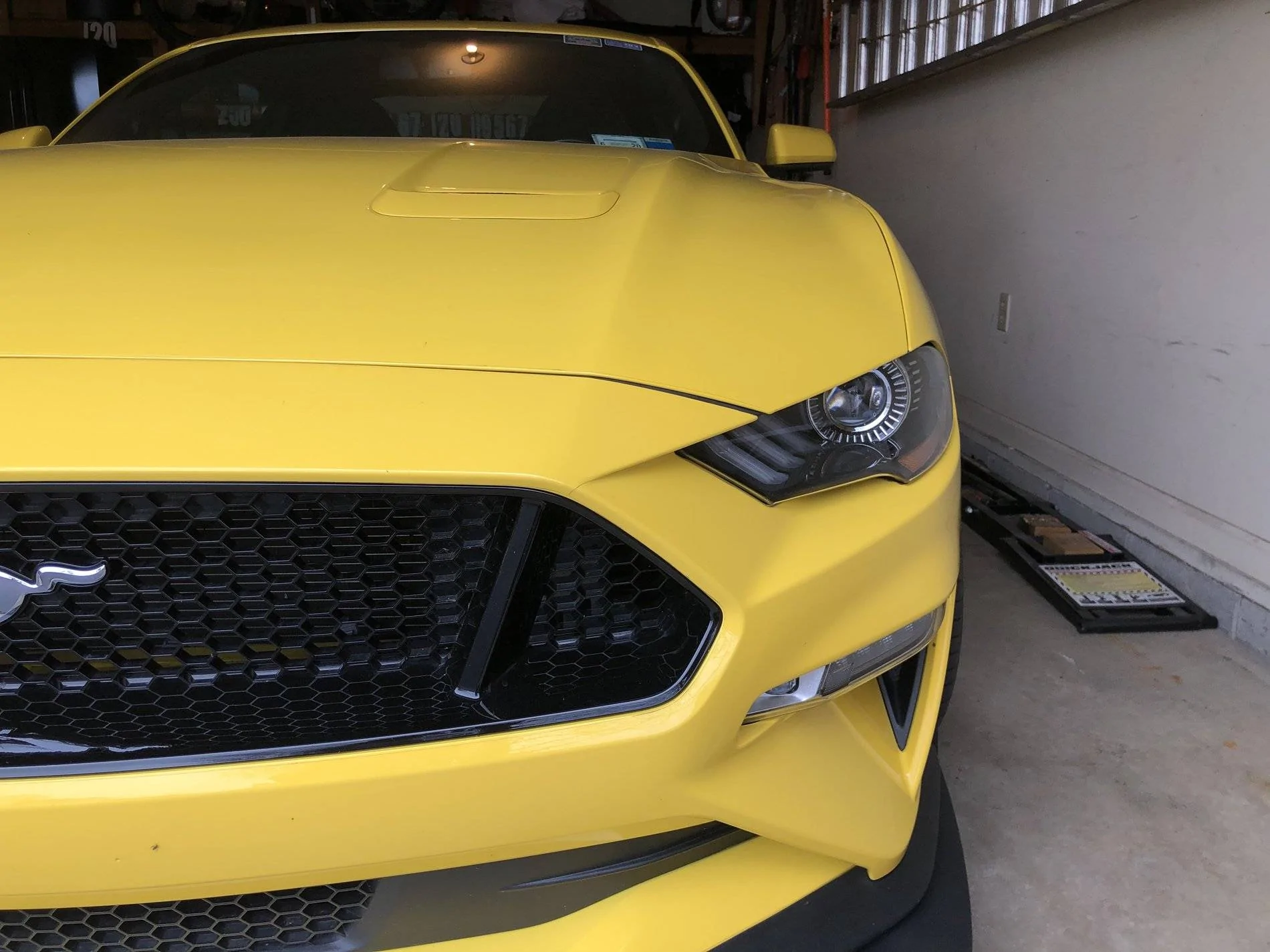

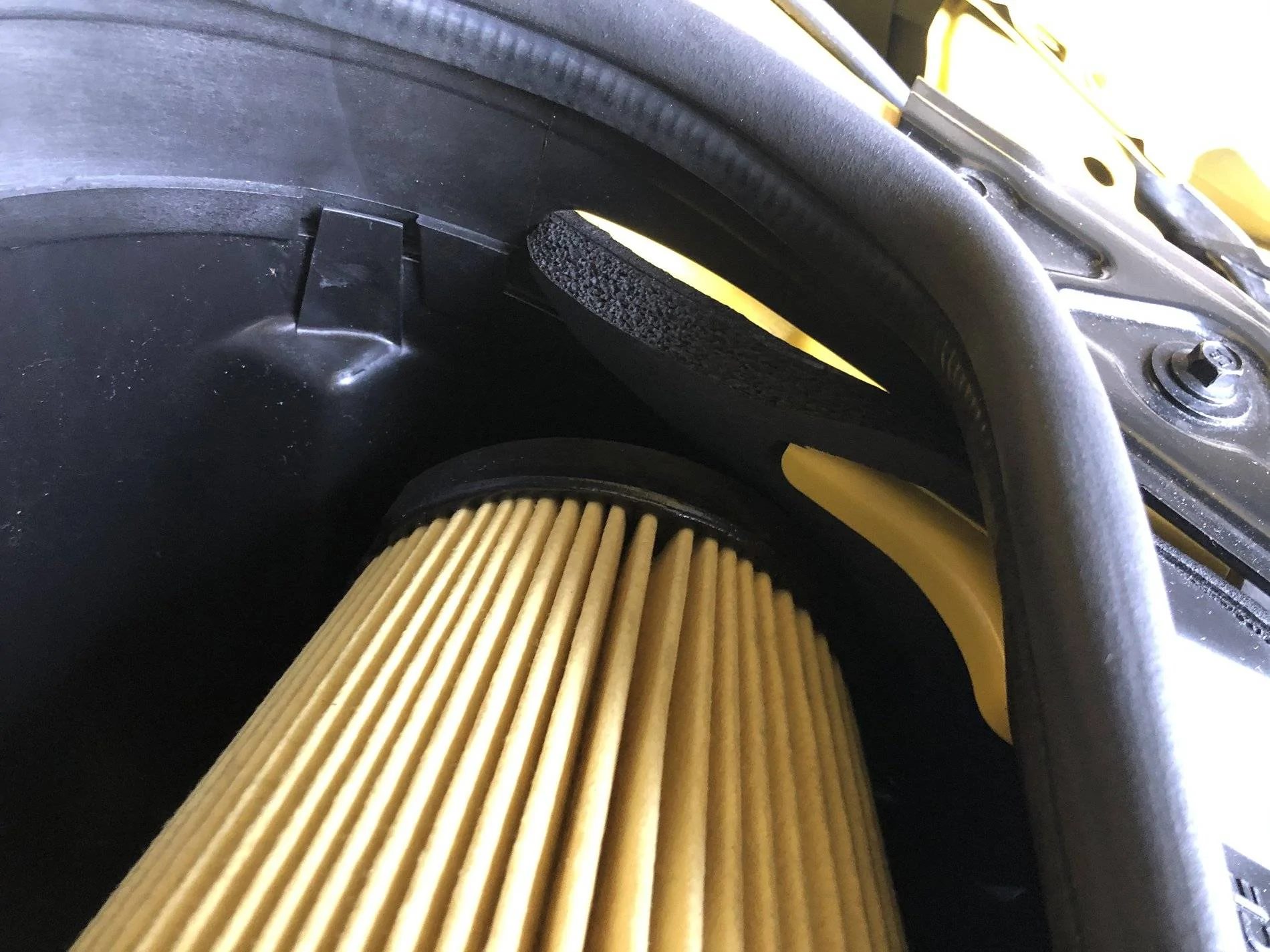

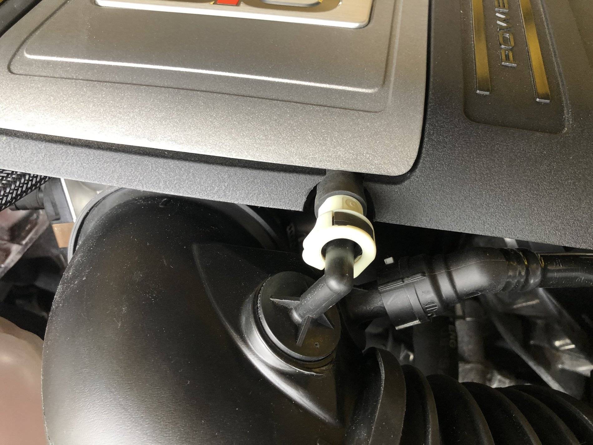

Installed but not yet driven.
The install is pretty easy. I didn't have to go thru the inter fender to remove the sound symposer assembly.
The angle of the throttle body and thus the intake hose wasn't ideal to match the air "box" or the inlet rubber is not flexible enough to make it all line up nicely.
Perhaps after a few heat cycles it will soften or conform to the position.
The pad on the side of the air box and interface to the air box is also a little wonky.
Rerouted brake booster hose and crankcase vent are also not ideal. Note per the instructions you have to modify the plastic engine dress cover.
I had plenty of wire harness length to connect to the MAF. Instructions say you may need to lengthen the harness.
Hood is a little harder to close. Is it flexing a little and increased the gap?
I would like to see others installs to see if they had similar experience/results.
