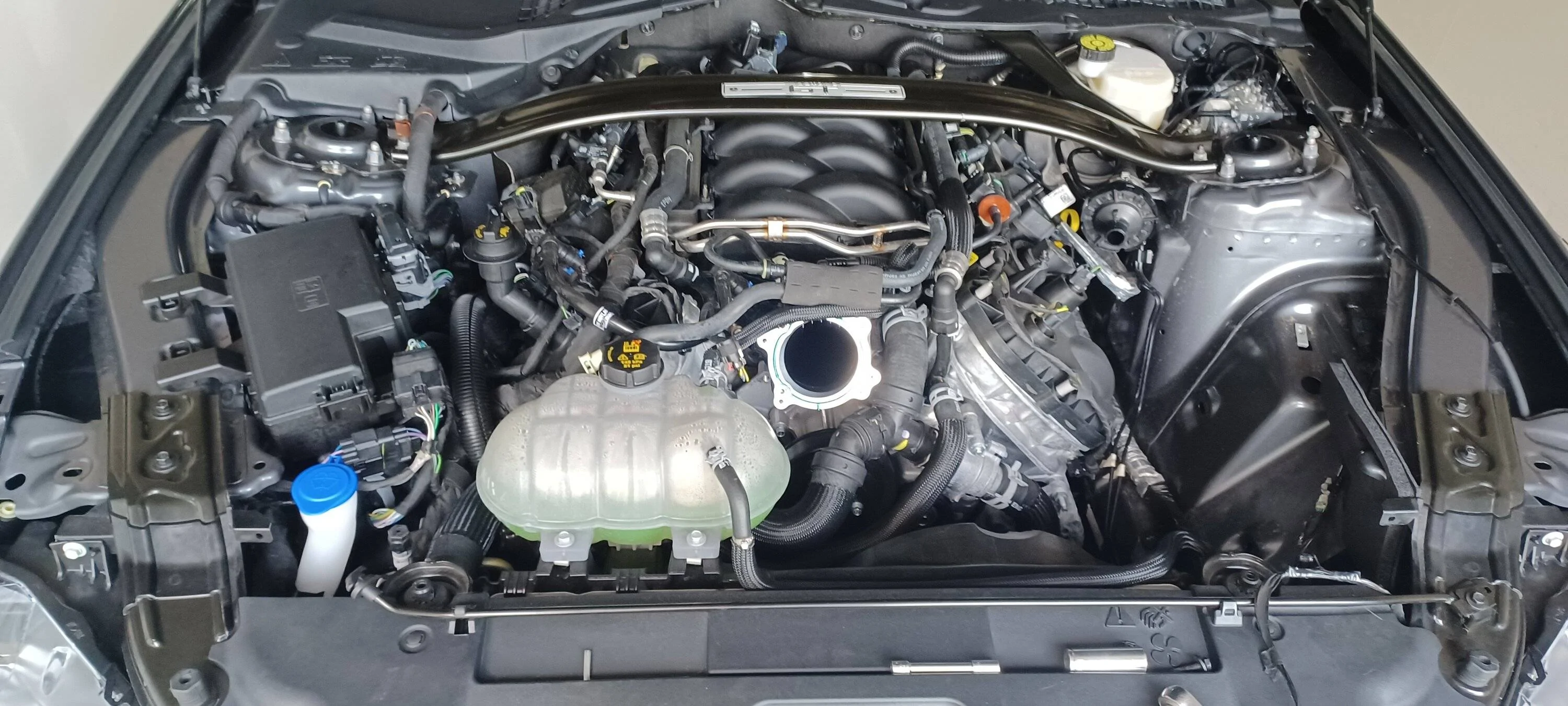

Done. Took two hours, had to run back and check a video on the sound tube, and check the TB plate mounting (which way was up). One the stock intake, the little rubber notch on the gasket is north, on the new spacer, it is south when mounted. Also, on the sound tube, get everything unhooked, and do not mess with the nut on the firewall. Just yank twice and it pops right off, and then install the plug.
Connected the handheld, selected calibration, and performance cal, and it loaded pretty quickly. Took it for a 20-minute ride to warm it up and give it some mixed driving, seems to run perfectly.
