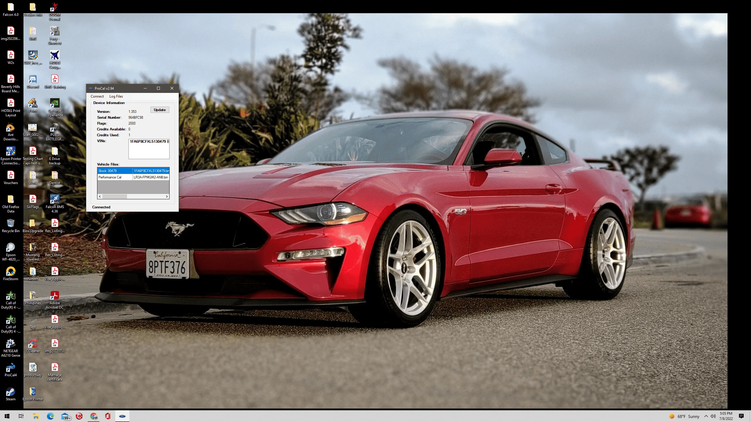

You have to load the tune as soon as the hardware is changed out. At no time should the car run with the stock tune and new hardware. It will throw codes. So make arrangements with your installer so you can sit in the car when they are finished, and upload the tune before starting it.
And FYI you have to download the stock tune into the Procal before you can download the Calibration Tune into the Procal from Ford Performance. The stock tune gets uploaded (backed up) to their servers and only after that are you able to download the new tune to the Procal. You will end up with a stock tune file and a calibration tune on your Procal Device. Take it with you to your installer.

I did the ProCal setup and configuration myself, then brought it to the dealership ready to install and load the tune. The Ford tech thanked me because it saved him a bunch of time/doing computer stuff.
This includes plugging the device into the car to download the stock tune, then going back to the PC and uploading it to Ford & downloading the new tune so it was ready to go on the ProCal device.
