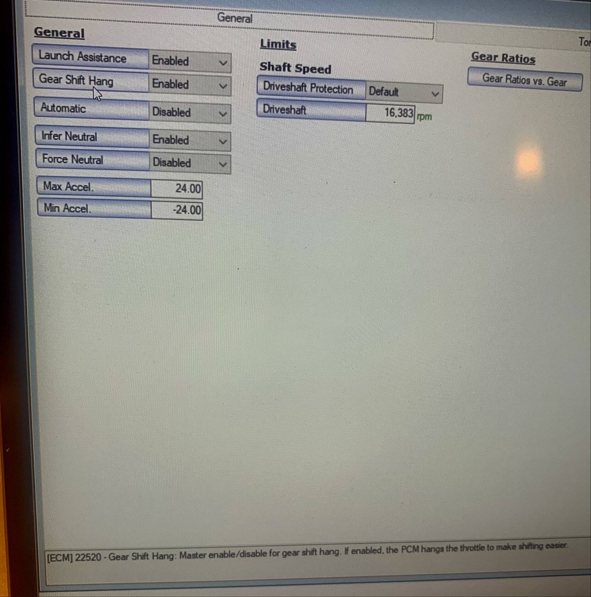

++Also, very pleasantly (for me) is the slight crackling and popping on some upshifts at higher RPM, AND also at idle revving to higher RPMs. I have the OEM active and it's all stock, resonator is still on. (I plan to be putting on the Corsa Active later this summer) but, even before that, this was a real nice surprise.
++ Shifting feels better. Gate engagement seems smoother, less notchy. High RPM 1-2 shifts are smoother. My experience echos what someone else has said, and I have no idea how to qualify how - perhaps it's how the power is delivered now, which is smoother than before the FP Cal.
Great post and photos, would have been useful for me a few months back.
Also, for your exhaust solution, I'd recommend you stay with the factory active exhaust but do a resonator delete into an H-Pipe. Cheap option (H-Pipe is $200-300 CAD), keeps the perfectly fine oem valve functionality, gives the car the aftermarket sound you're after, and you still get the overrun crackling / burbles until warm up and those upshift bangs.
I'd say this video is a pretty good representation of tone, but videos obviously reduce volume perception:
