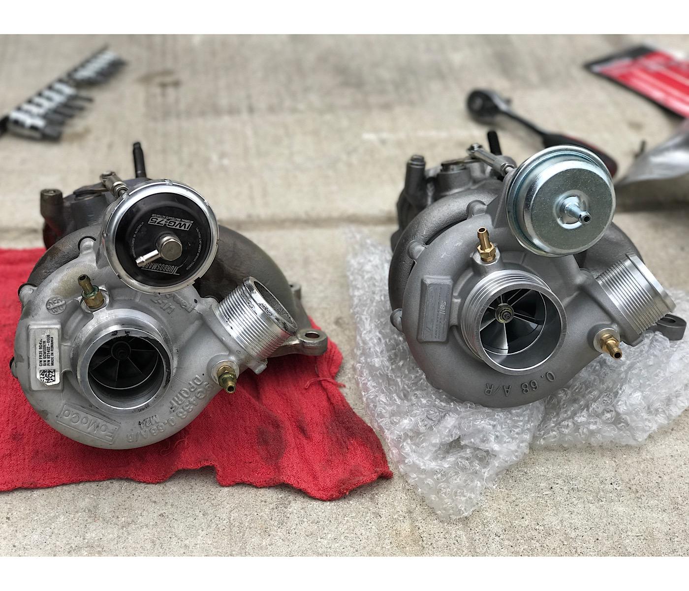

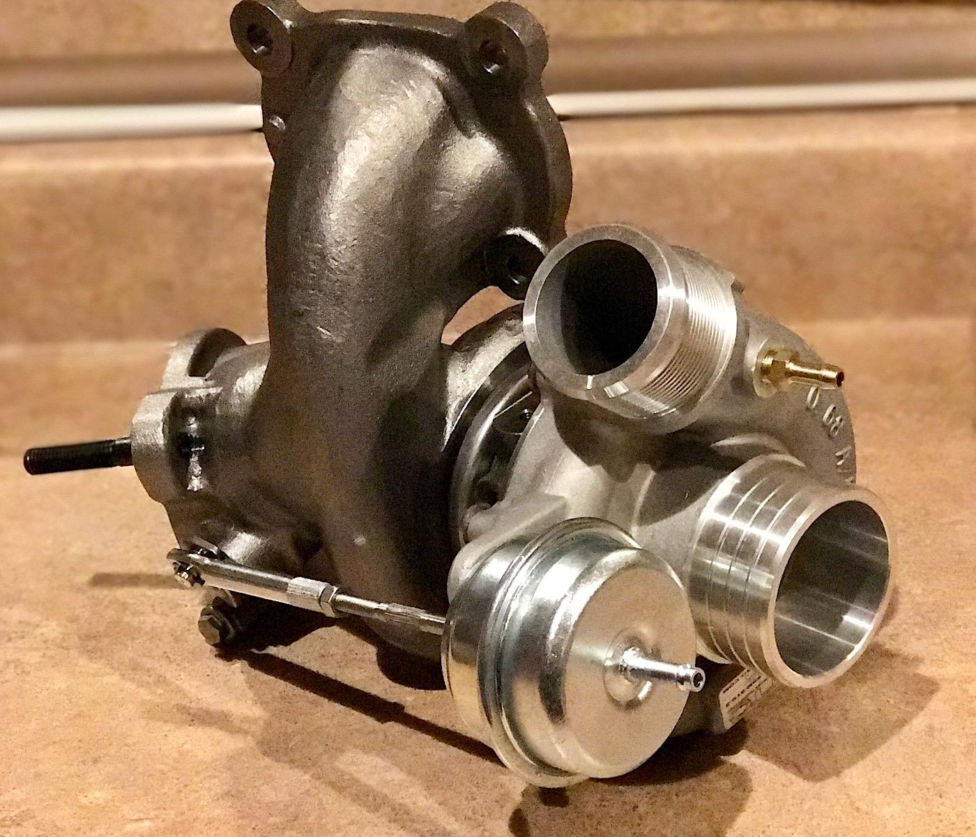

    So recently I just installed Vargas's stage 2 twinscroll turbo. Install took longer than I would've like but it was my first turbo swap so lots of fun learning .
    Here's the turbo fresh out the box with that oh so lovely corrosion inhibiting oil smell. :p
    Old turbo paper weight on left and new baby child turbo on right , old turbo still had my wastegate actuator from turbosmart, but I swapped it over of course. Pretty cool huh

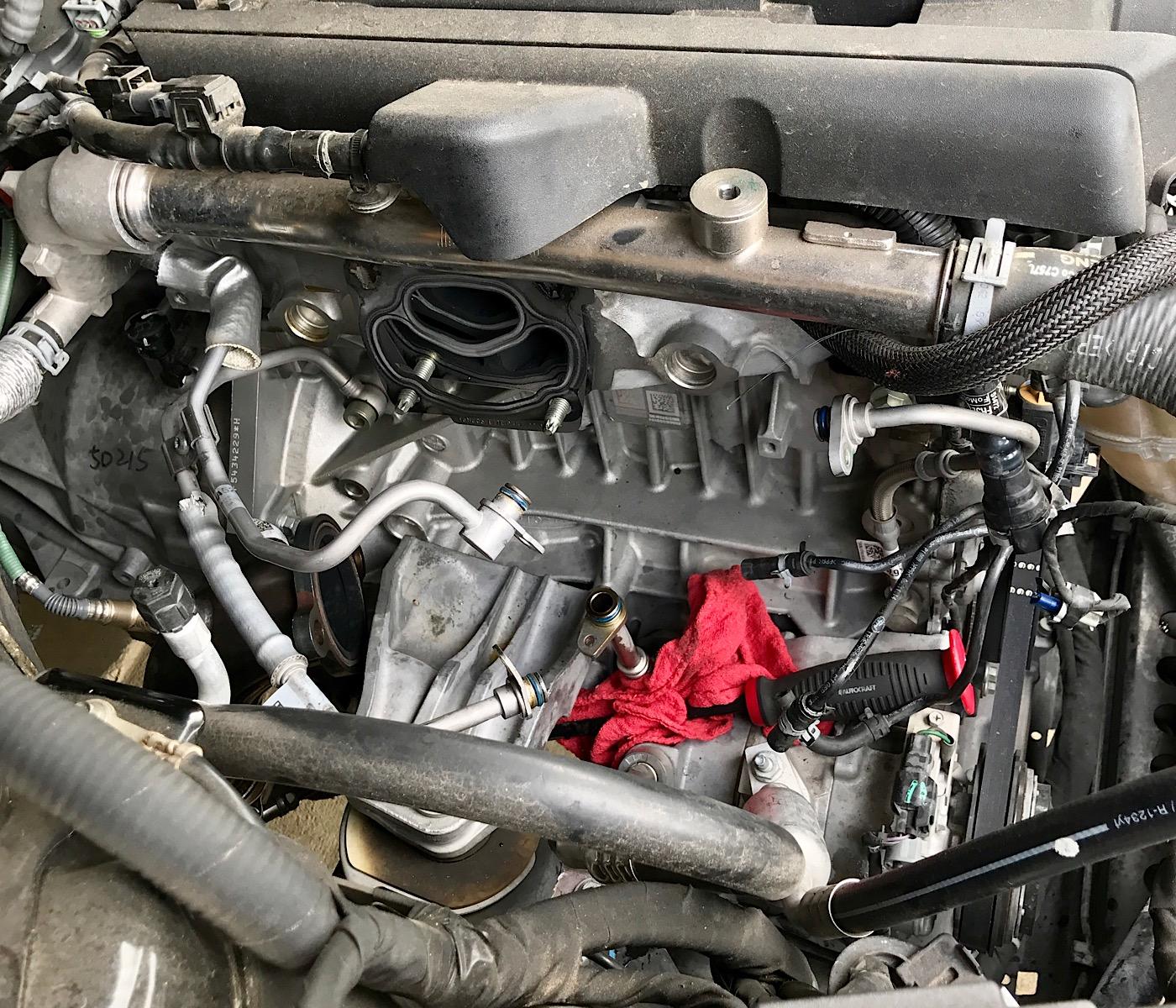

    Those coolant lines were a pain to get out and to get back in once I replaced the o-rings :frusty:
    Luckily no leaks after I get the car started so whooo!
    After everything was put back together and the car was started, I had no idea how to bleed the air out of the cooling system.....I had the cap off forever waiting for the fluid level to go back down after putting back what I drained. Well apparently he internet says our overflow tank bleed themselves so I thought that was pretty cool.

    nice! the oil drain line is the most difficult for me to deal with idk how people can screw it back on to the turbo from that angle...

    Ya I forgot to mention that also haha that damn screw fell atleast 15 times before getting it to go in. I ended using my phone's front facing camera to help me see if the hole was aligned properly.
