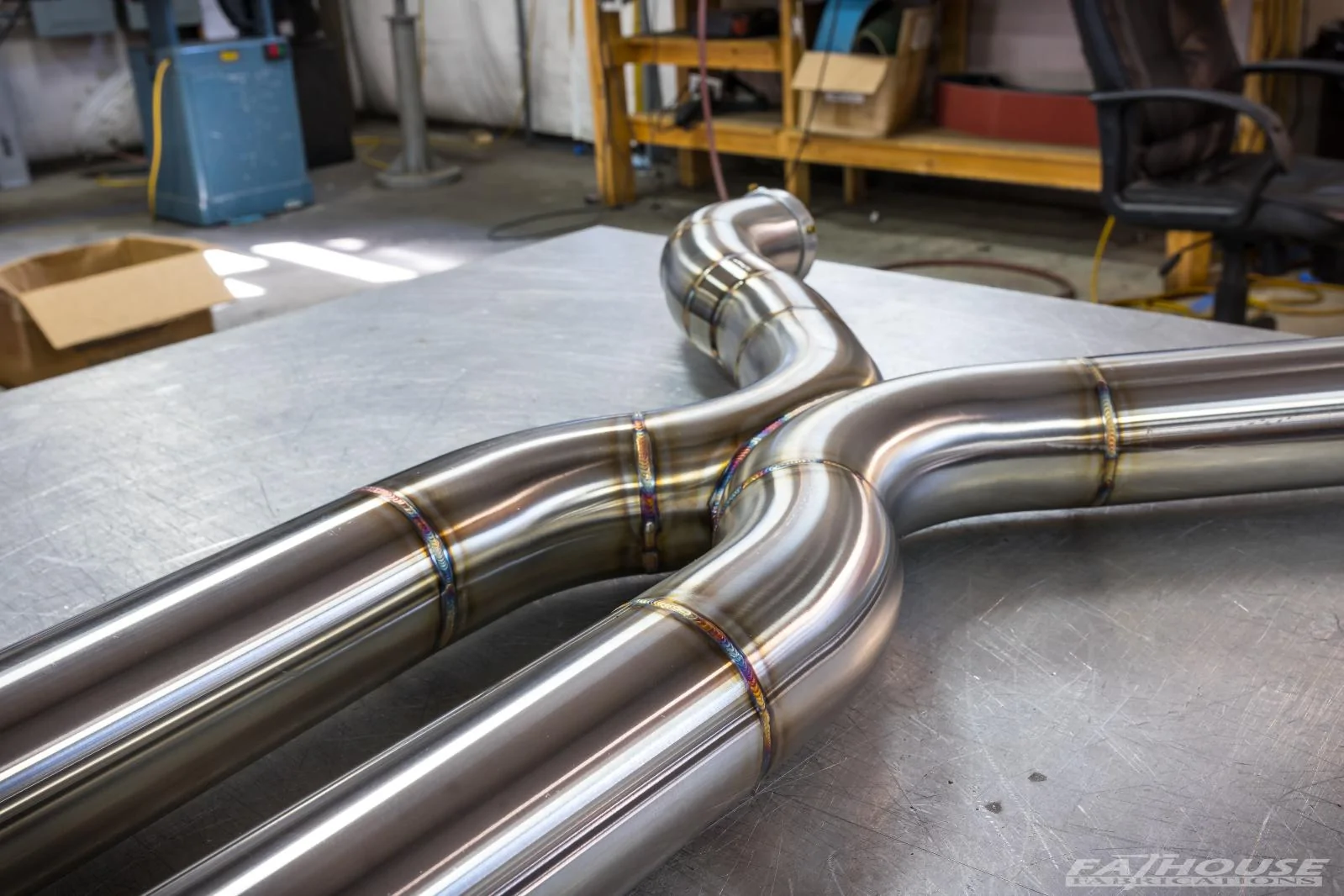

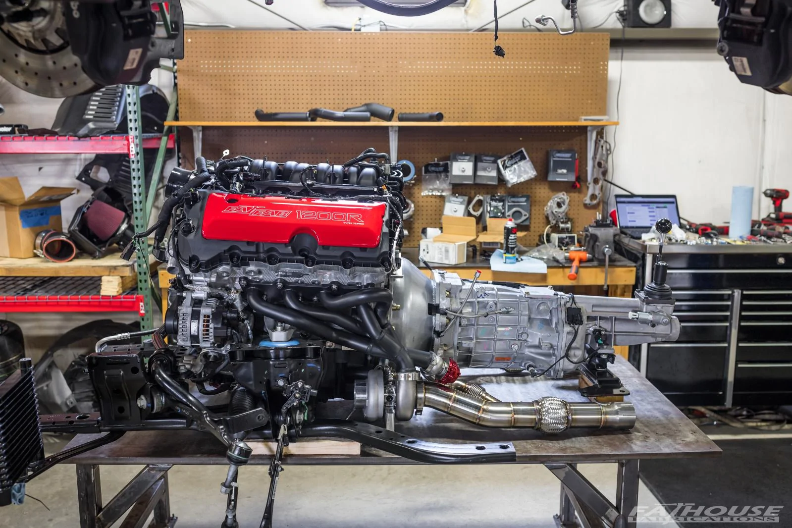

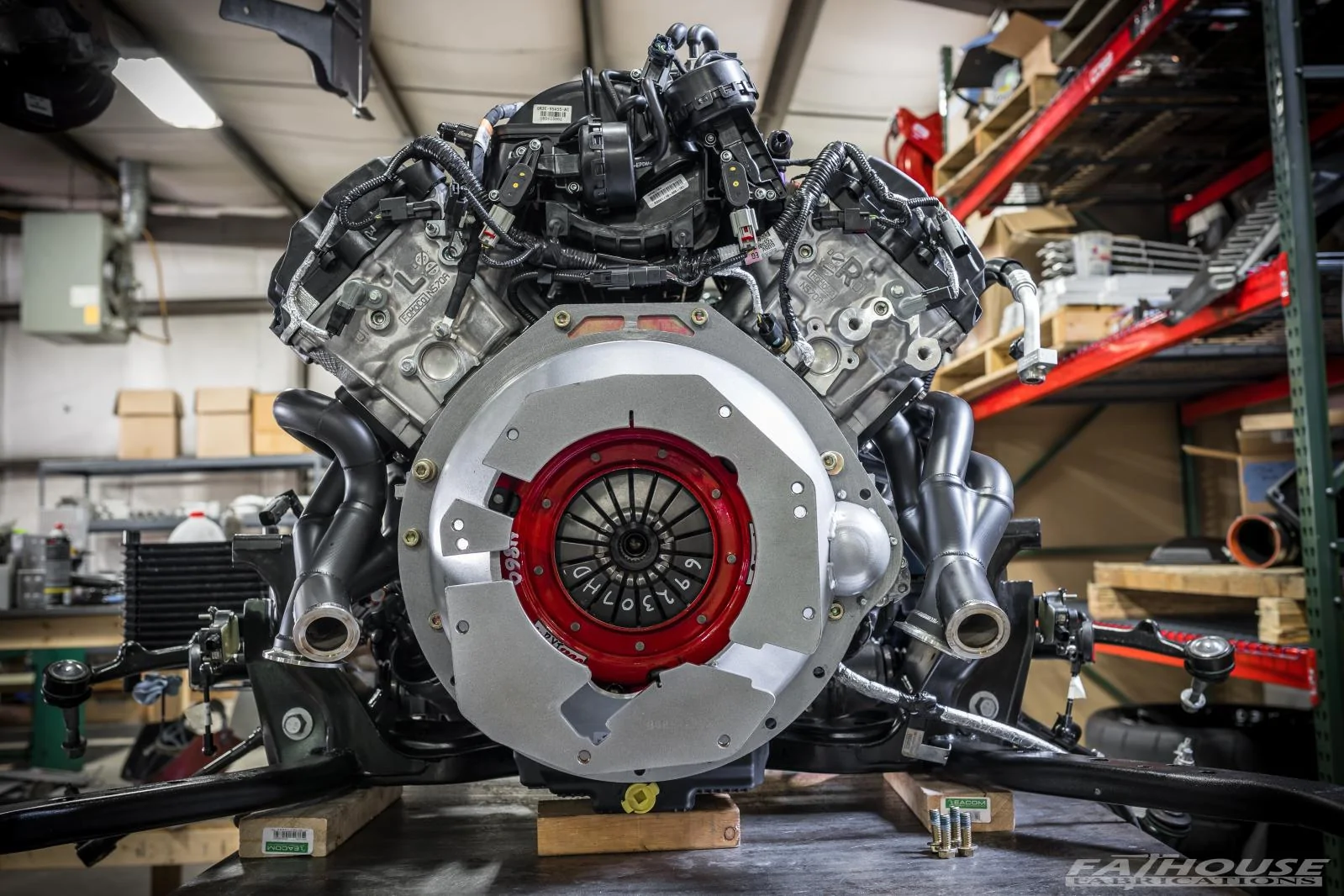

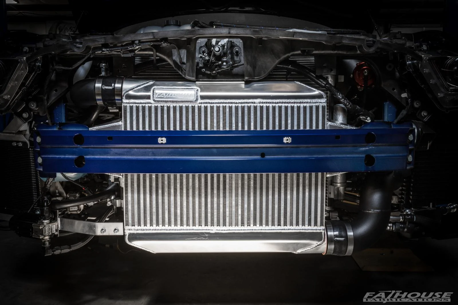

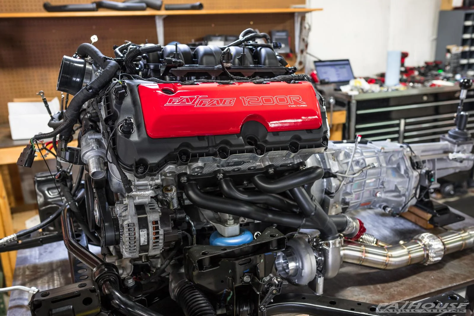

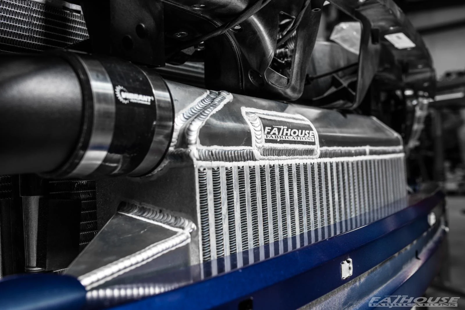

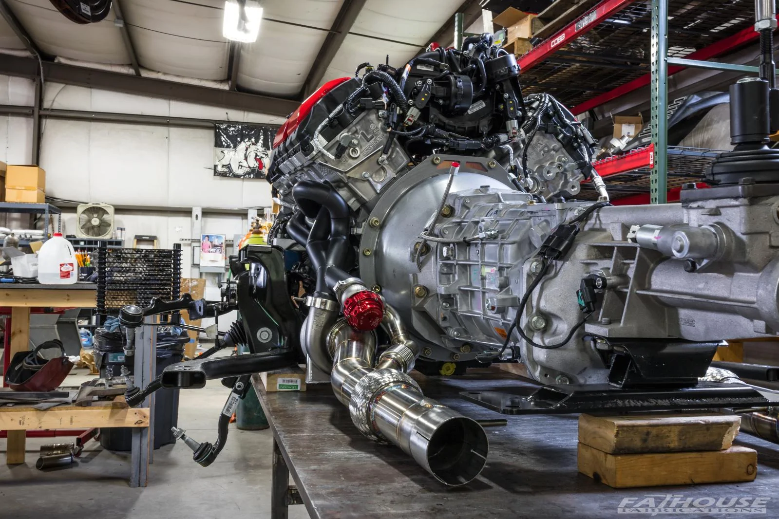

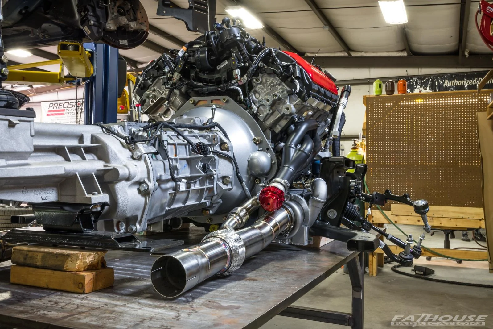

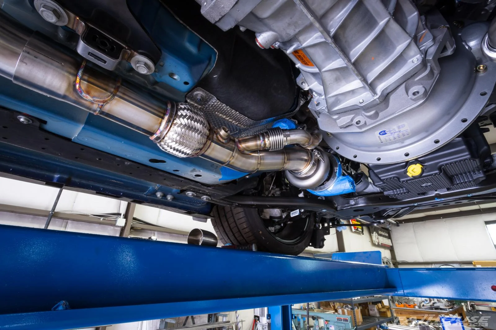

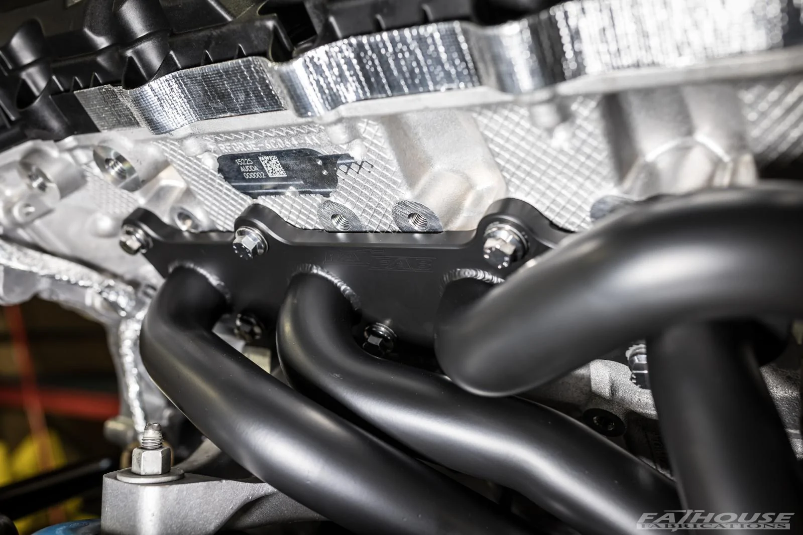

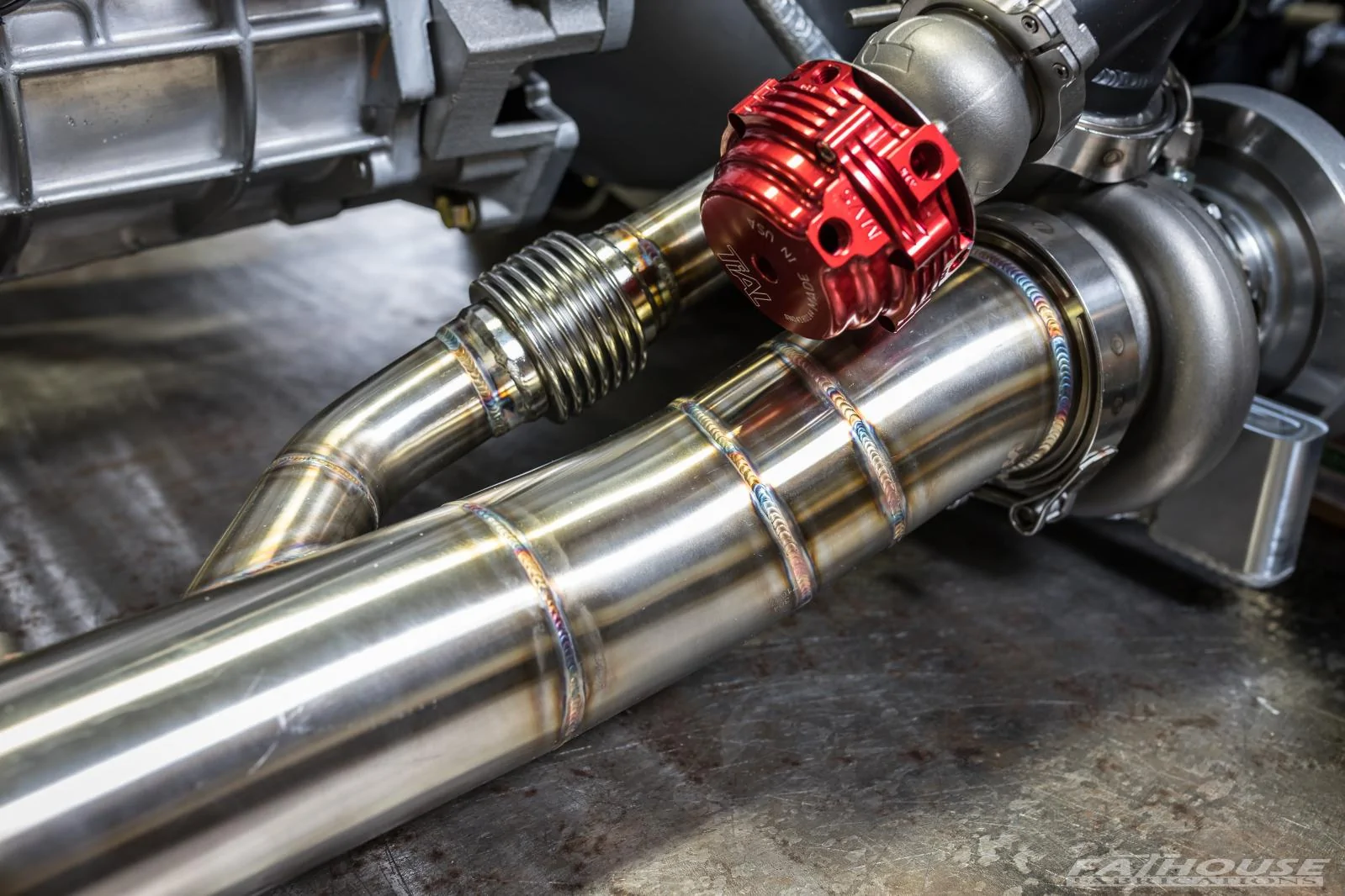

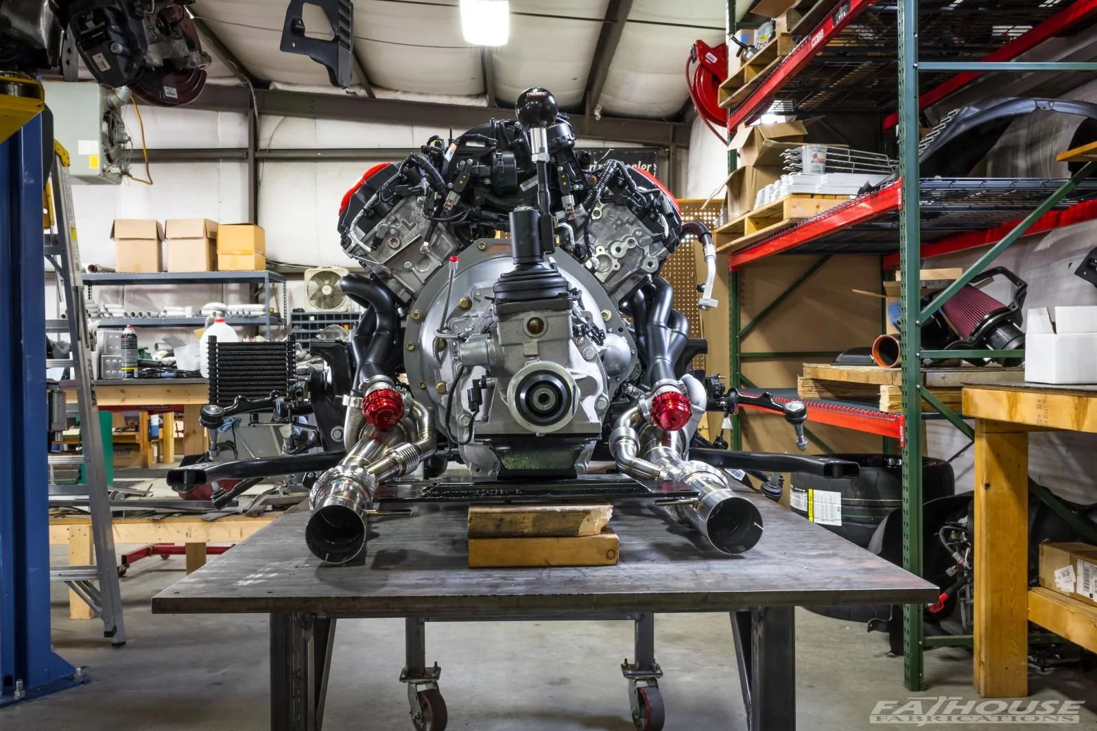

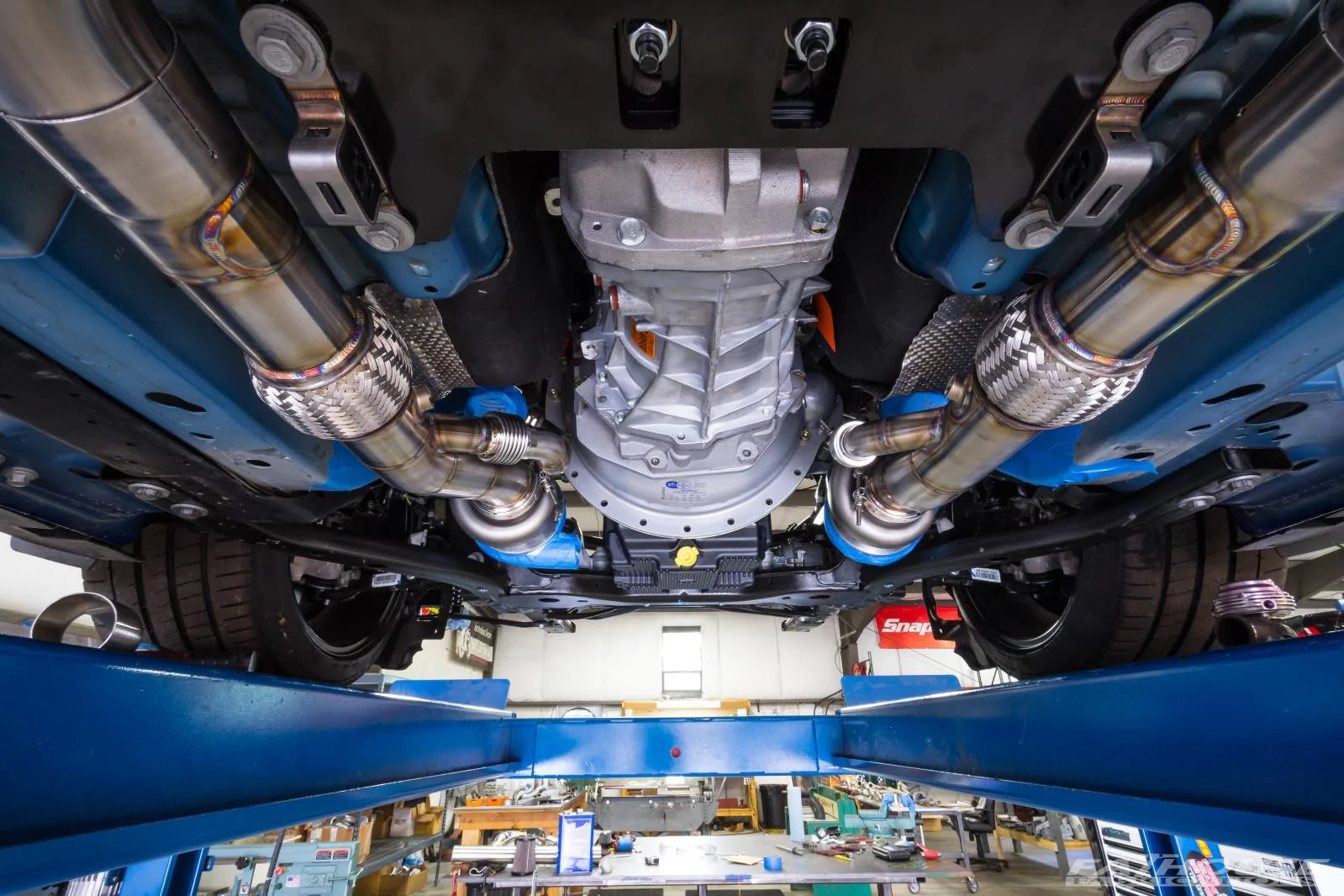

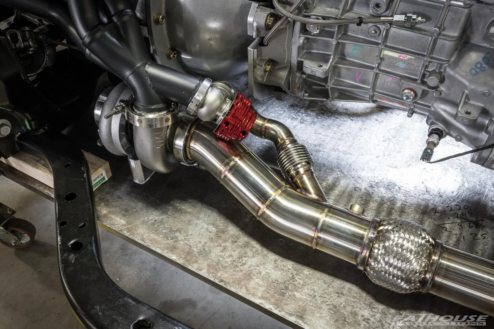

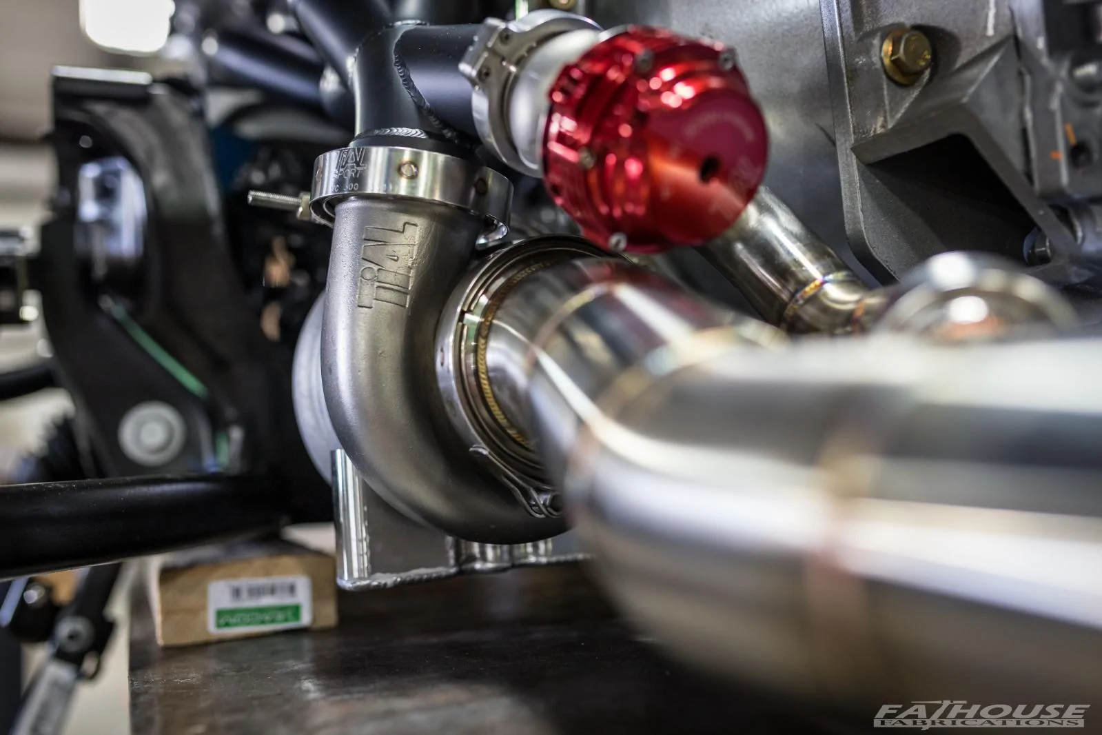

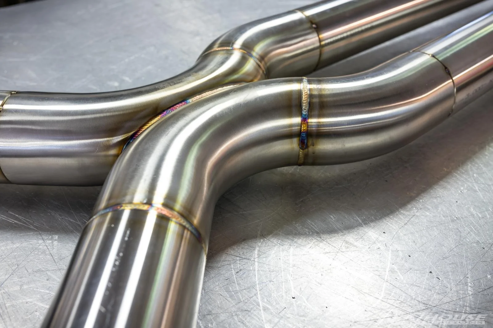

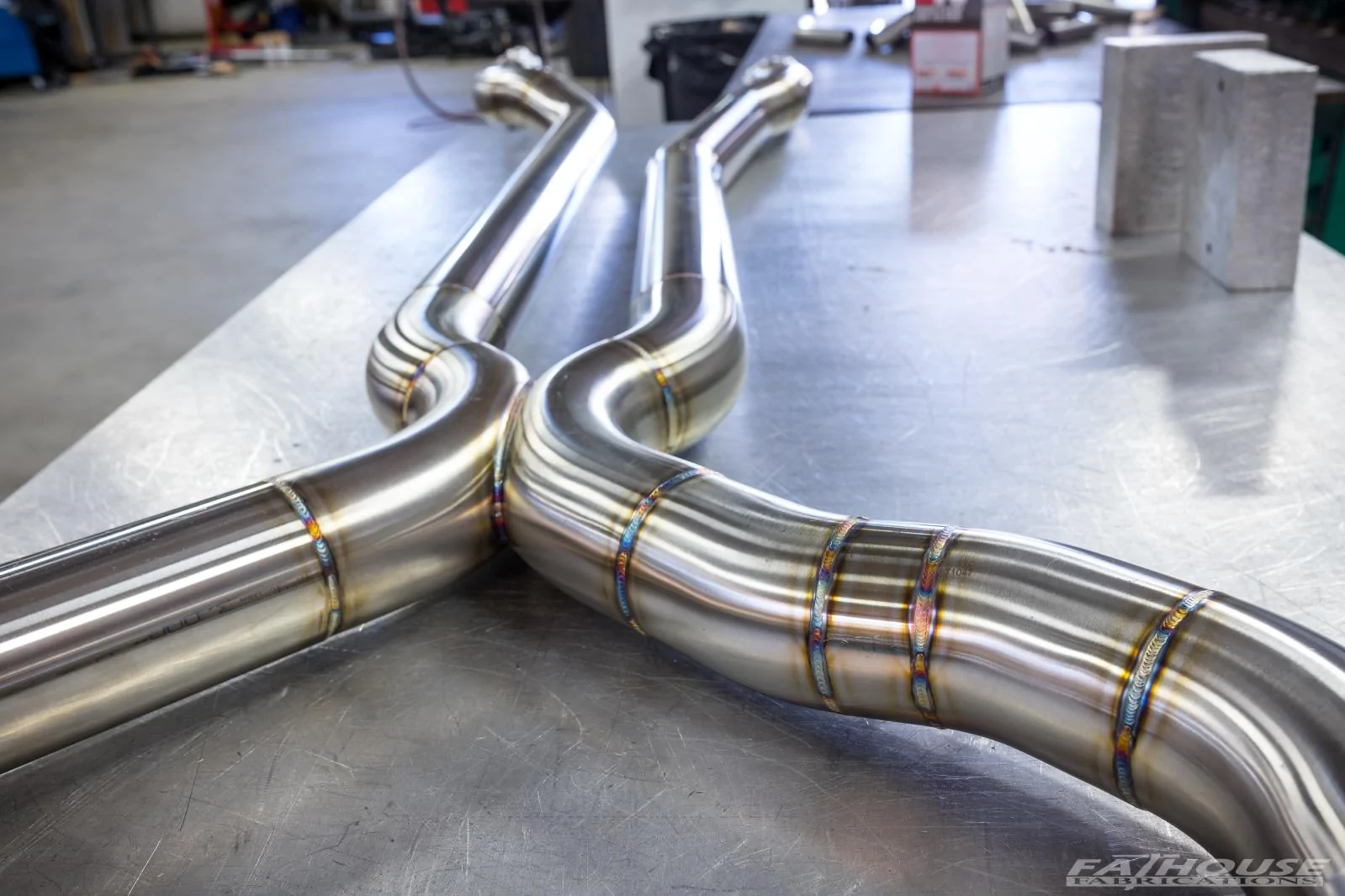

    We just finished up another twin turbo GT350 build here at the shop. This particular car received our 1200R package along with a T56 Magnum transmission swap. On 23 psi the car made a ground shaking 1328 whp and 967 tq!
    Below you can find the 1200R package contents as well as the dyno video and photos of the build.
    Enjoy!
    The 1200R Package Comes Standard With:

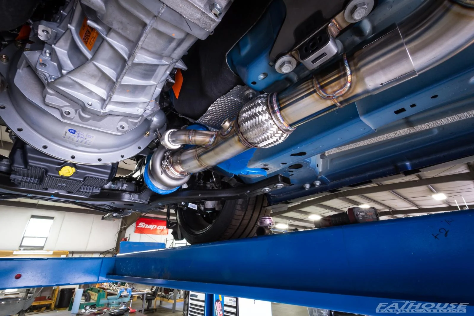

    • Hand built stainless steel turbo headers
    • Full custom stainless steel exhaust, no mufflers (aggressive sound)
    • Precision tig welding throughout
    • Xona Rotor dual ball bearing turbochargers
    • Heat coating and turbo blankets
    • Motec M150 ECU Package
    • Electronic boost control with multiple settings

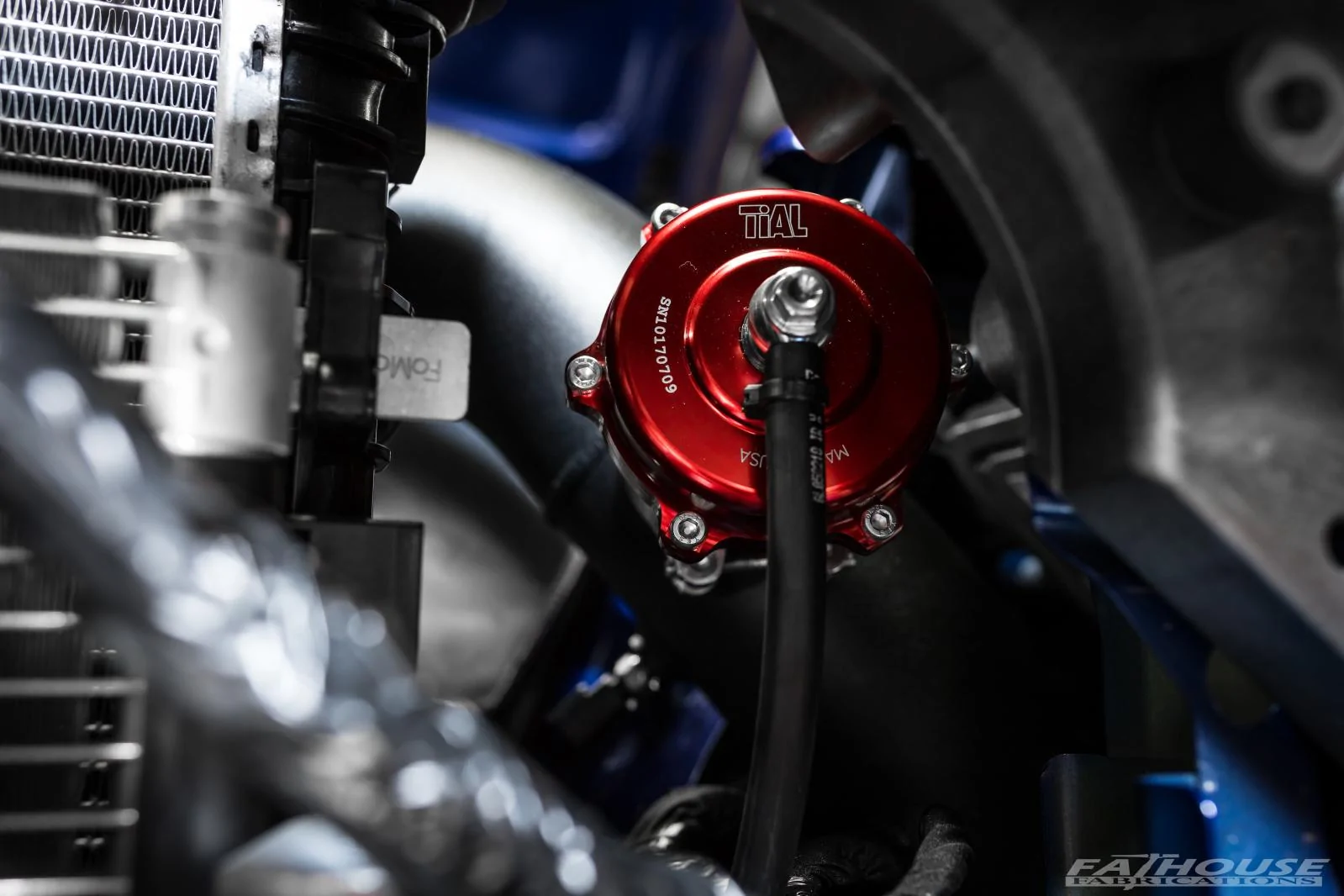

    • Tial MVR recirculated wastegates (No loud exhaust dumps all you hear is sweet turbo sound)
    • Tial Q blow off valve

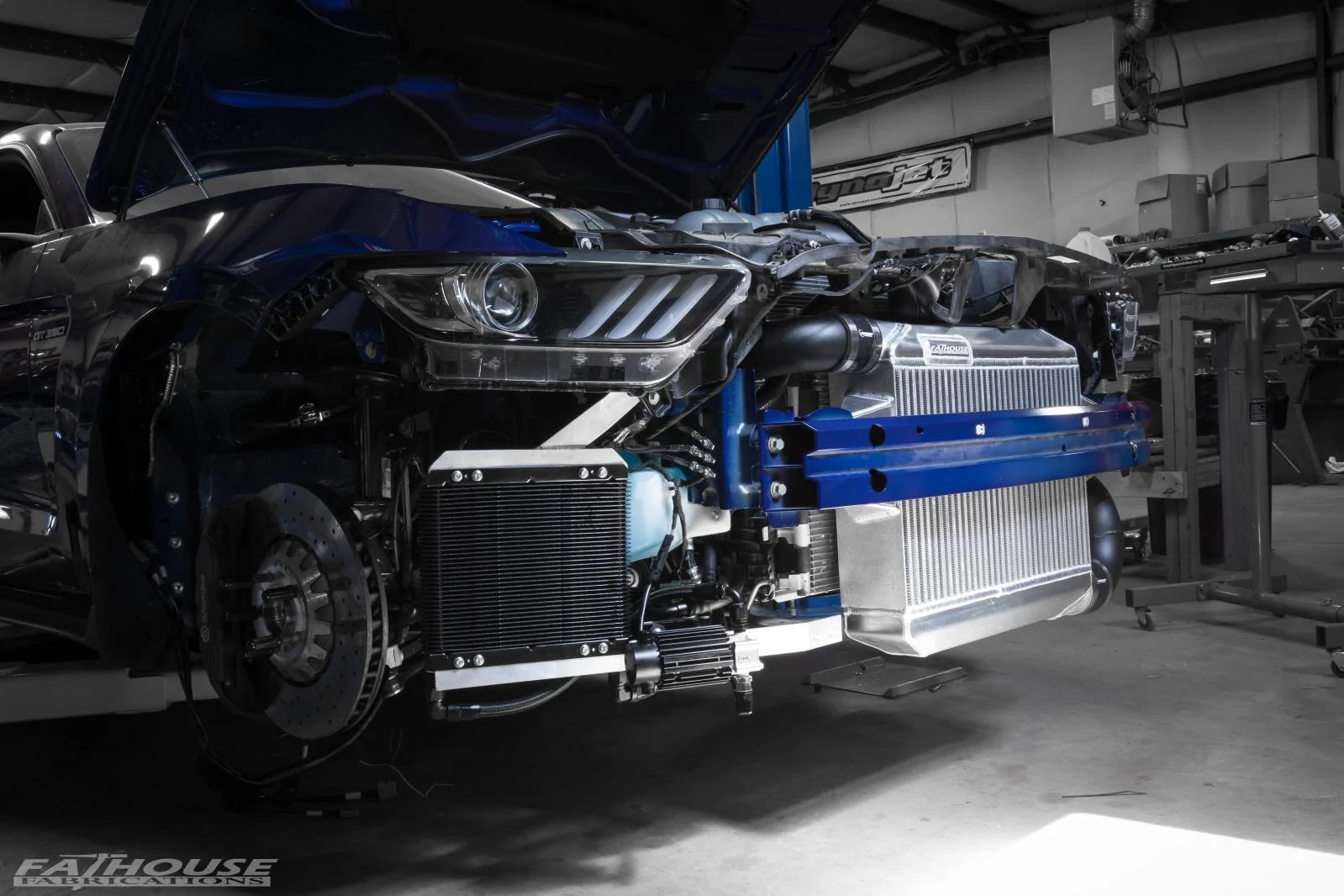

    • 4.5″ Thick Intercooler (symmetrical design)
    • Coated intercooler piping (zero ground clearance loss)
    • Custom Air Filters
    • Purpose built scavenge system
    • Catch can system with lines and fittings
    • Injector Dynamics Injectors
    • Return style fuel system
    • Upgraded twin disc clutch
    • Triple fuel pump upgrade
    • Forged engine package
    • Upgraded sleeves
    • Billet Oil Pump and Crank Sprocket gears
    • Carbon fiber driveshaft
    • Level 5 axles
    • Drag radial tires
    • Suspension upgrade
    • Professional installation
    • Custom dyno tuning, true flex fuel setup
    • Dyno chart printouts
    • Professional video and photos of your build

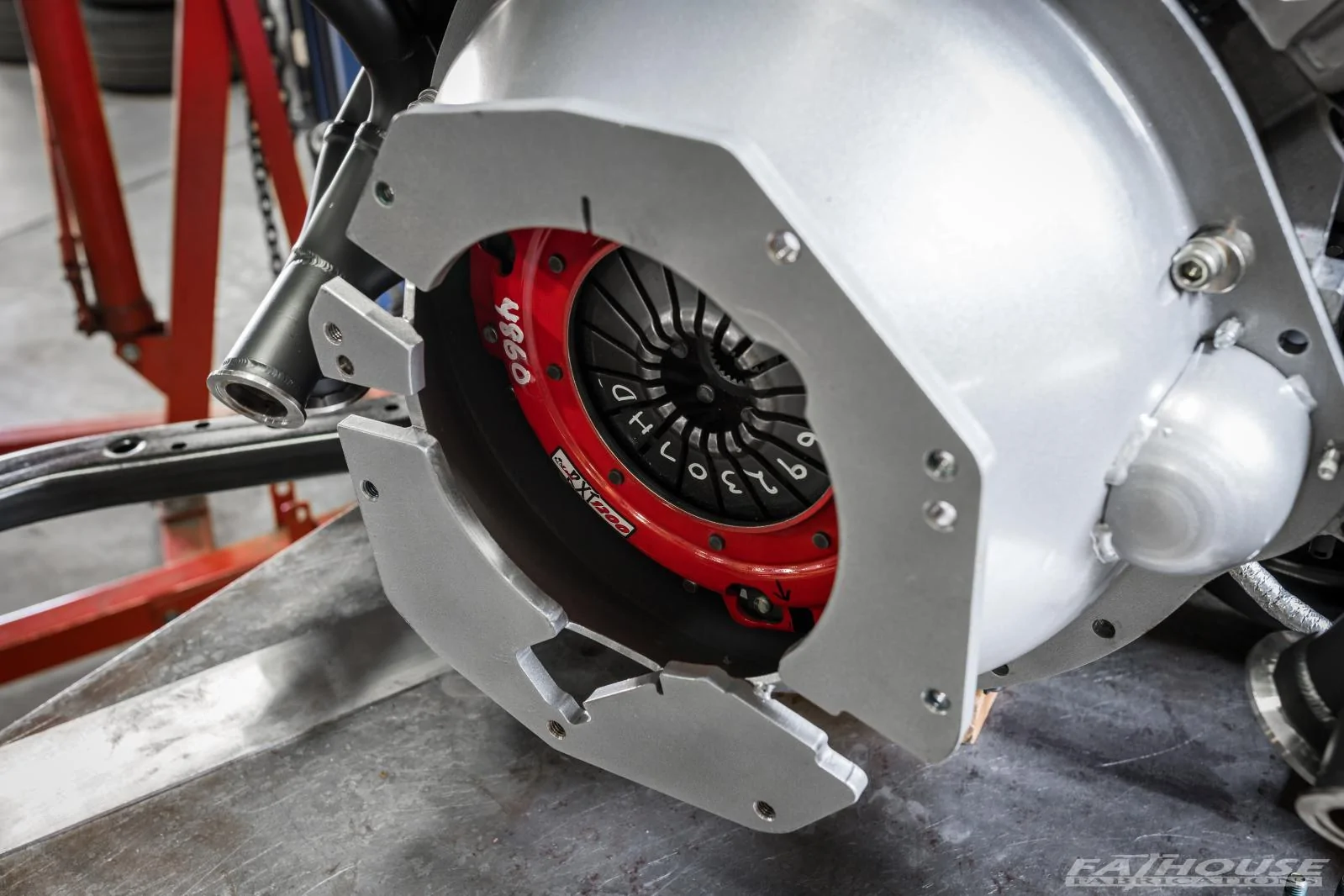

    Beautiful work. You guys haven't had any of the issues with the McLeod clutch as others have mentioned?

    Amazing but isnt that tranny rated for 700ft lbs torque ??

    The only issue we have ever had is the clutch not releasing early on, that seems to have been resolved. However we are using Mantic Triples in all 1200R cars now.
    They rate the T56 Magnum in 6th gear so it will handle much more that that in lower gears. We have been pushing over 1100 ft. lbs. on a T56 magnum in my car for a while now. Its usually good for about 30 full power passes before it starts breaking input shafts.

    Does your oil system dump back into the oil pan or is it completely independent of the engine ?
  20. ben@fatfab
    [email protected] Well-Known Member
    Gold Sponsor
    Vehicle(s):
    2011 Mustang GT Turbo
    Joined:
    Nov 9, 2015
    Location:
    Indianapolis, IN
    Posts:
    240
    Likes Received:
    207
    0   0   0
    The 1200R does come with the MoTeC system. Im not sure what $15k package you are referring to, we do offer supercharger packages as well if someone would like a basic Whipple install we do those too.
    Our oil scavenge system returns to the front cover, we do not modify your oil pan.
