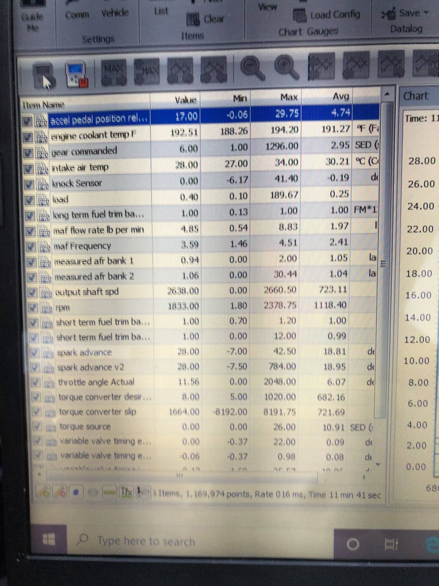

False knock???

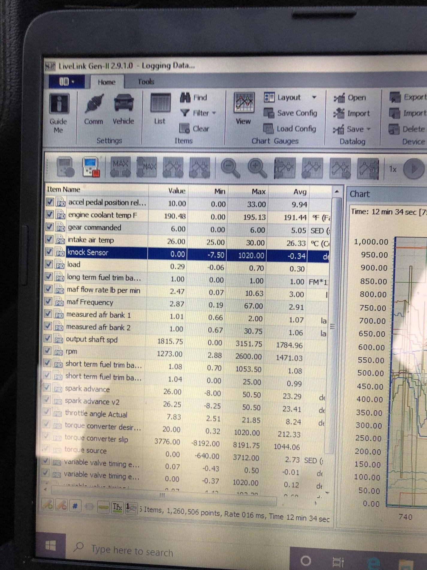

What tuning device were you using? I had some false knock issues with an sct and while datalogging constantly to figure it out I had my knock hit in the 2000s. Lund told me those readings were a glitch because my sensors max out at 10. I ended up finding a knick in my cable. Glad it worked out for you.
I believe he was using SCT as well
Yep sct like yours. Just like yours, I was told no way it can go past 10. Been healthy for 2 years since then. I beat and use my supercharger every time I can drive her 4 to 8 times a month.
