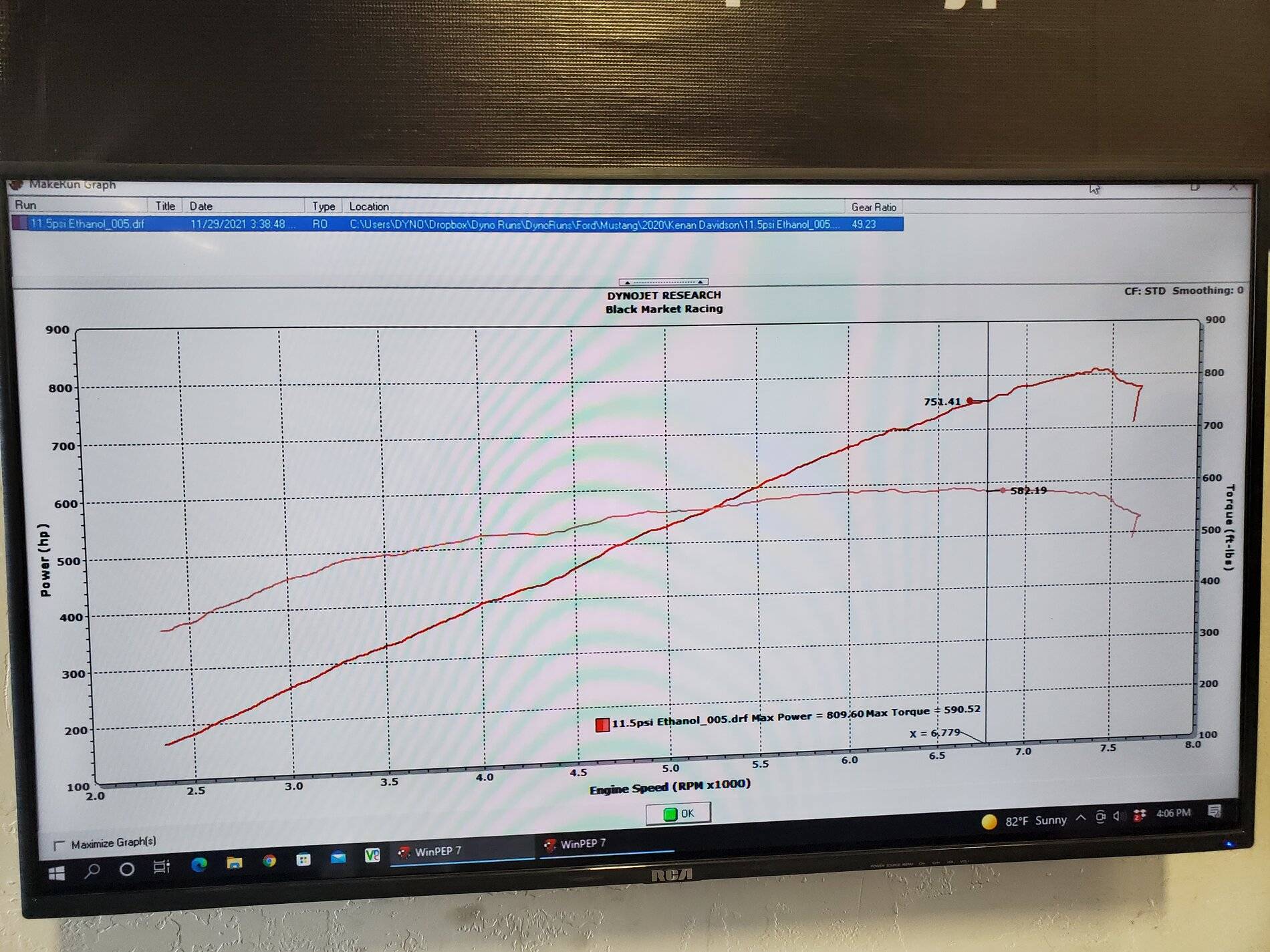

Ok this makes a lot more sense. You're running like a 12 psi pulley so you have more boost down low but the waste gate limits your peak boost so you don't overboost the engine
