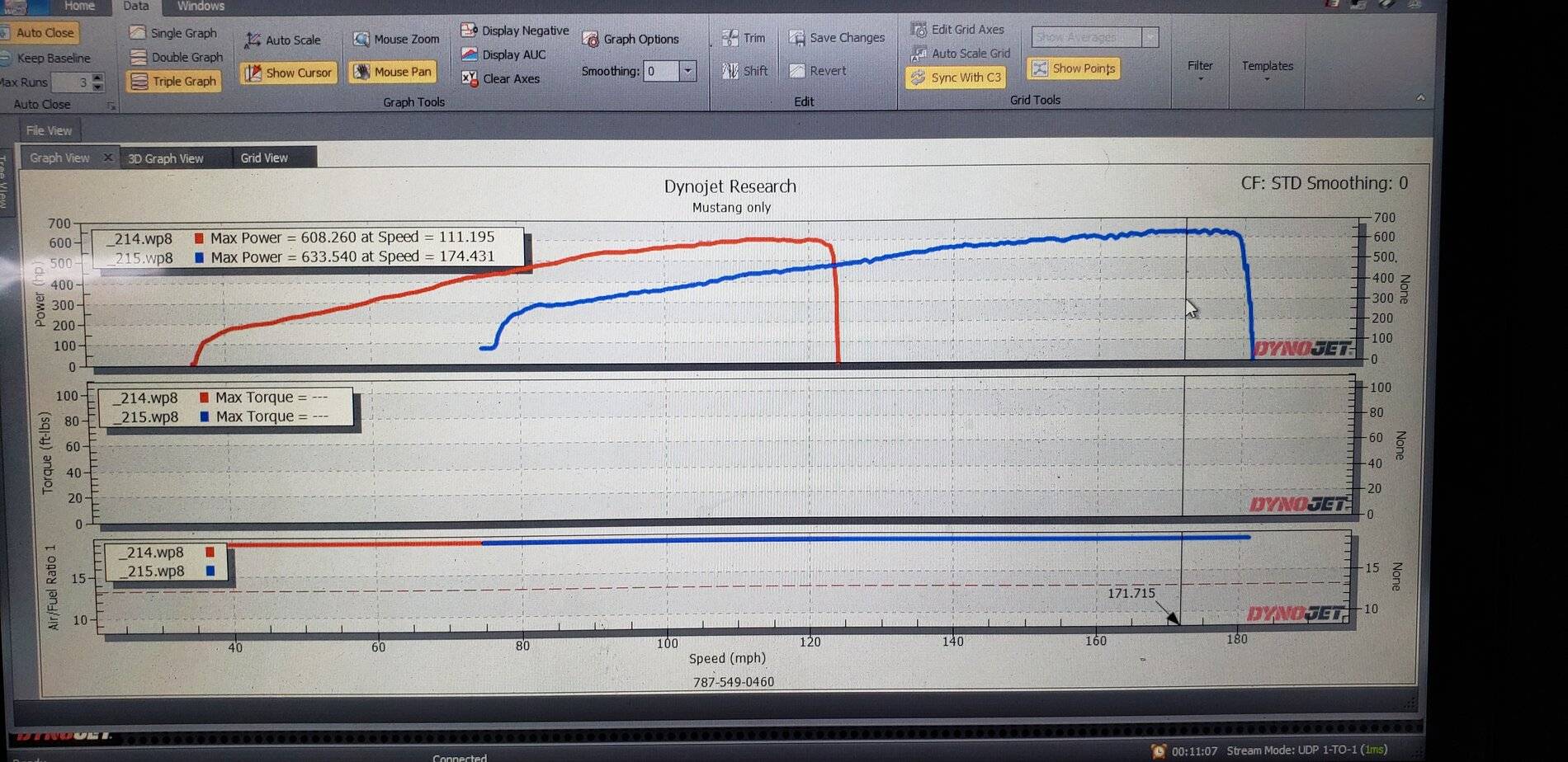

633 whp in 7th gear on 6.5 pulley, stock cats and manifold. Only other performance mod is x pipe. Very, very happy. Not bad for the smallest G2 unit on the largest pulley.
Unfortunately they had an issue with the rpm reader so couldnt see tq and took the reading by mph only.

How does the bottom end feel compared to pre supercharger ?
Feels like stock till about 2500-3000, after 3k it starts building boost and pulls harder than stock. Keeps building power as you go up and goes into beast mode above 5k.

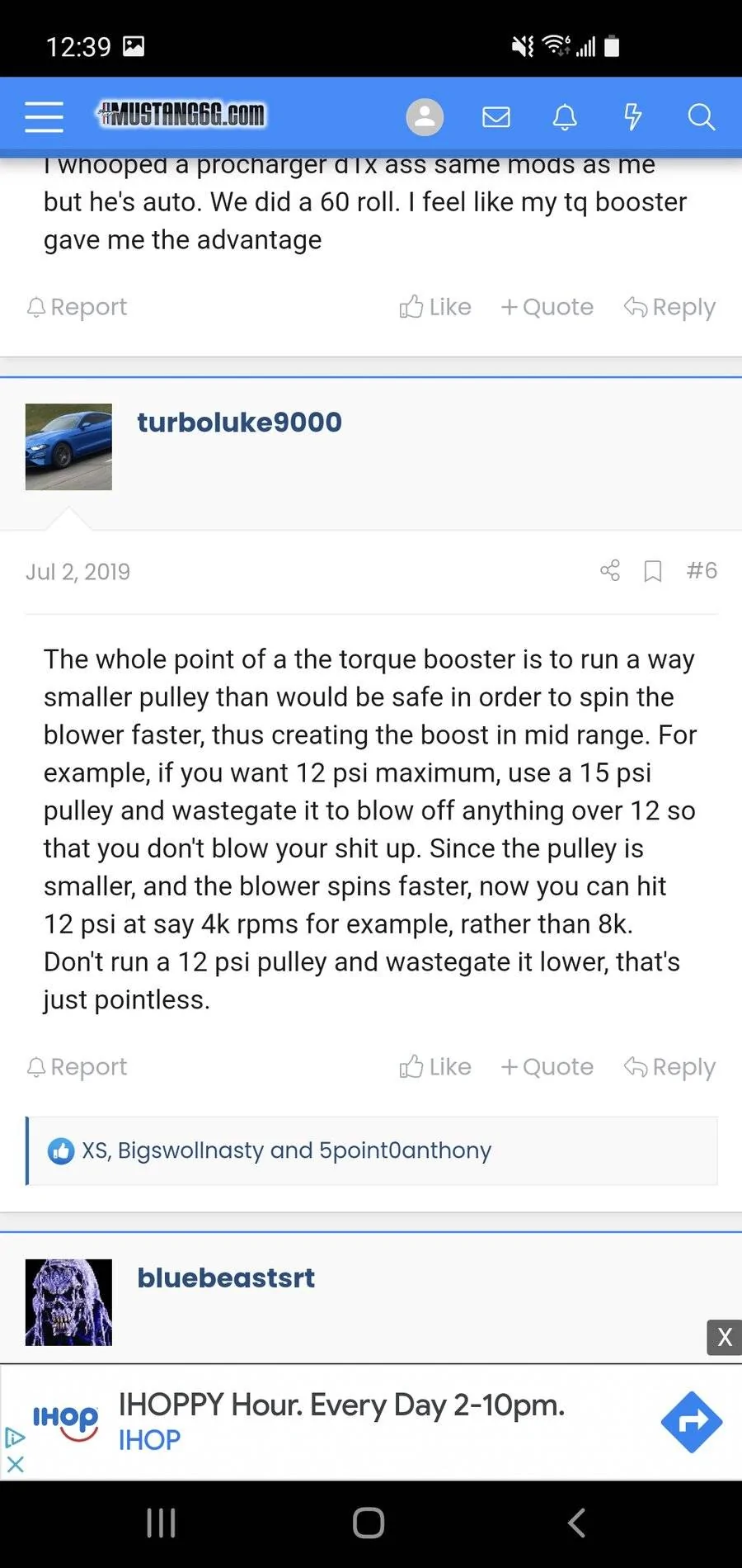

Is this just a waste gate instead of the BOV?
Seems kind of nuts to compress and heat air just to blow it into the atmosphere, sounds inefficient compared to a turbo exhaust-side waste gate or a normal intake-side bypass.
Exactly. Looks like a smaller pulley ( that obviously will have more volume at lower RPM). And a waste gate. I see a further benefit. Connect a boost controller and have few boost settings, even a per gear boost like I did on my STI.
But it seems like, while the “wastegate” is open at wot at lower-mid rpm some of the engine power the blower is consuming goes to compressing (and heating) air that’s just going to be vented to atmosphere. Frankly I don’t really know if I have that right it’s just the way it seems to me.

Ok this makes a lot more sense. You're running like a 12 psi pulley so you have more boost down low but the waste gate limits your peak boost so you don't overboost the engine
