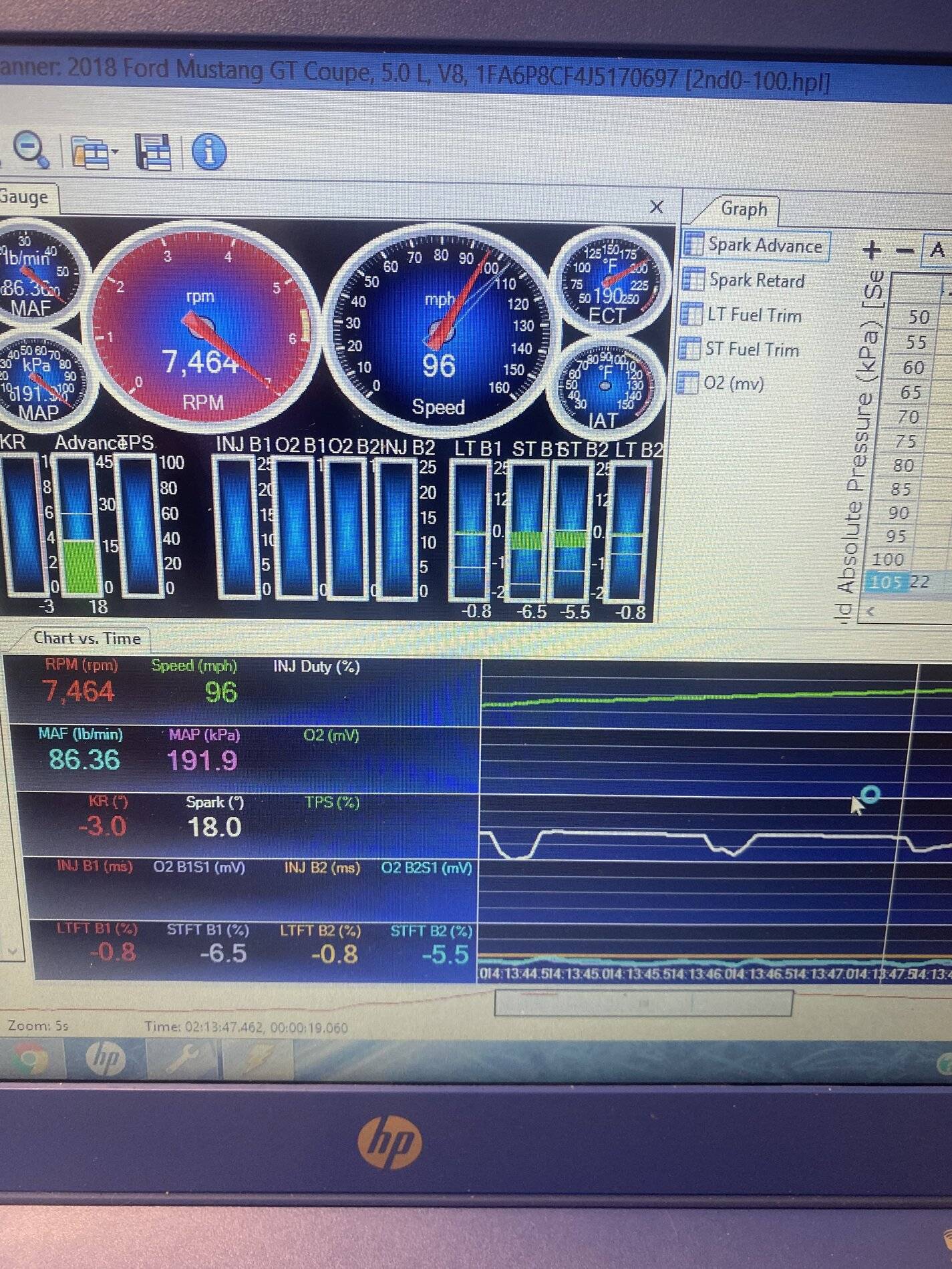

Thanks for the info. I was curious if there was any drawbacks to using the G3 over the G2 at lower boost levels. Would the G2 make boost sooner than the G3?Just while we are on the topic of pulley sizes and octane I would like to clarify a few things for anyone that may have any questions or concerns about pulley size for our kits.
