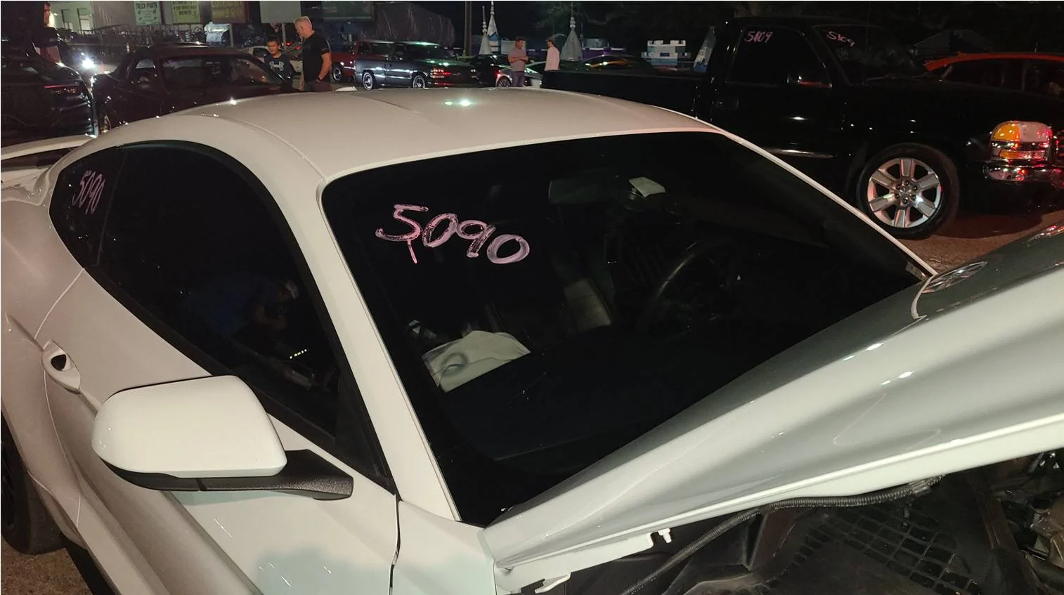

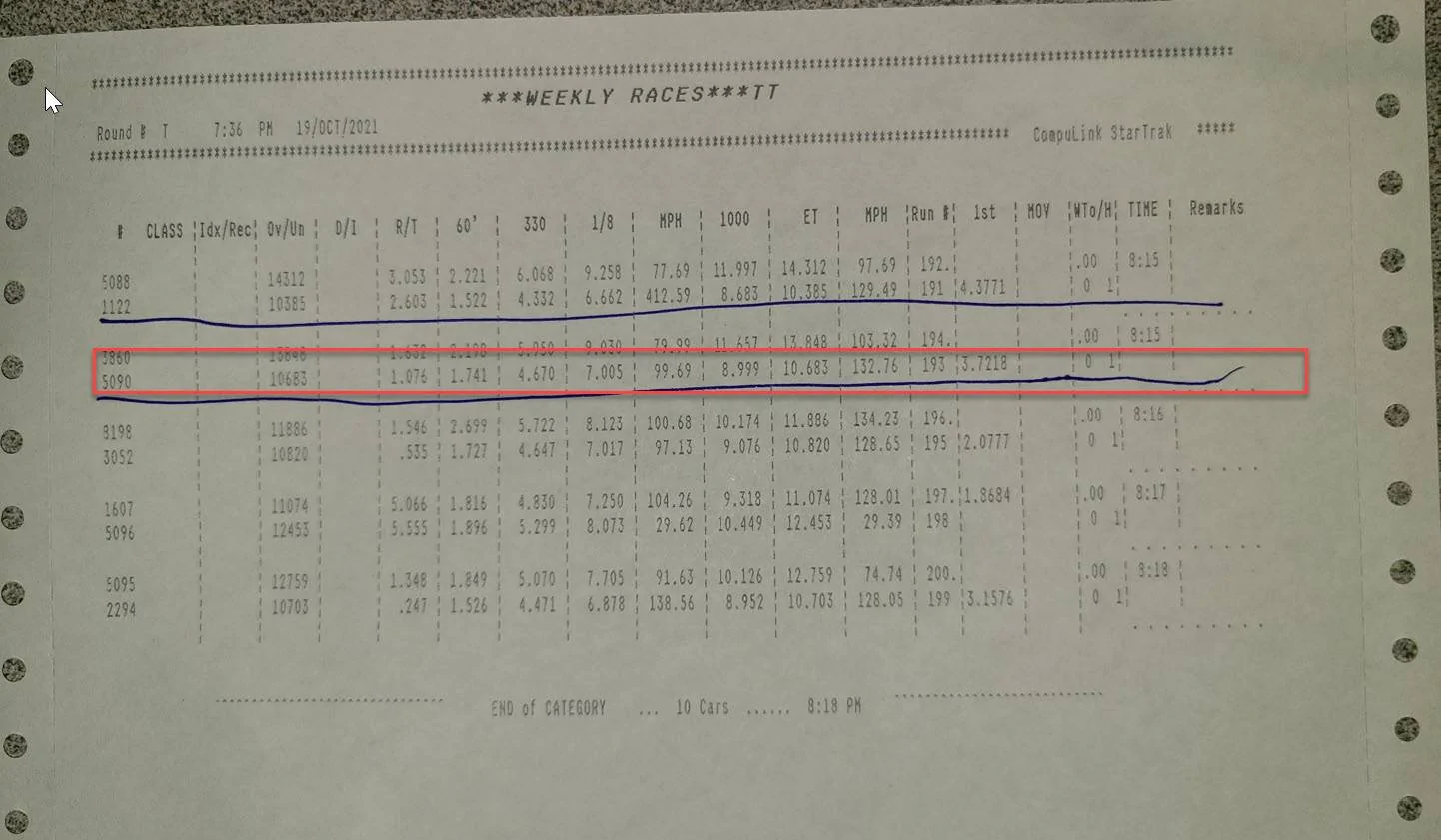

****Track Results on 8.5psi (115mm) pulley 2019 A10****
[email protected] on a 1.741 60ft. 4060lb race weight
93 octane w/Octanium Unleaded Octane Booster
The car wheel hopped bad on the 1-2 shift, and also short shifted the 4-5, but I stayed in it and was rewarded with my first 10sec. time slip.
I think I need a proper wheel and tire set up, the Nitto555r'2 are a great street tire, but they definitely didn't hook well enough for the prepped surface.
I tried a 2nd gear launch on my second trip down and it ran an 11.0 @ 131mph on a 1.8 60ft spinning and hopping on the 2-3 shift. No other runs were made out of fear of breaking an axle.

What was the DA of the run. Putting my g3 on Friday but my car has trap 101 in 1/8 on 20” nittos with just bolt ons so far 1000ft da. With all the seats in it. I would think it would trap way more in the 1/8.
TEXAS HEAT
May 25, 2016
706
278
TEXAS
2019 Mustang GT PP1 A10
DA was 1362ft. 70.5 degrees F.
The thing to remember is that I spun and wheel hopped the 1-2 and it short shifted the 4-5 which is right around 100mph. The fact that the car back halfed as strong as it did is an indication that if I get my wheel hop and traction issues sorted, and can 60ft in less than a 1.7 it will likely run a much faster 1/8-mile.
