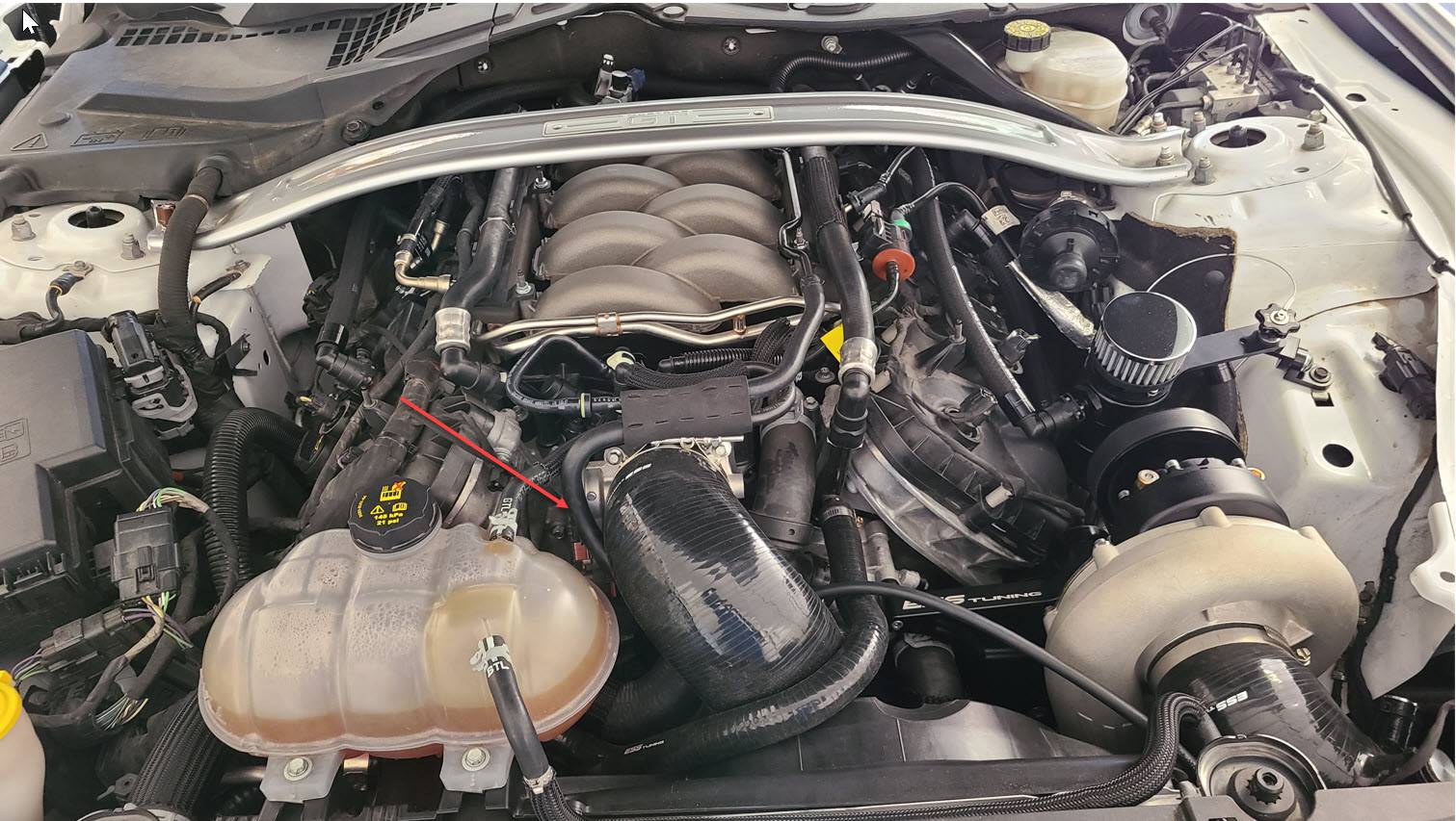

Has any one tried running any catch cans with their Ess kit?
I have a custom catch can setup for the dirty side (passenger side). I check it every week or so. Theres barely anything in it and im on the 11.5 psi pulley but have seen as high as 13-14 psi (as i stated above about the mustang not having a map sensor this reading could be off). I put on the catch can sort of to see if it was needed. The d/s pcv runs to the air filter which ive cleaned once now and that tube was dry as a bone.

I also run the same catch can set up as Muffin, I purchased mine directly from UPR and I'm very pleased with the set-up.
Looks good. I was running another company’s catch can and thought it was doing its job but when I took the intake manifold off there was blow by every where so I’m trying to find a legit catch can to stop this.
The only real way to keep it out of the intake is to run breathers (can be messy) or a dual vented catch can that doesn't recirculate the vapors, oil and condensation through the intake manifold.
