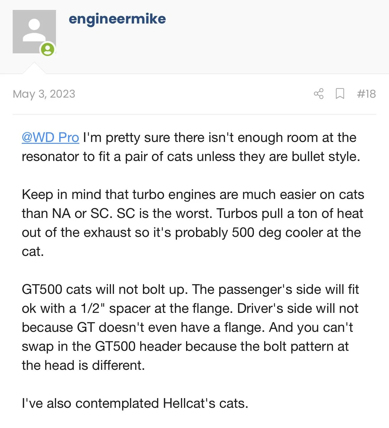

I honestly don't think enough research has been dedicated to this topic, but mostly no one wants to spend $3200 on the GT500 cats/manifolds to chop them up. Im sure the Cats themsleves could be cut out of the OEM GT500 cans, and then welded into new housings or even re-use the GT housings.
I retract my previous statement of not fitting and was remembering Mike talking about the headers won’t fit. But yeah you are correct who wants to cut up that much money in cats just to have to mess with welding them on. If we had emissions testing in FL I would run catless like I am now until I had to get tested and (even as much of a pain as it is) swap back to stock for the testing.
