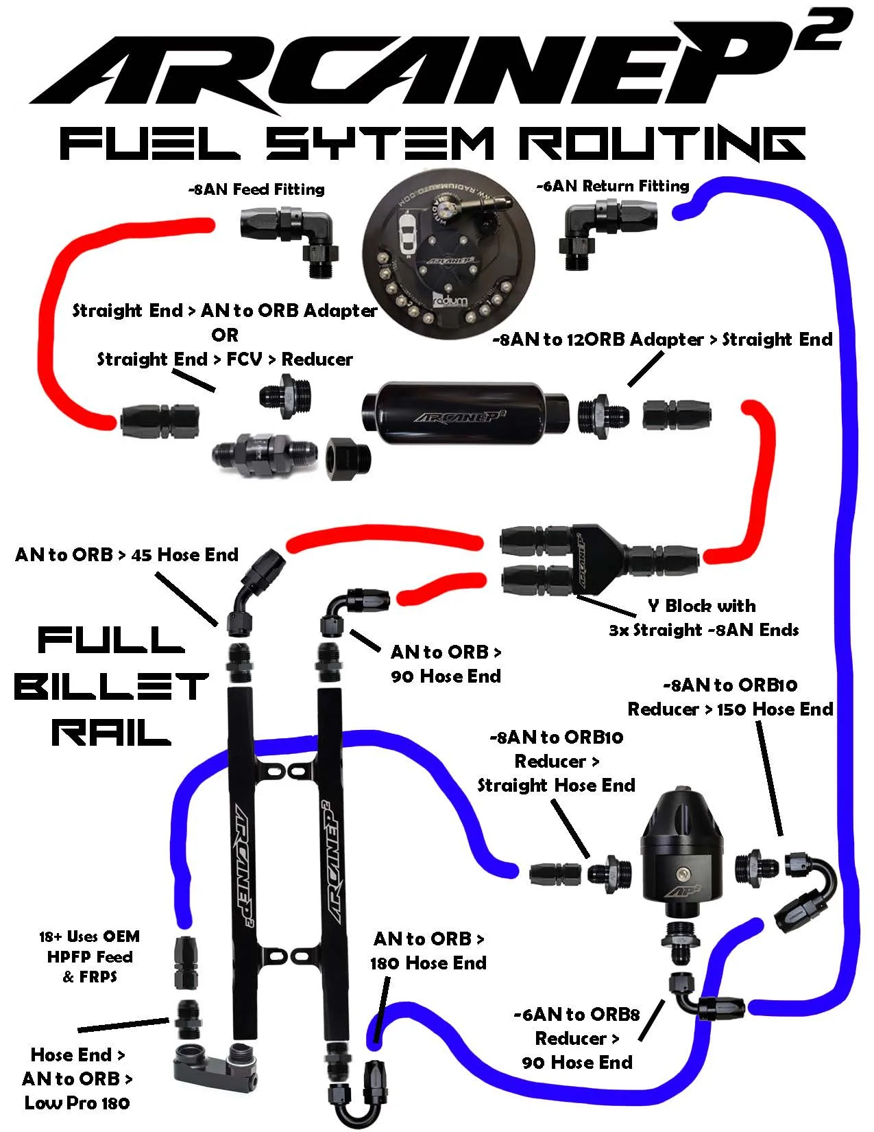

Yeap, was definitely not gonna try to run a vacuum line that long.
Also yeap, running the rails in parallel with the HPFP feed coming of the passenger rail (using supplied nipple) similar to stock.
Will post up pictures here when I'm done.
This is how it'll be setup

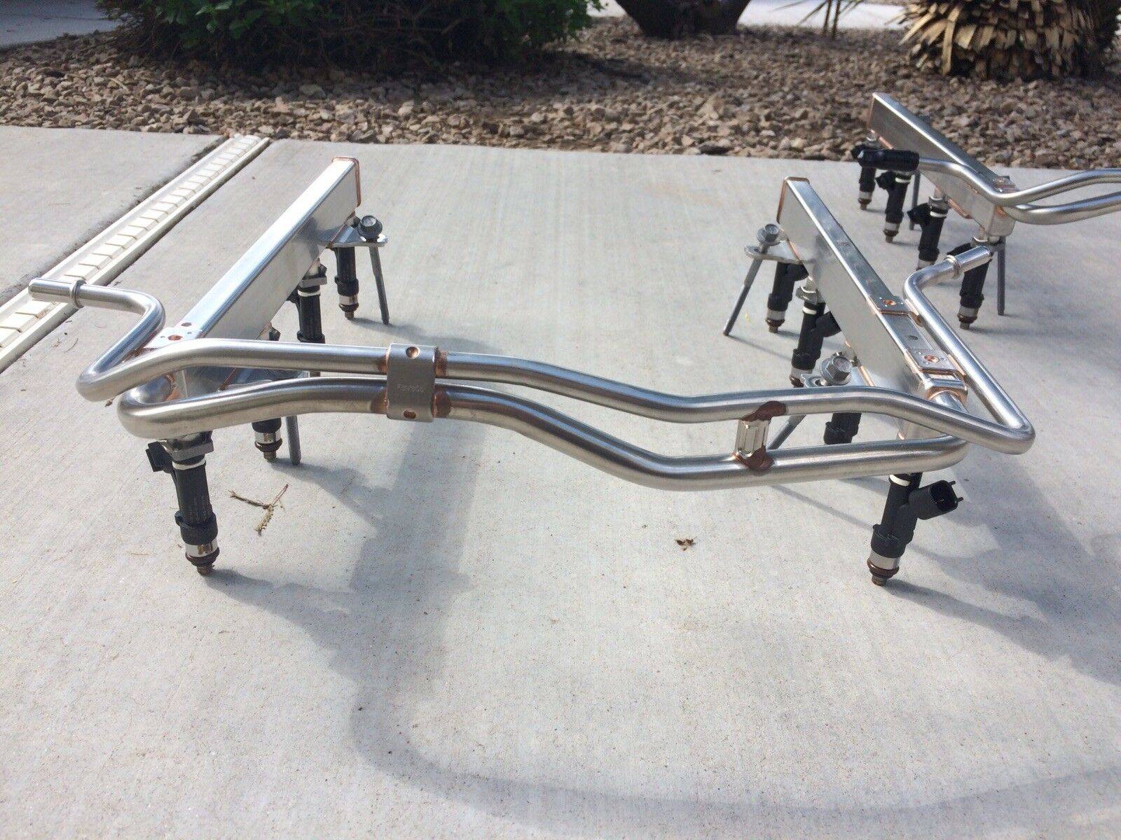

If you use the nipple screwed directly to the rail though you'll be supplying your hpfp and about 50 percent of your fueling between the 1 and 2 cylinder. Also the factory setup does not feed off of the passenger rail although many think that because of the location, look closer at how its distributes.
