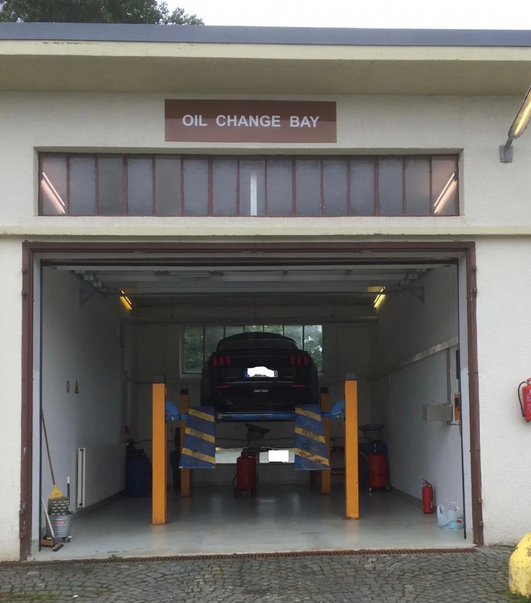

Unless you are set on the dealer handling it, you may want to do it yourself at the Auto Craft Shop. Did that for my first one just to get to know and inspect the car better. Ordered filter from Rock Auto. $14.27 for filter and $4.99 for shipping. Received within a week. Ordered case of MC 5W-50 from PX--no shipping charge, of course. Got that quick also ($9/quart IIRC). No issues with oil change itself. All of the posts on here helped tremendously. Felt like my 5th oil change on this vehicle rather than first.
Will post details in separate thread later...
