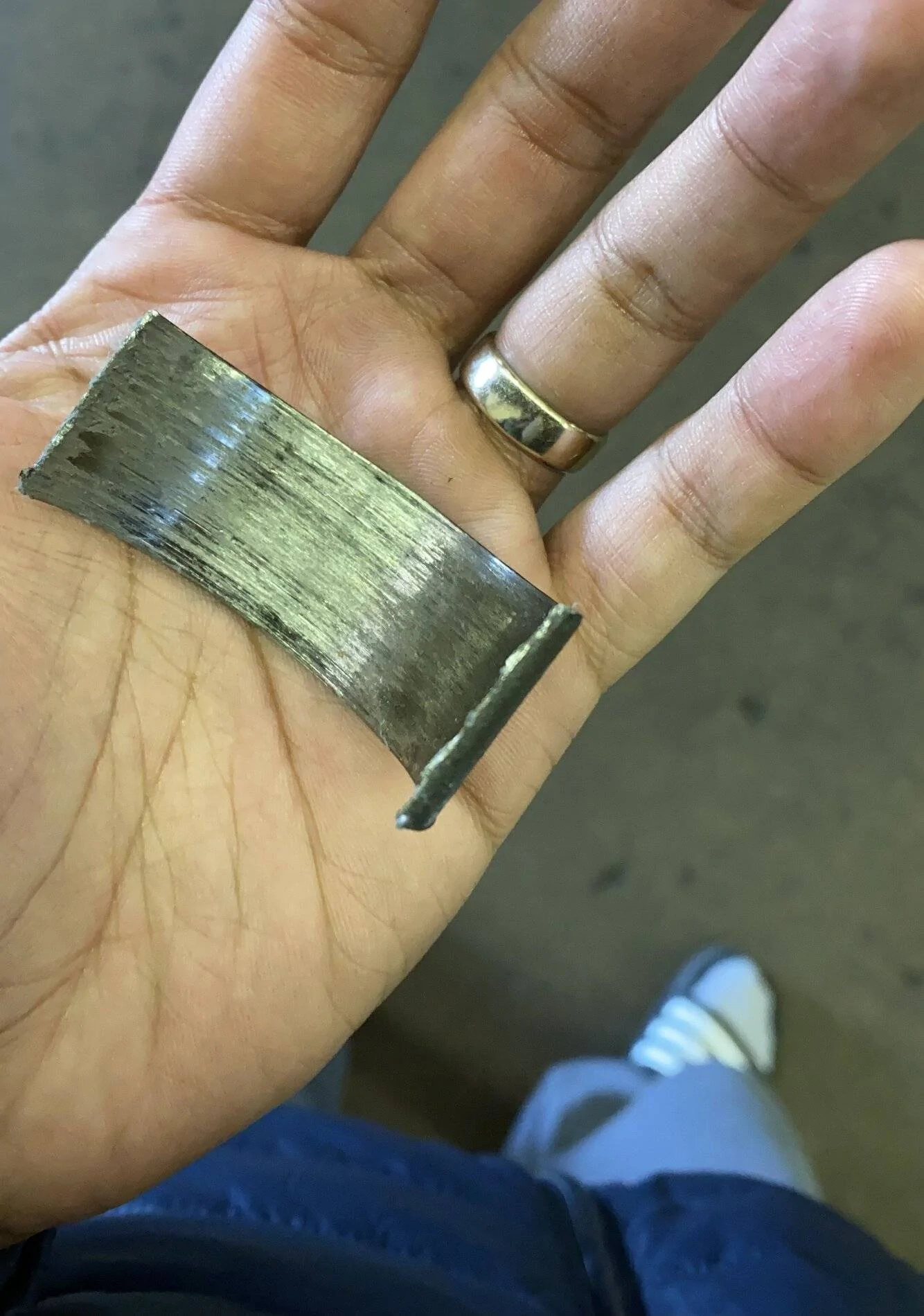

Engine failure can happen at any time. 10k miles for me. I was driving my 17 GT at about 30 miles and lets just say I kept the bushing pictured below as a souvenier....the other half was turned into shards and into the oil it went...
Your lucky that you were stock and warranty covered it. Its a hefty price to pay when modded...
On the flipside, was able to drop in a Ford Performance Aluminator motor into it and shes been running great since!

True enough, and a gamble we accept for the thrill of the ride. Nasty main bearing right there.
