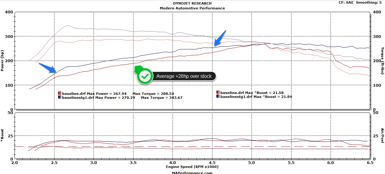

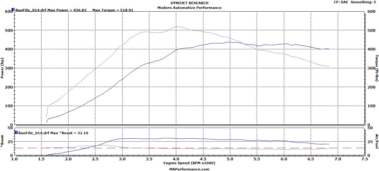

To answer you question about a tune, and turbo lag. Below is a graph showing you how fast the stock turbo spools. To relate it to another vehicle, a stock EVO X turbo doesn't make full boost until about 3,000 rpm's on a built, high compression motor. It doesn't make peak torque until 4,000 rpm's.
The Ecoboost Mustang in stock form will make full boost at 2,500 rpm's and peak torque at 2,700 rpm's as show on the dyno below. The red line on the graph below is a completely stock Ecoboost Mustang, on stock tune. The blue line is a stock EBM with Cobb Stage 1 Tune.
Hope this sheds some light!
