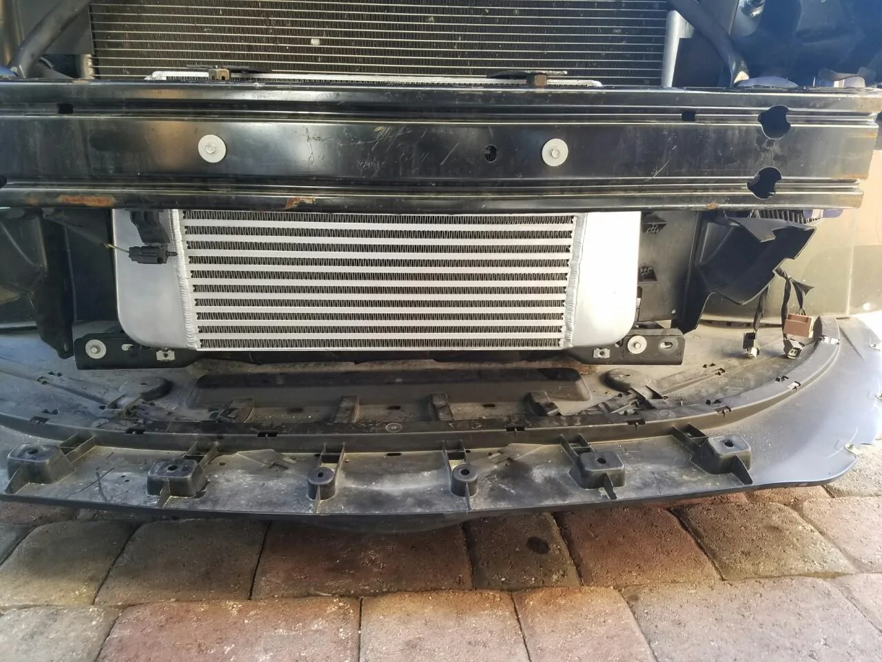

I just bought this same intercooler for my car how did you mount the intercooler? I am still waiting on it in the mail but I cant tell from the pictures if there are mounting tabs on the intercooler or if you have to make something yourself. Please help!!!

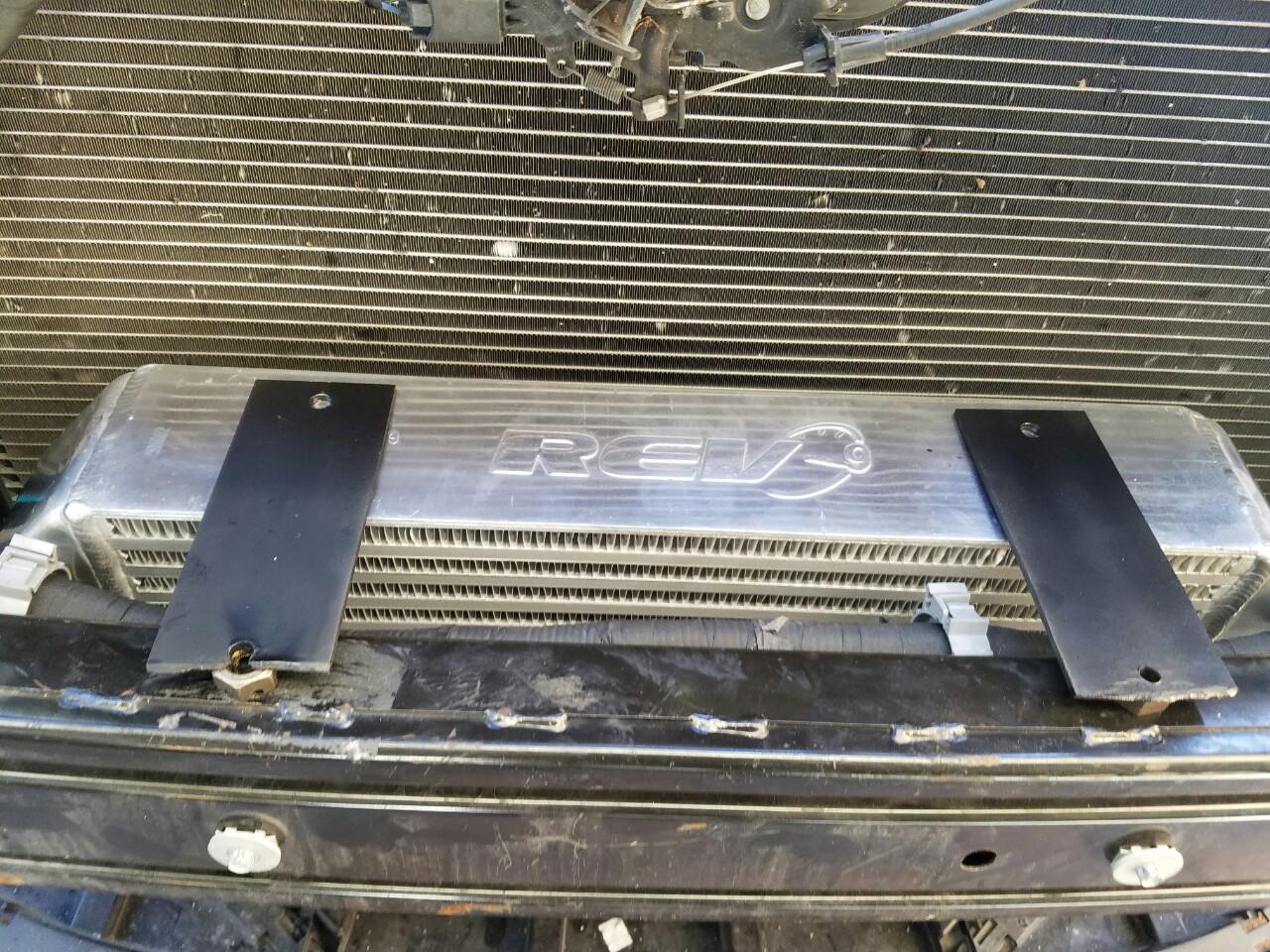

No there are no mounting tabs ,but it was super easy to mount i just drilled into the very top of the intercooler no air passes there, and then used a straight plate to mout it to the bumper support. The lower bracket for the stock intercooler will work to support the ebay intercooler from the bottom.( i dont remember if i flip it over or switched it left to right).

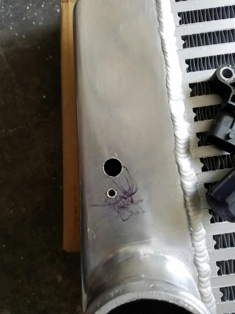

Also it doesnt have the hole for the sensor like in the stock intercooler so you are going to have to drill for that too.
Btw i have 0 issues and it works perfect.

FYI, make sure the intercooler is not resting up against the A/C condenser.... the space i left between the two tightened up after almost a year and rubbed a tiny hole in my A/C condenser. I am changing it out myself (certified a/c tech) seeing how i goofed by not attaching spacers.
Diablocoastie
Feb 21, 2015
169
31
Va
Will
Deep Impact Blue EB (SOLD)
If you plan on drilling holes in the top of the intercooler and bumper support beam and mounting it with top and bottom brackets than you should not have to use spacers. But if you don't want to drill holes in your nice new intercooler just use a strip of rubber (top and bottom) or something that stays put and keeps the intercooler away from the condenser.
