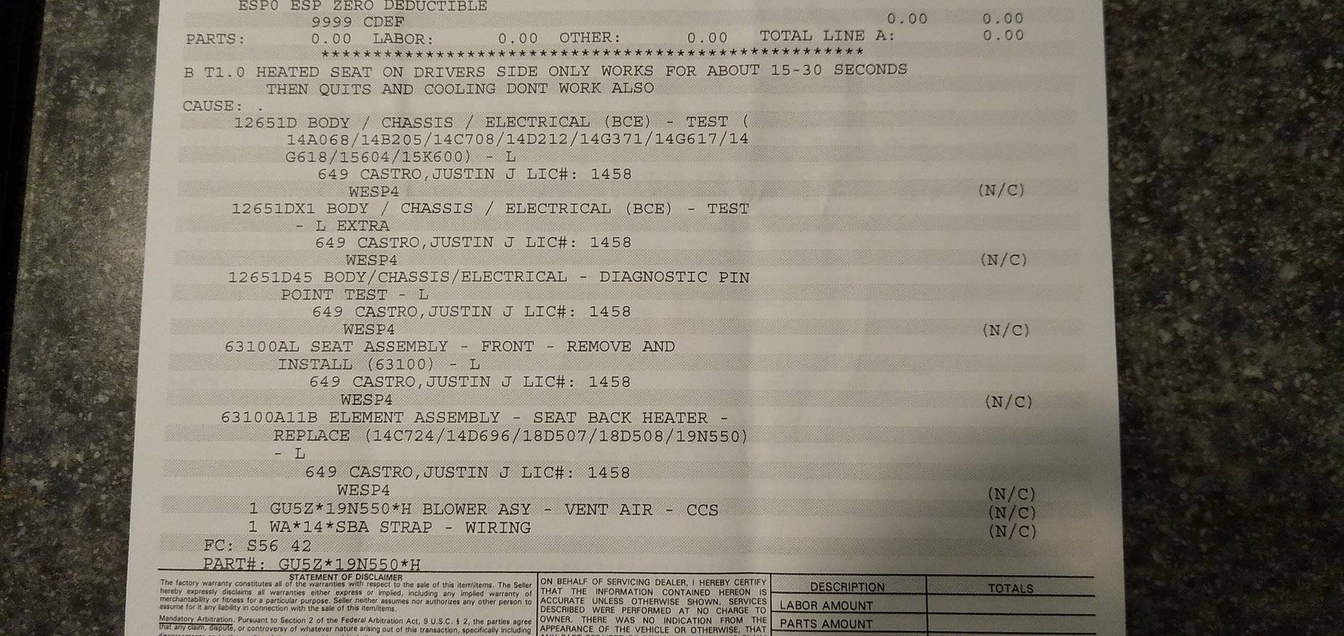

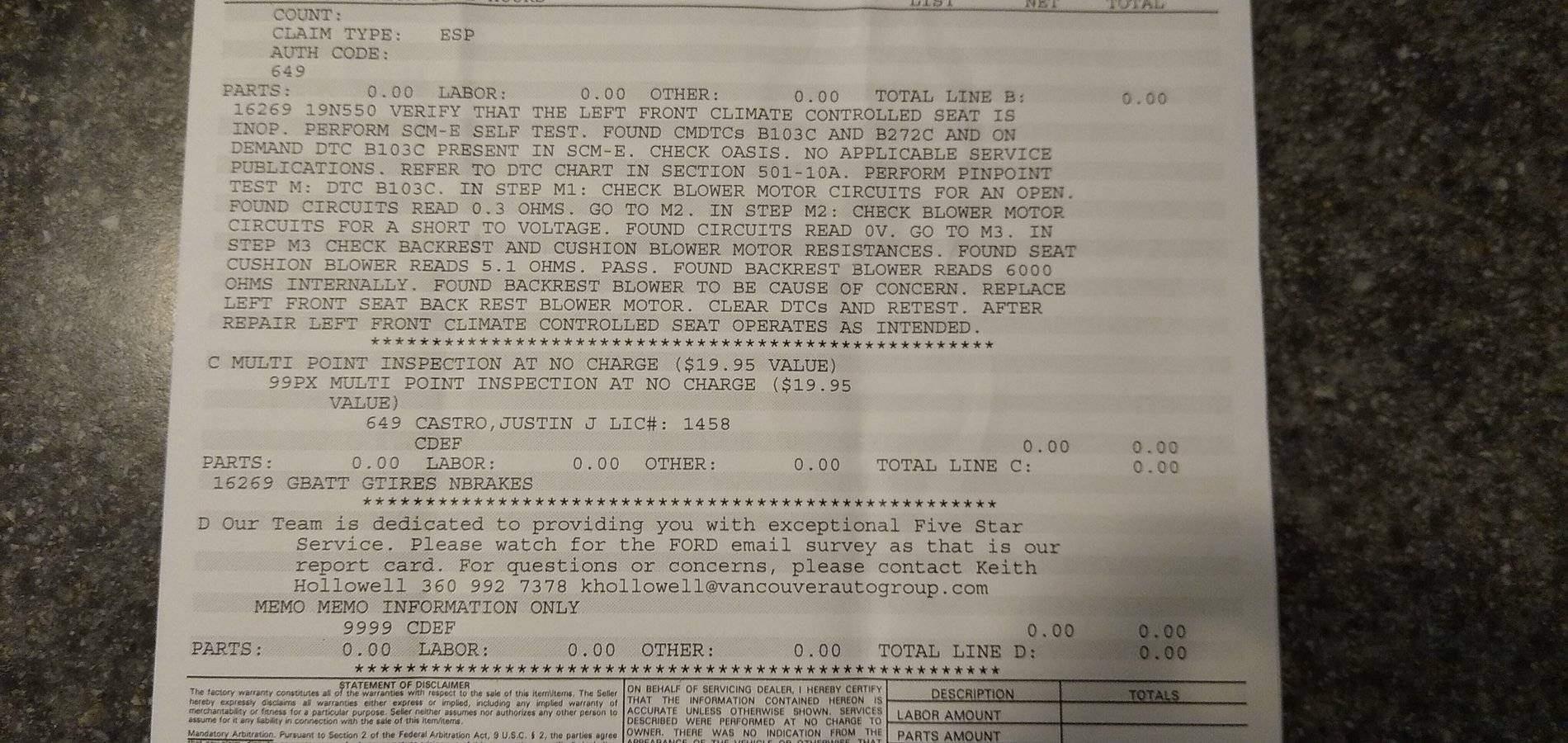

Anyone else have this ? On my car the passenger seat works fine . Drivers side lights up , but I don't hear the relay/switch 'click' behind the button like on the passenger side . Or sometimes it clicks , then a few seconds later clicks off.
I know the dealer will fix it , but if its something easy , it will be worth it to fix myself.
