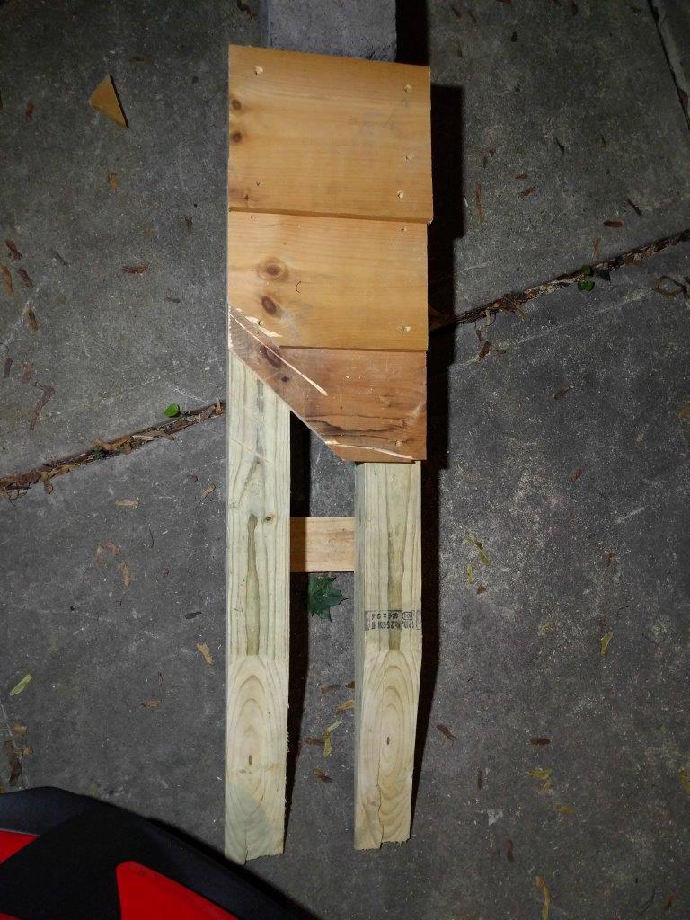

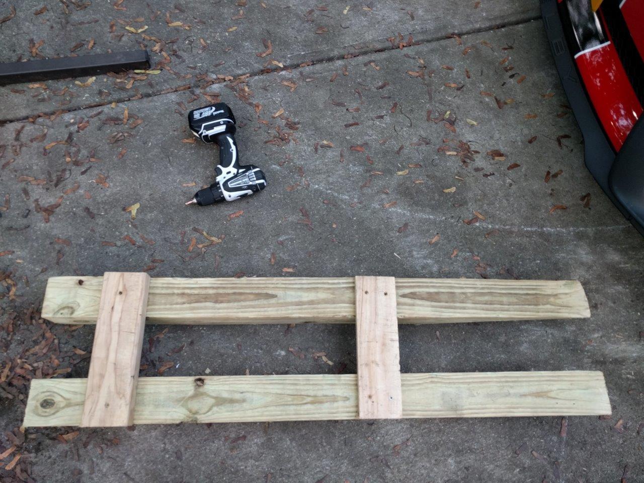

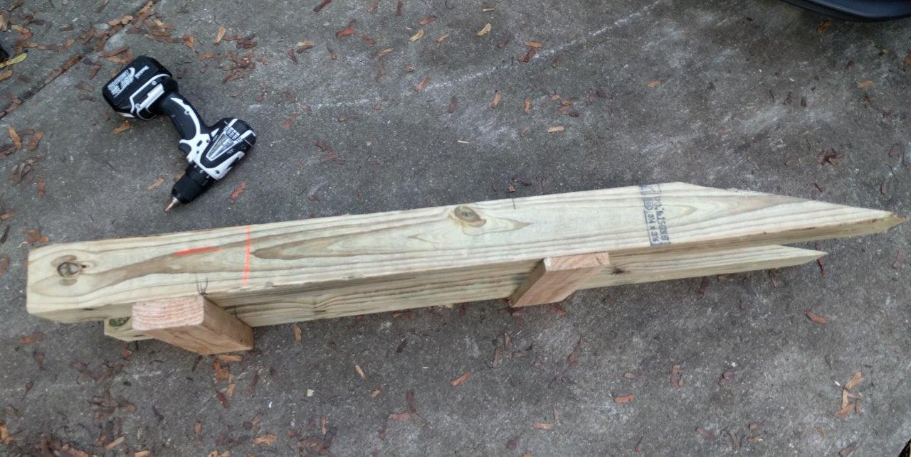

I cut the 4X4X8 in half to get 4X4X4

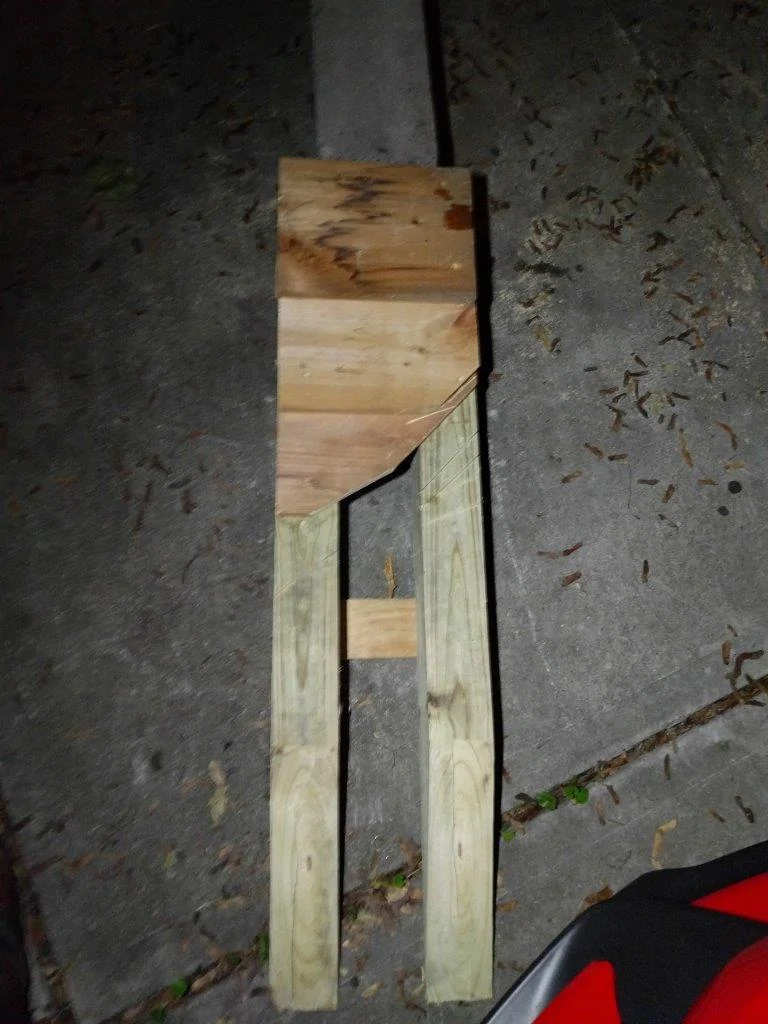

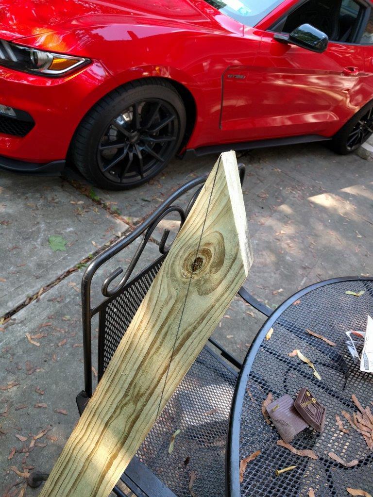

I then took a 14" peice of wood and drew a line to make a ramp
I originally did 50 degrees but the car pushed the ramps.

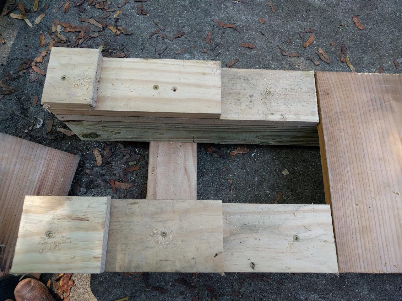

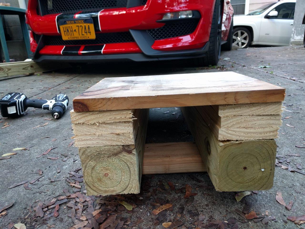

The rest of the pictures are self explanatory

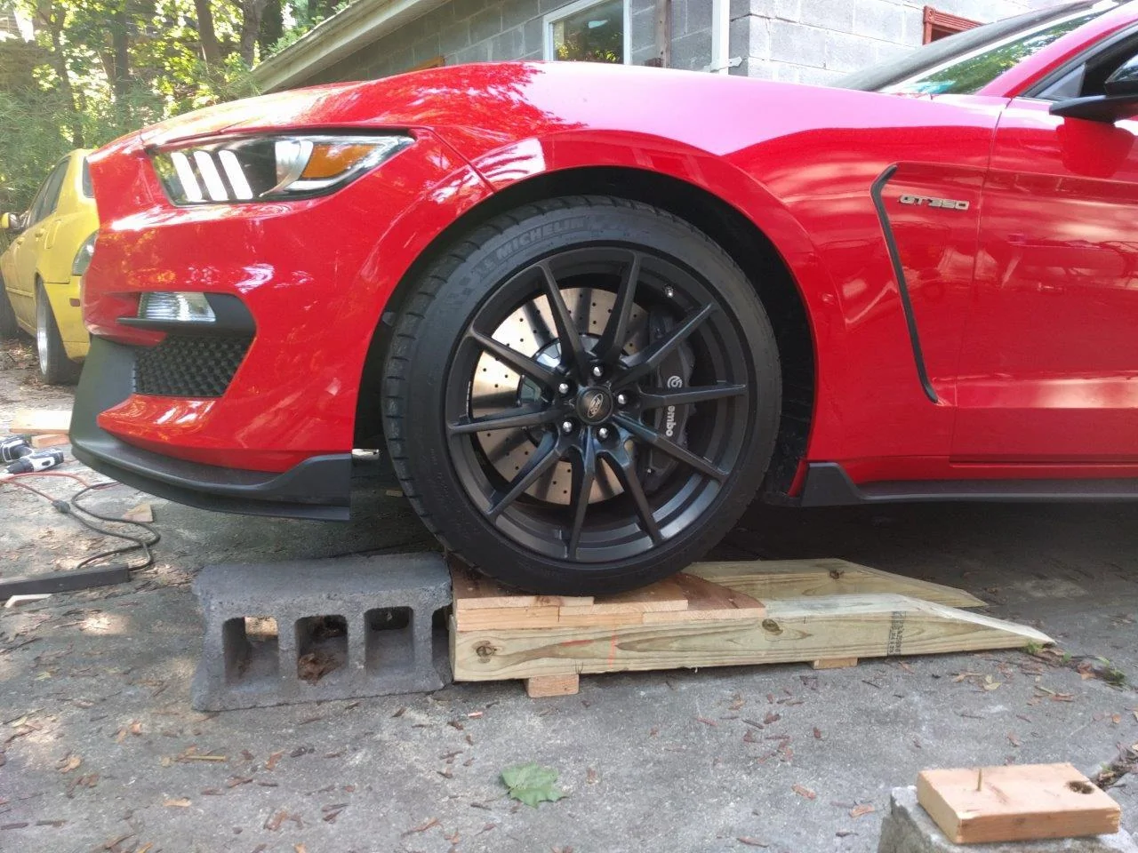

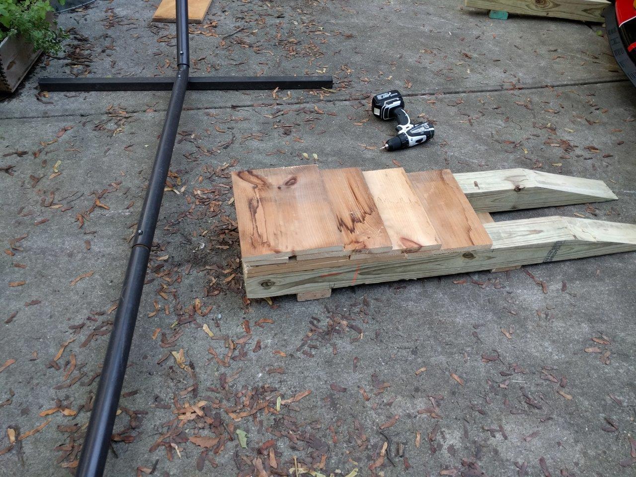

Finished product below the cut outs are for the front splitter im not sure in the final version if it was necessary
They work well If you cut a 4X4X10 in half you can have more steps for a little more height but they might be in the way if you want to change the oil
I made it 12 inchs wide (295 Tire)
EDIT:
Use at your own risk
This design is not made for you to move the car around on, just on and off. While is strong for direct down force if for some reason you were going to go on the ramps and then jack up one side higher I would probably used higher quality wood, longer screws, glue between the boards any maybe a wider base.
