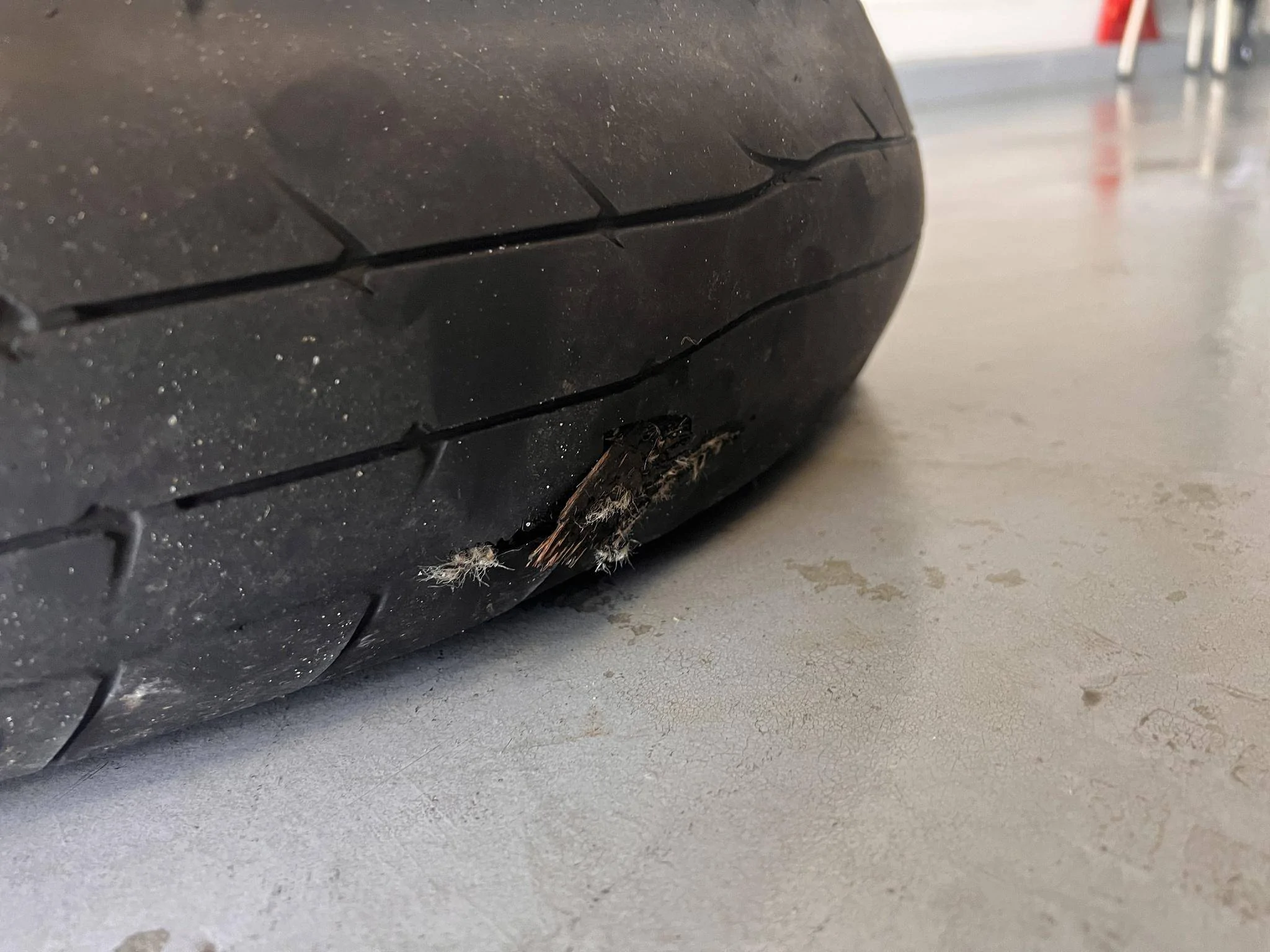

I almost blew out a MH racemaster front skinny at like 120+ mph, I hit a minor bump in the road while heavy braking and it was just too much weight on the front for the tire to handle. I got very lucky. Tire was all deformed and lumpy and missing a chunk.
If you are going to street drive on skinnies I wouldnt go with the racemasters, id go with the mickey thompson sportsman they are heavier but higher load capacity and probably stronger.
