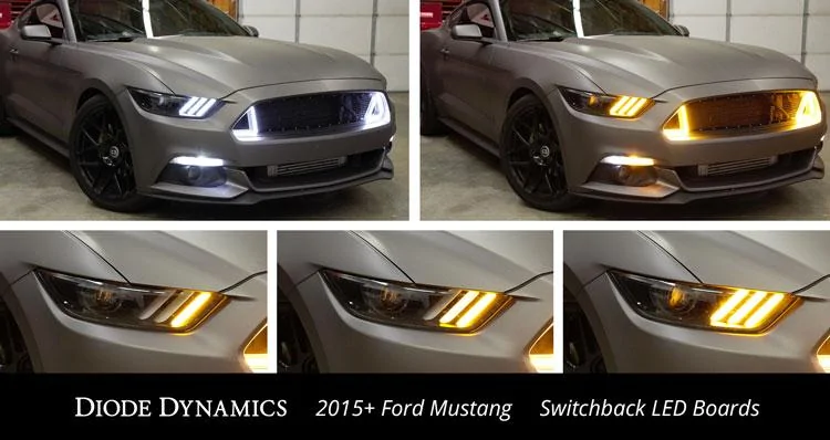

You're talking about the gills in the headlights right? Those are already LED so it's not as simple as changing some bulbs.
As NasaStang posted, DiodeDynamics has a kit that replaces the LED's but you have to take apart the headlights to get to them and do some soldering work.
