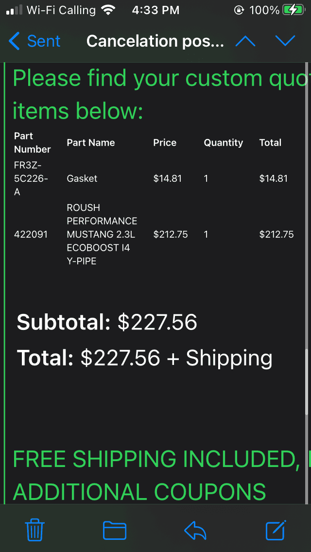

It will work with any axleback.
the piece between axleback and y pipe is the same. Assuming you cut in the right places, the pipes between resonator/y pipe and axleback will align perfectly.
you can get roush y pipe from Levittown motorcycles for212 tax free shipped
I know because I bought one awhile back.
