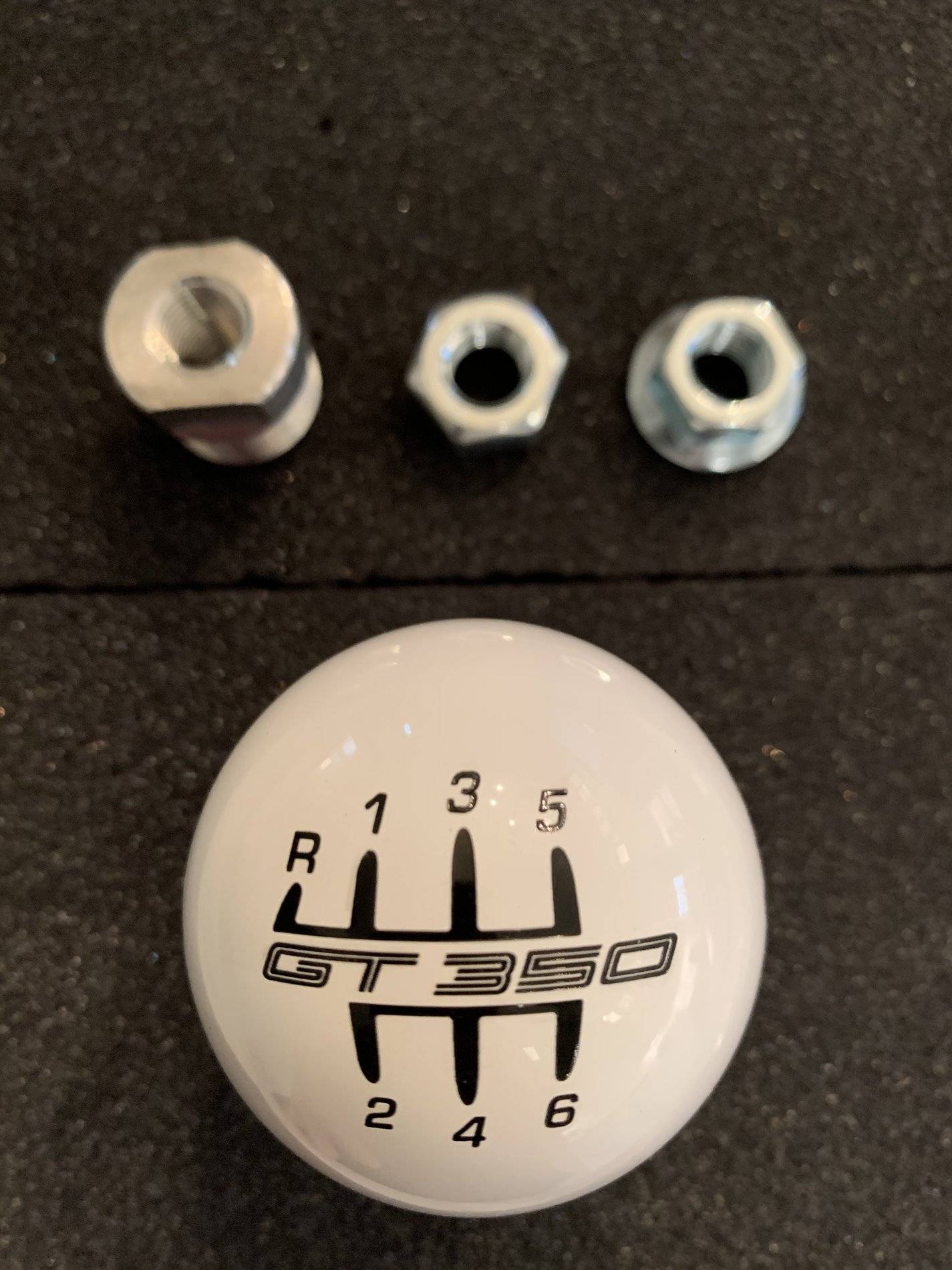

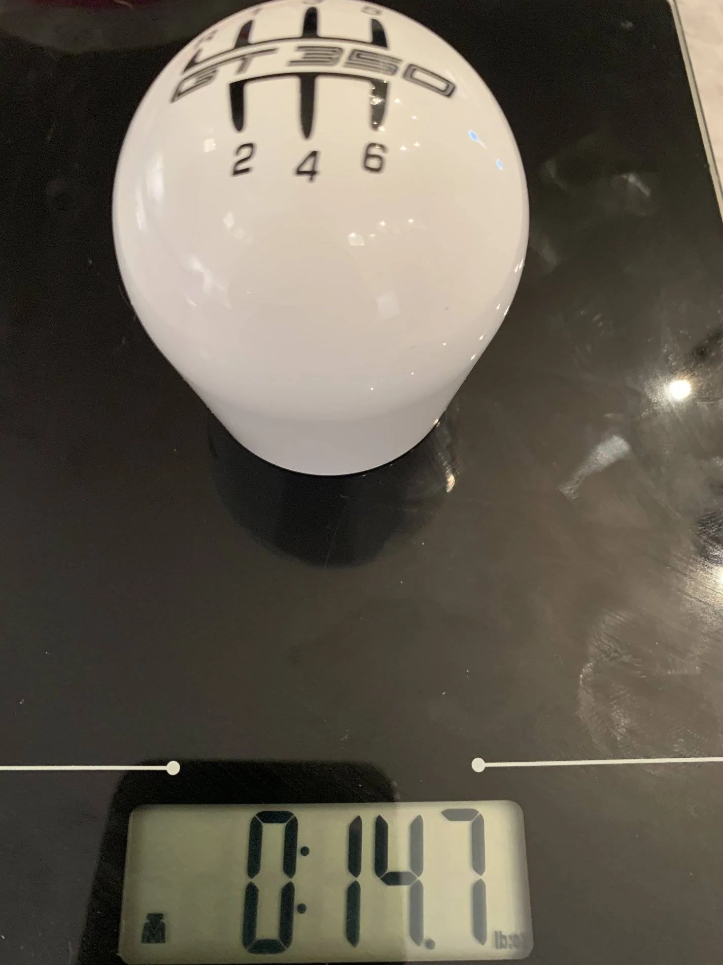

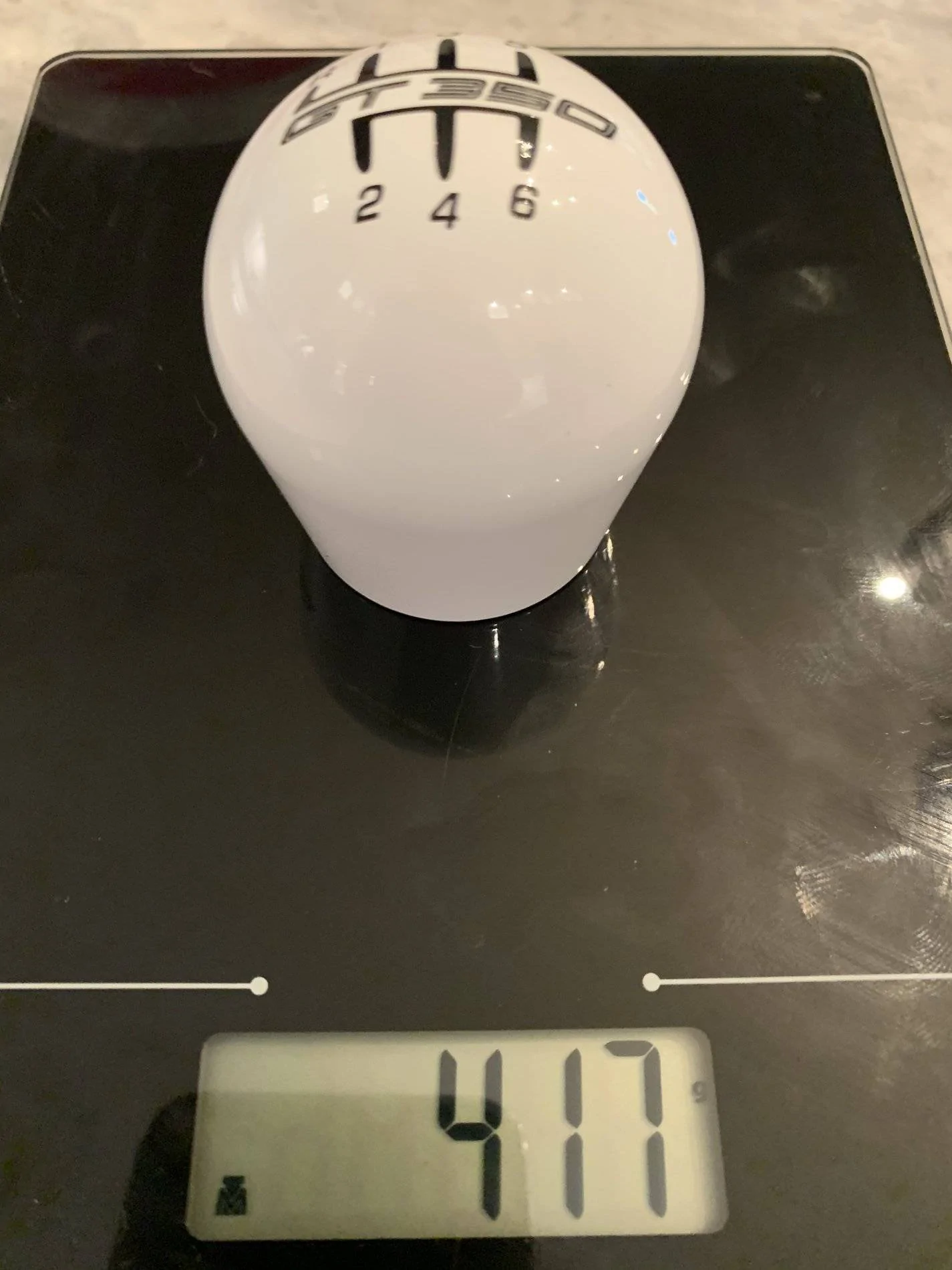

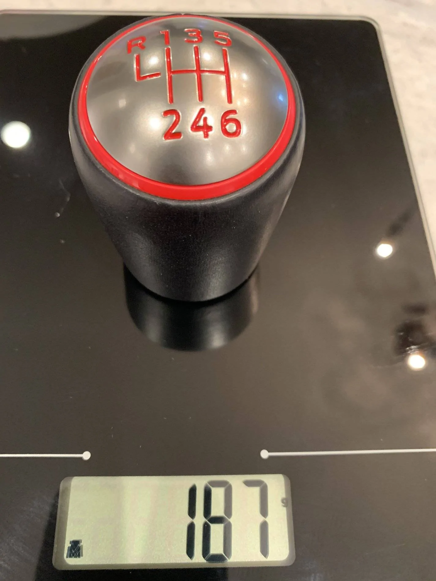

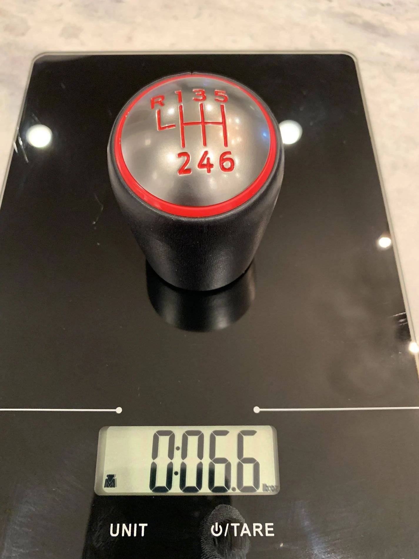

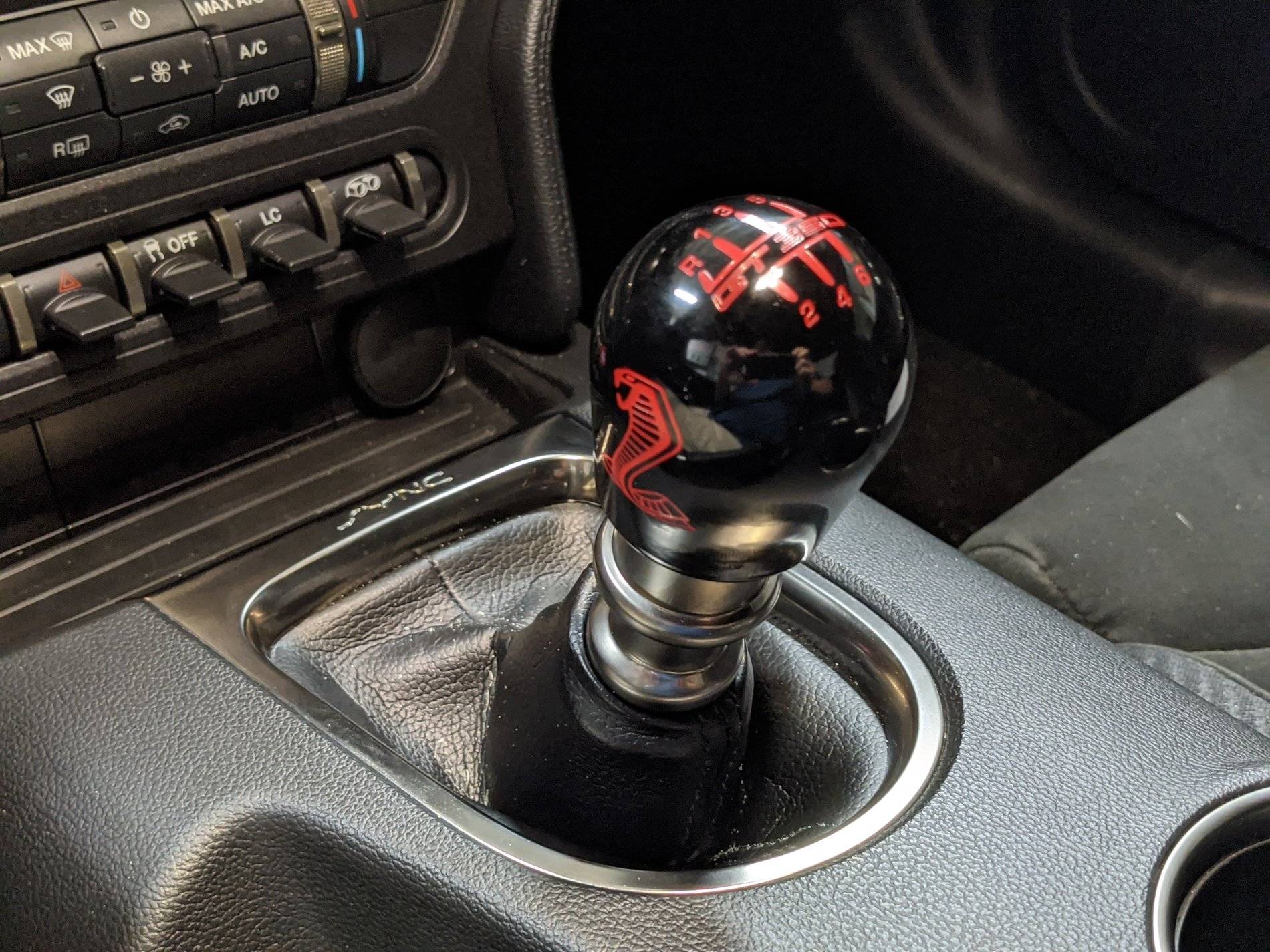

Received my Billetworkz knob. Pleased with the way it turned out after a very long wait. Added picture to show how much it weighs in ounces and grams compared to the stock knob. I will post pictures once installed.

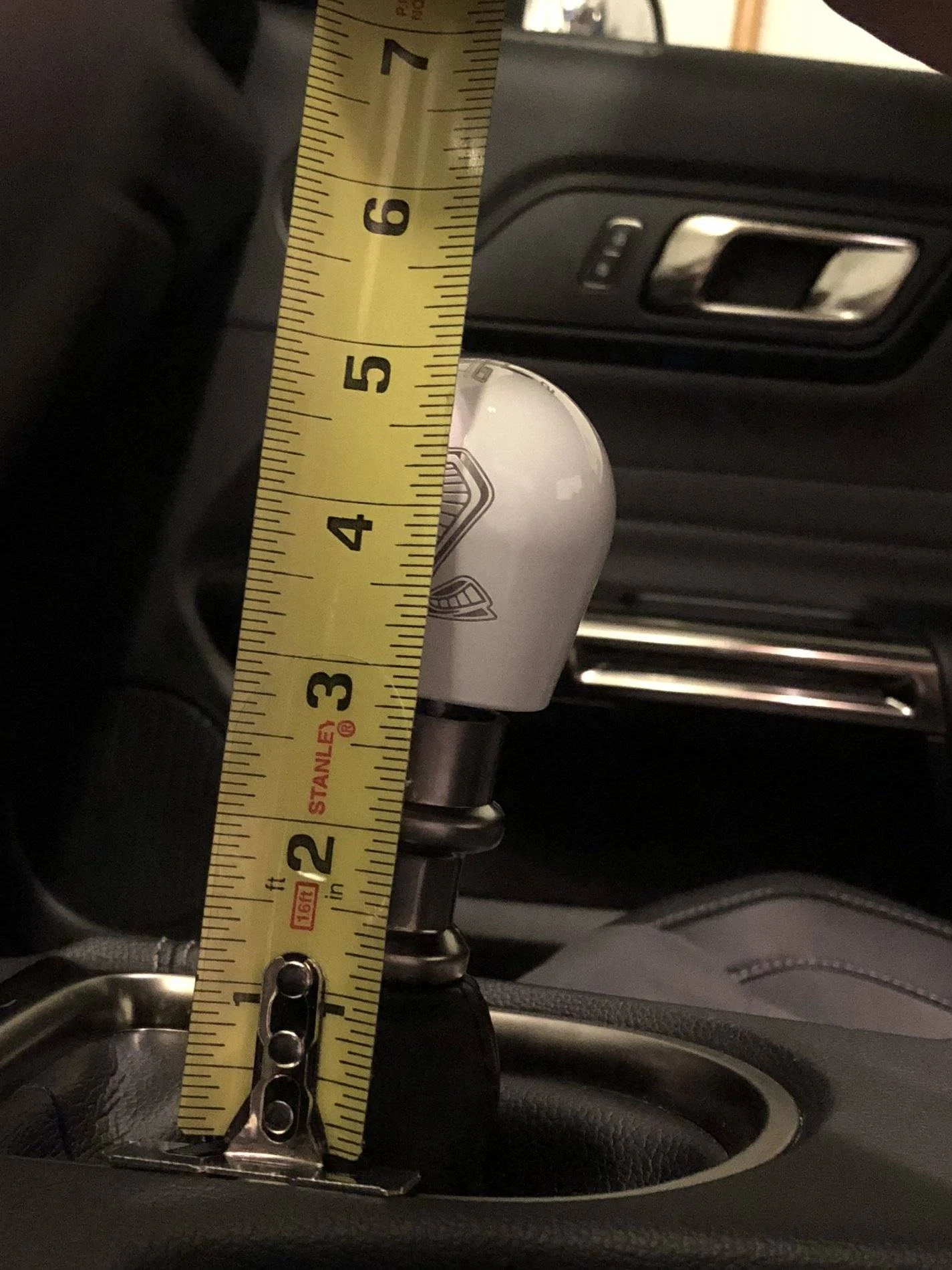

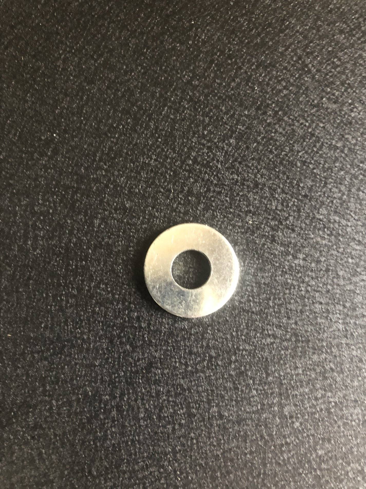

so question... I think my knob might be slightly different and pics would be worth a thousand words.... I have a 5/8” x 1/8” rubber washer that doesn’t meet the gap between the adapter nut and top of the shift knob, in fact 2 of those don’t, so at more than a quarter inch gap to cover, what kind of washer are you using???Great description of exactly how in did mine, not a drop of loctite. It took a little time and patience to sand down the washer to the perfect thickness. I came up with this solution as I didn’t like how high it sat with the lock nut like you.

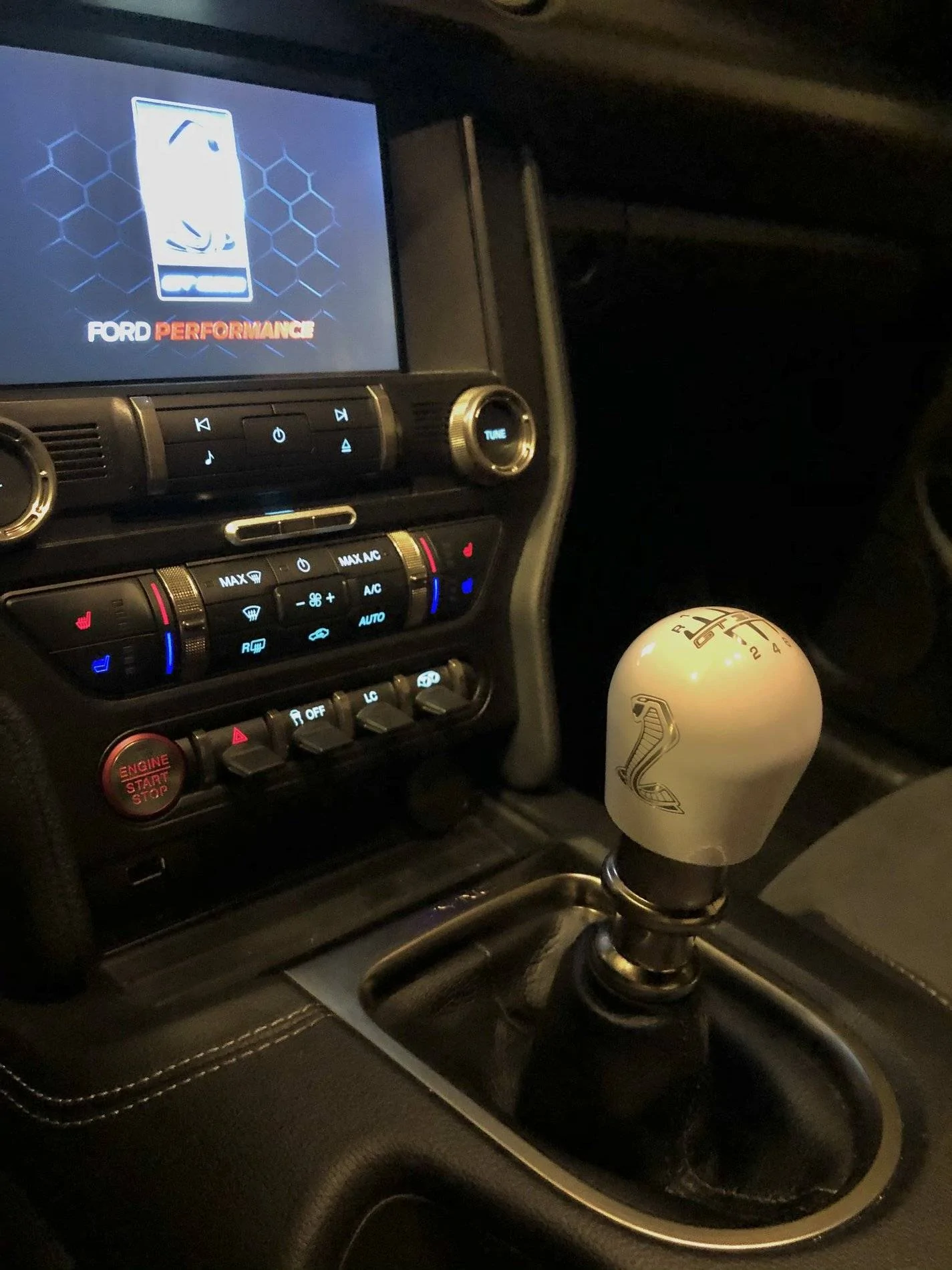

I read back over the thread. I think you’re trying to use the washer in a different place. My washer slides on the gear lever shaft and stops just past the threads. Then I screw on the knob, file, test, file, test, etc until at full tighten down it centers. 5/16 washer I believe.so question... I think my knob might be slightly different and pics would be worth a thousand words.... I have a 5/8” x 1/8” rubber washer that doesn’t meet the gap between the adapter nut and top of the shift knob, in fact 2 of those don’t, so at more than a quarter inch gap to cover, what kind of washer are you using???
Don't use a rubber washer in place of a jam nut. That will never hold.so question... I think my knob might be slightly different and pics would be worth a thousand words.... I have a 5/8” x 1/8” rubber washer that doesn’t meet the gap between the adapter nut and top of the shift knob, in fact 2 of those don’t, so at more than a quarter inch gap to cover, what kind of washer are you using???
Good info, I’m not interested in using locktite so looking for the best way to go with the stock shifter. The leather got slightly damaged getting the oe knob off with a strap wrench even using a towel and separately a silicone grip sheet. Brown thread lock was used in production. Not the worst experience with an oe knob, that would have been my 2006 350Z which would have been easier to take off it was tack welded on.Don't use a rubber washer in place of a jam nut. That will never hold.
If you hear mention of other people using rubber washers, it's probably in combination with a MGW kit and it's to space the boot properly. I have a bunch of rubber washers in use for that purpose, but they've got nothing to do with keeping the knob tight.

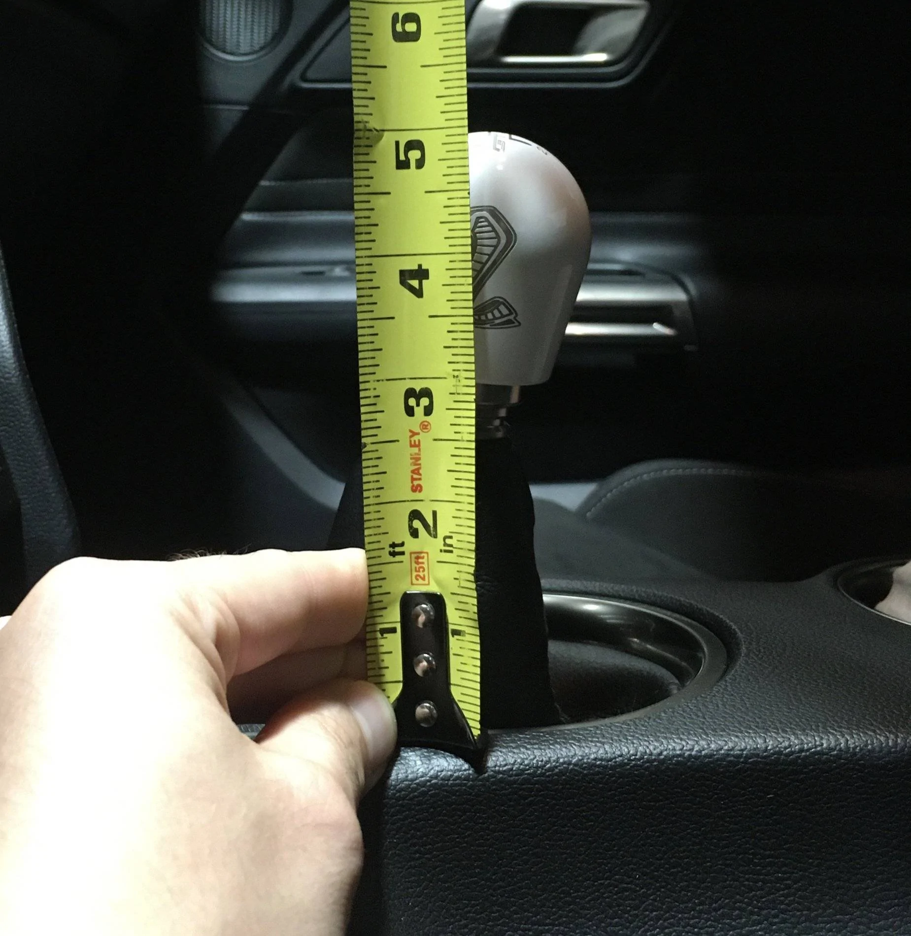

I don’t know what you consider tall. This is about maxed out on height with my MGW shifter. Never had it on the OEM shifter. I prefer it at this height, it’s quicker when you’re doing more aggressive driving with two hands on the wheel most of the time.I’ve got this mounted with one nut and it’s a bit tall.
Well I guess I’m good then.I don’t know what you consider tall. This is about maxed out on height with my MGW shifter. Never had it on the OEM shifter. I prefer it at this height, it’s quicker when you’re doing more aggressive driving with two hands on the wheel most of the time.

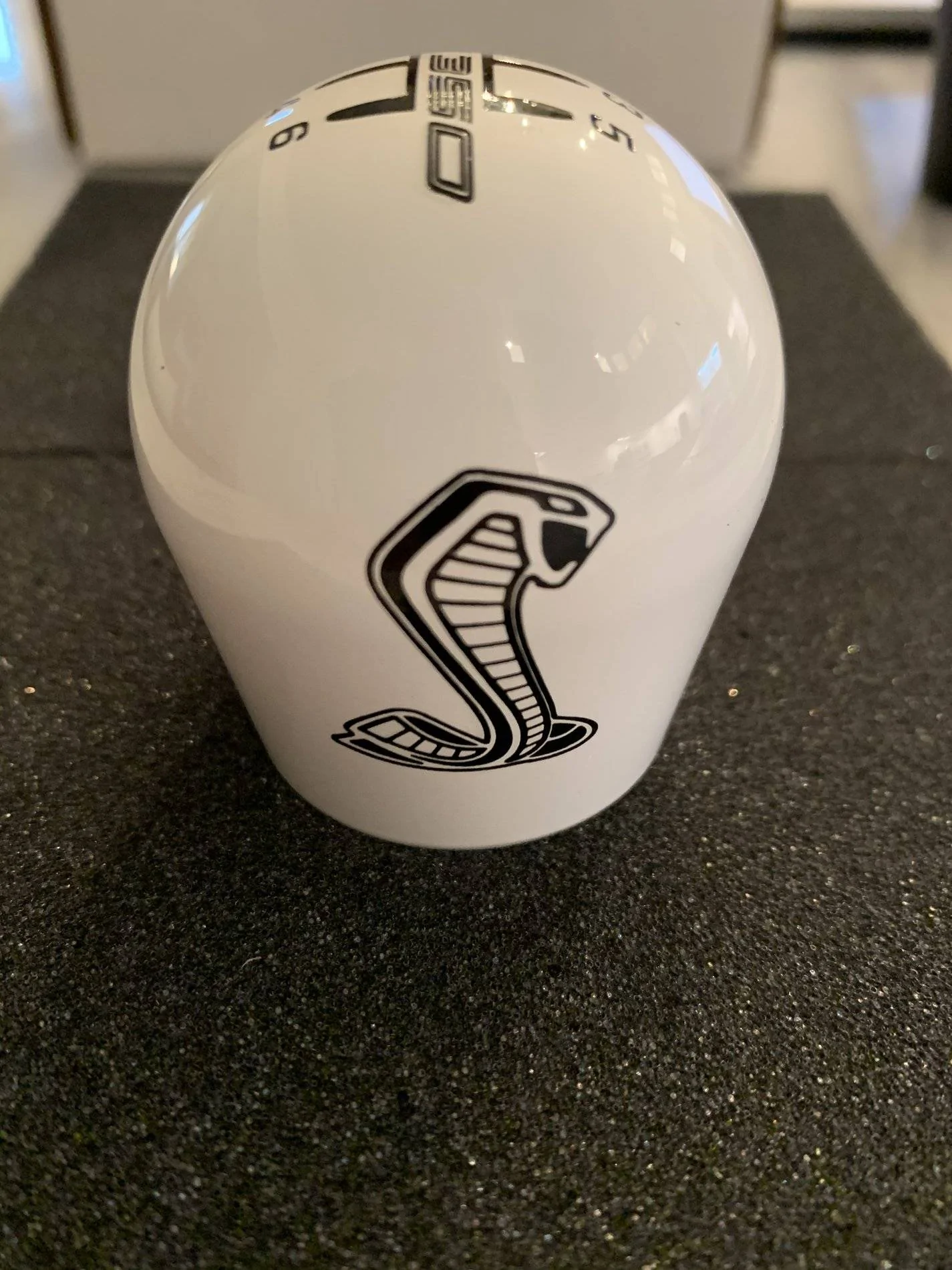

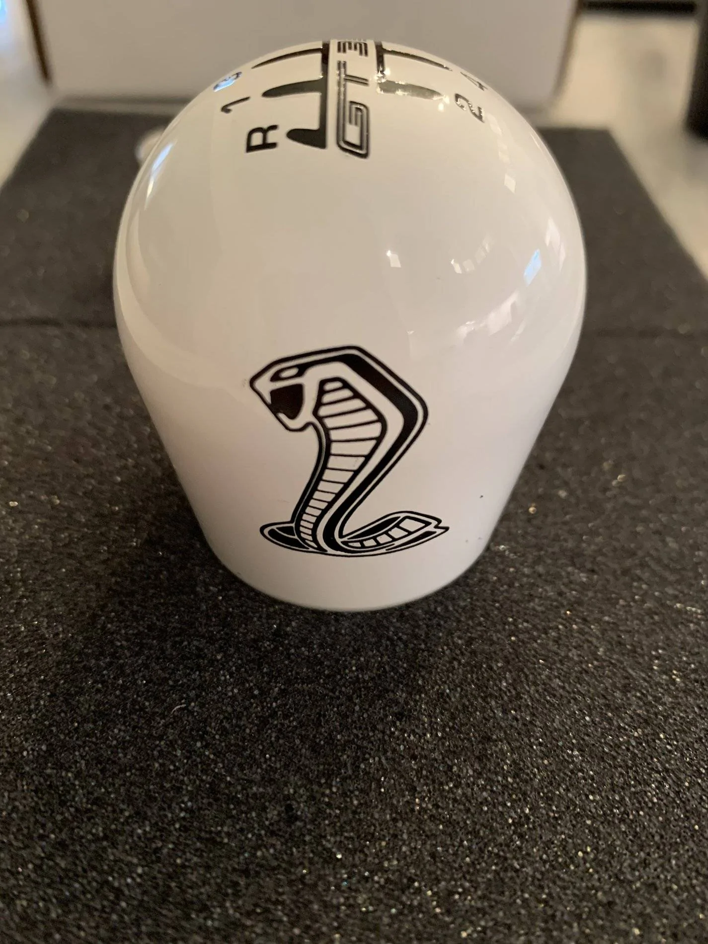

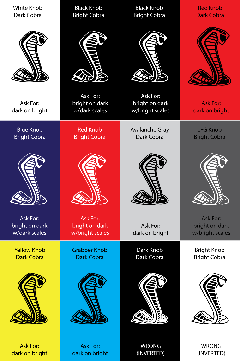

Hey @Spart ,If you're placing an order through Billetworkz, please pay close attention to this so you get what you expect.
As I posted above, in order to have the cobra render properly on a knob that's powdercoated black or a dark color, you actually need to engrave it differently. Otherwise it will have an inverted appearance and it will look wrong.
There are three variants of the logo that Billetworkz should have now:
- dark on bright - this is the one you see in the pictures of my knob above. This is what Ford uses on the exterior emblems. Suitable for engraving on white, yellow, red, or grabber blue powdercoats.

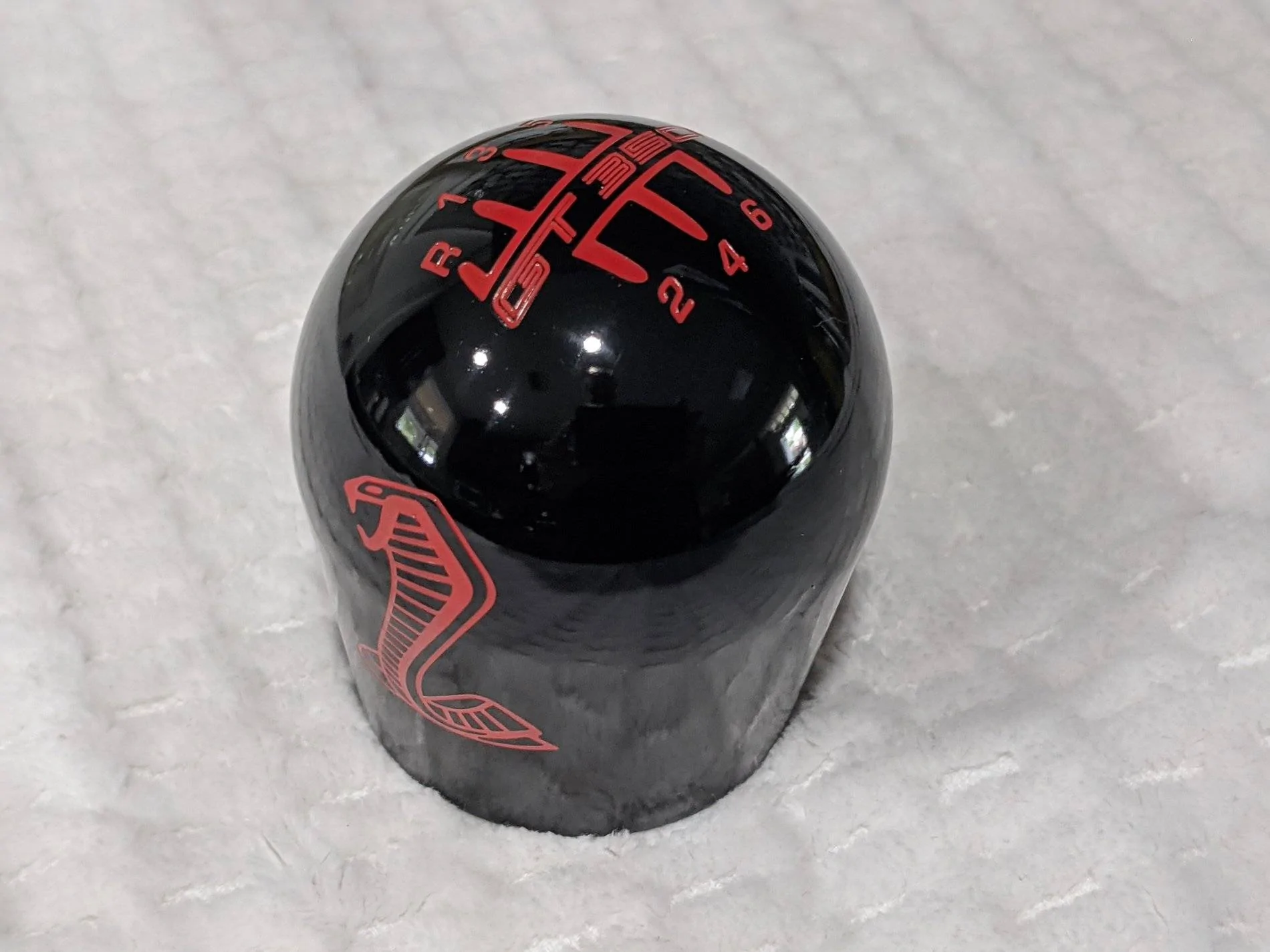

- bright on dark w/dark scales - this is the variant Ford uses on the steering wheel. Suitable for engraving on black, blue, LFG, Magnetic, or other dark colors.
- bright on dark w/bright scales - this is the variant Ford uses on the key fob. Suitable for engraving on black, blue, LFG, Magnetic, or other dark colors.
Below please find a matrix of various color combos, as well as two incorrect examples in the bottom right.
