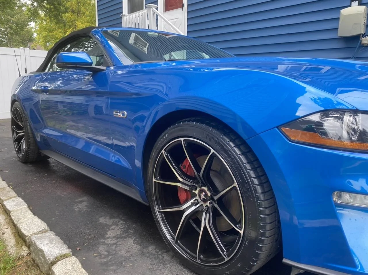

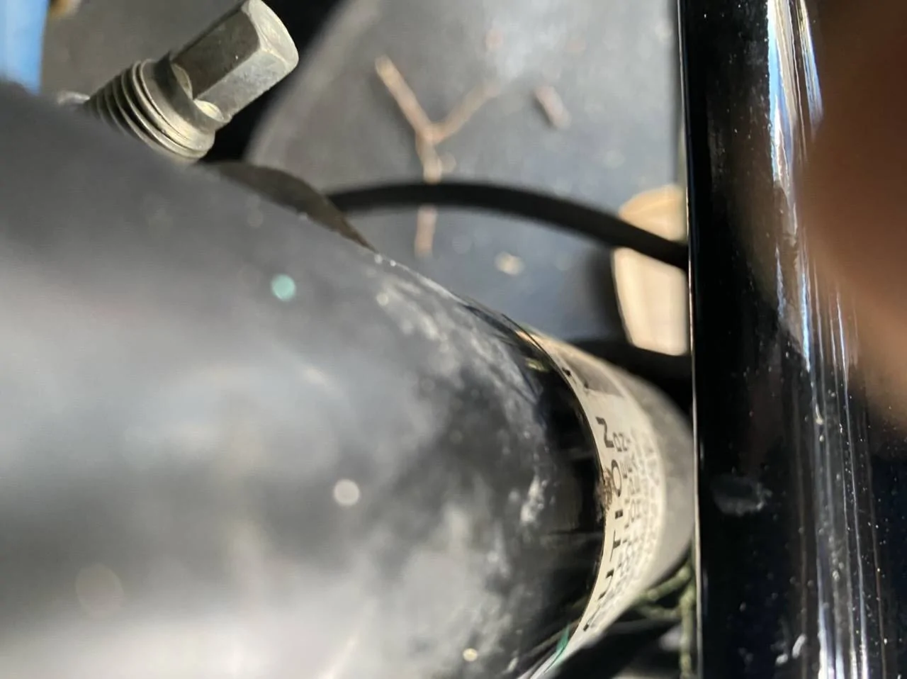

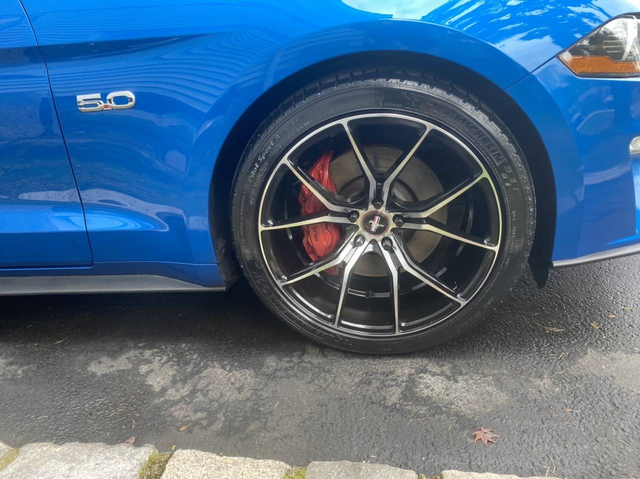

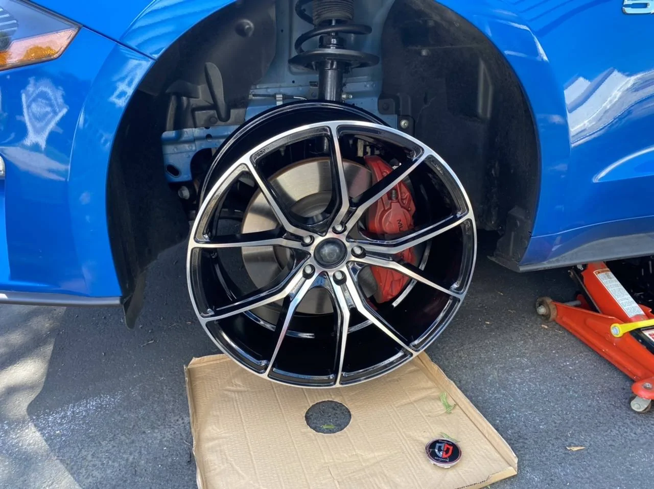

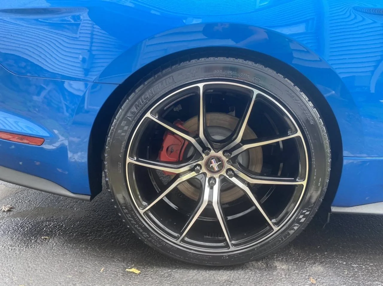

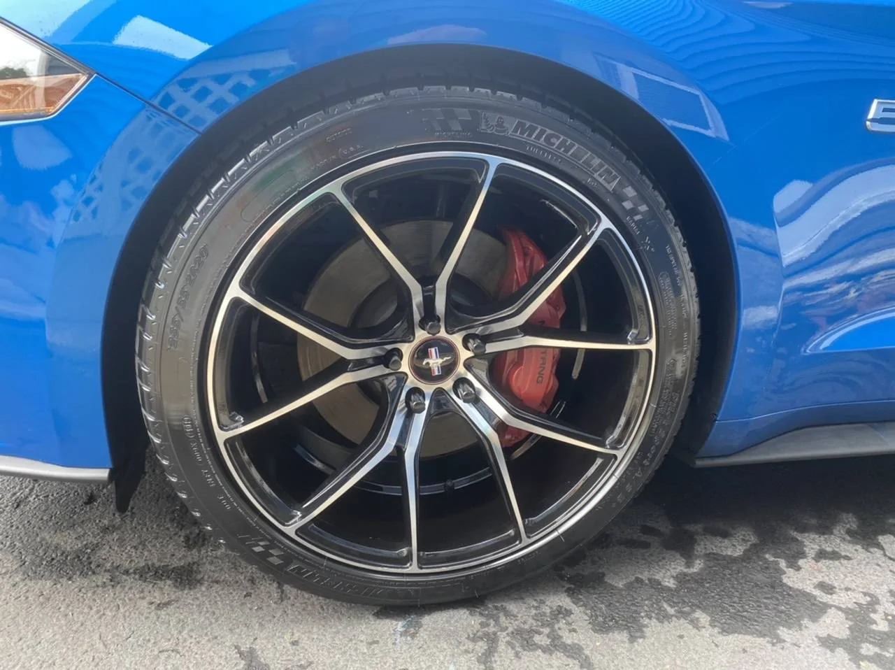

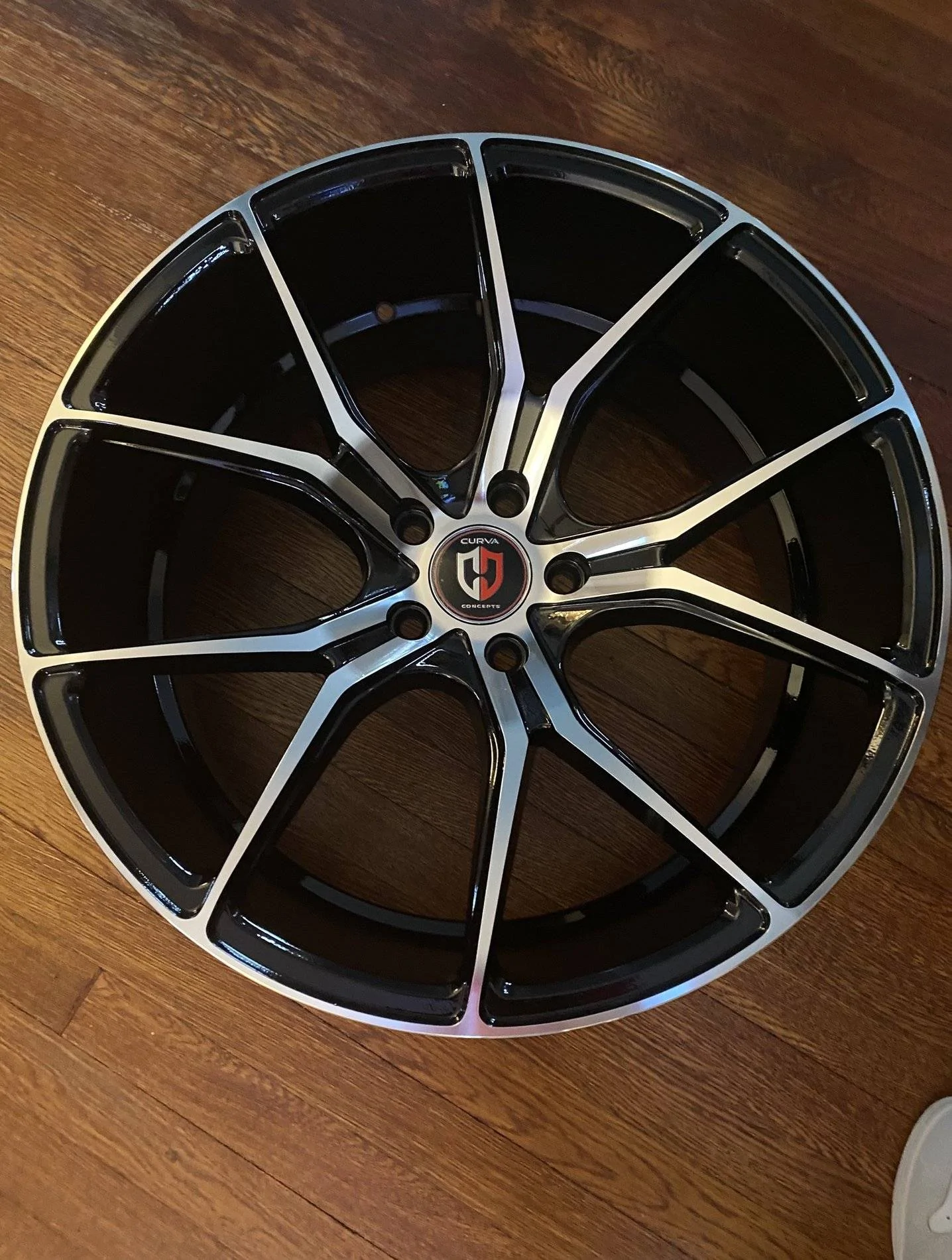

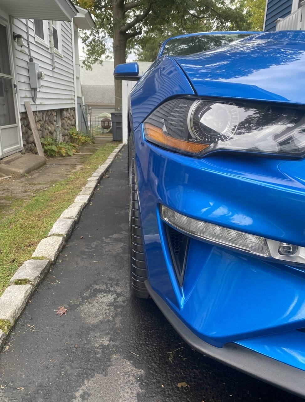

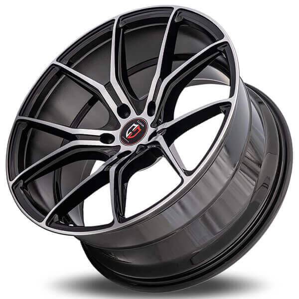

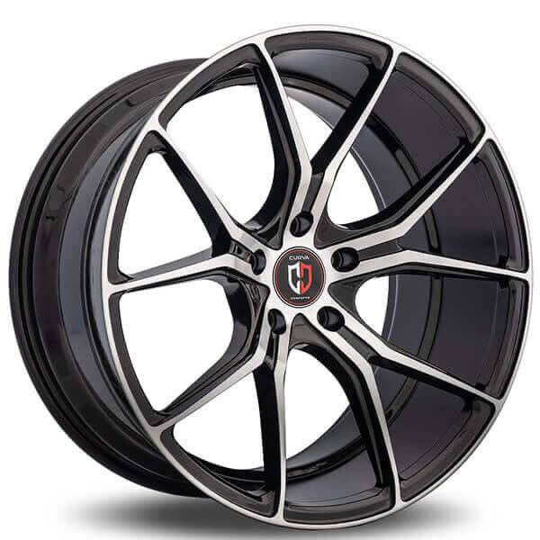

Noob here, was looking for some advise on wheel fitment for my 2019 GT Convertible with oem brakes and suspension.

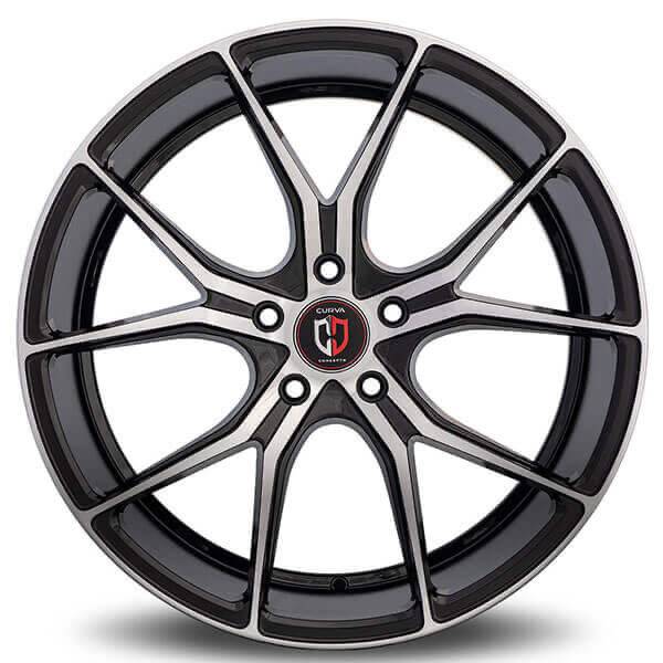

I want these Curva C42 Machined wheels in a square setup but do know if they will clear up front.
Curva C42
MFP# C42-20101143573BMF
Offset: +35mm
Backspace: 6.88 inches
Bolt Pattern: 5x114.3
Plan to wrap them in Michelin Pilot Sport A/S 3+ All Seasons, size: 275/35/20 on all four corners.

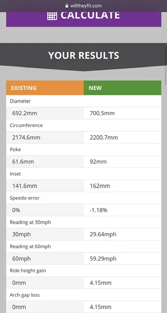

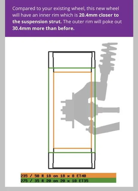

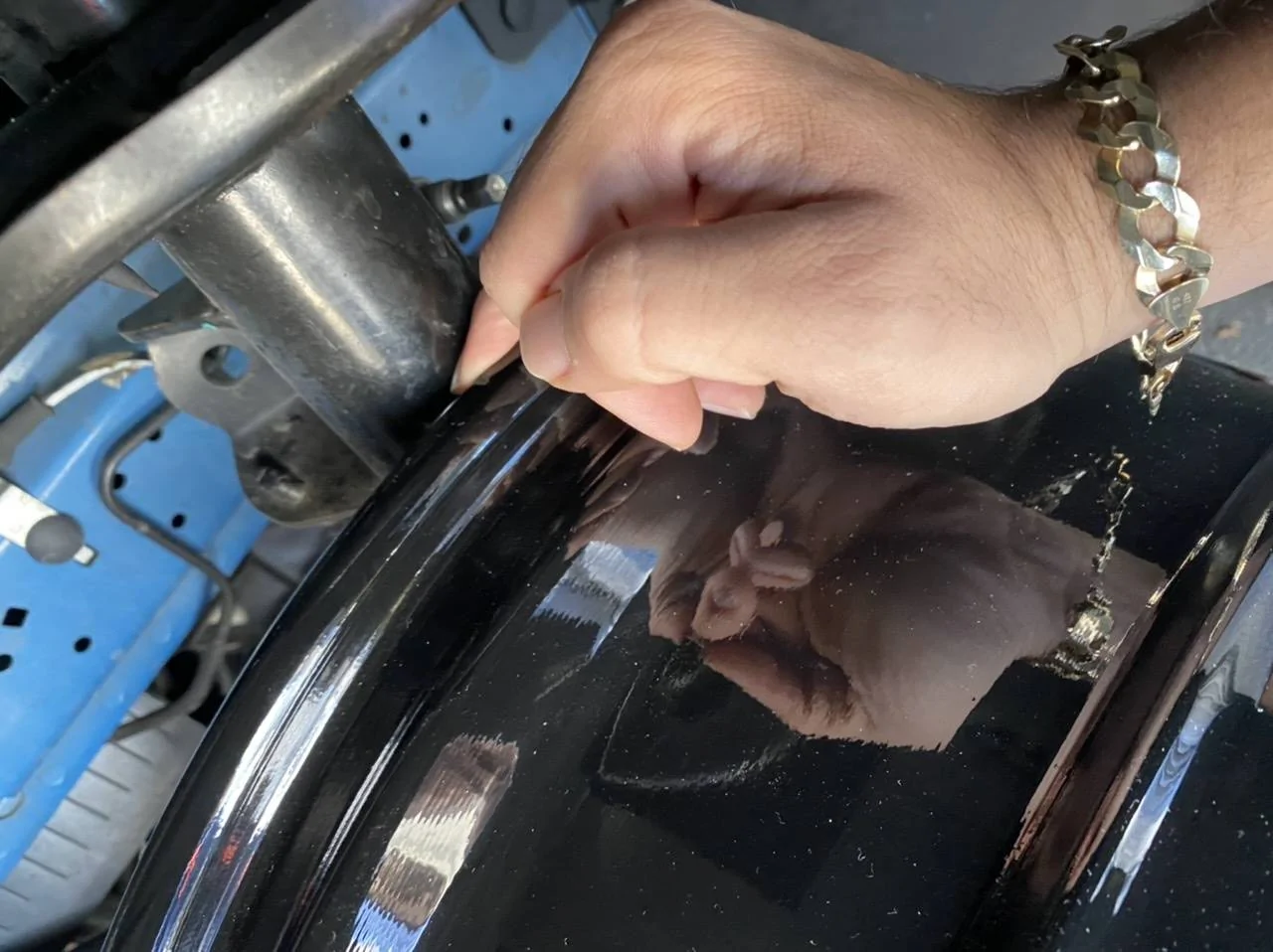

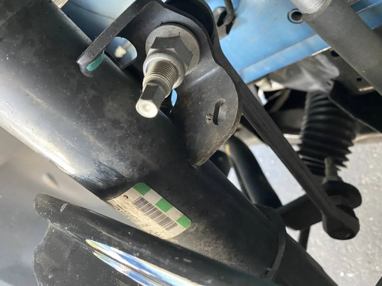

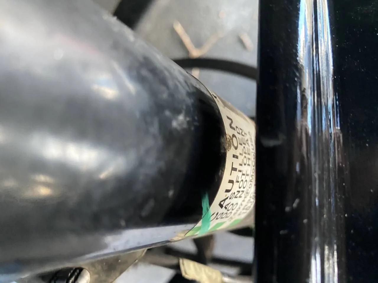

WillTheyFit says 20.4mm closer to the suspension struts
Will it fit ok, or should I also order 20mm spaces for the front?
Thanks in advance

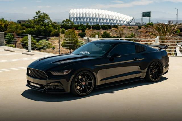

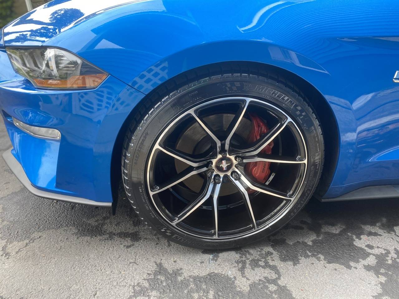

More links to their stock photos and video on an S550.
https://youtu.be/rD4uk3diQgA
https://curvaconcepts.com/vehicle_gallery/curva-concepts-c42-on-a-ford-mustang-gt-2/
