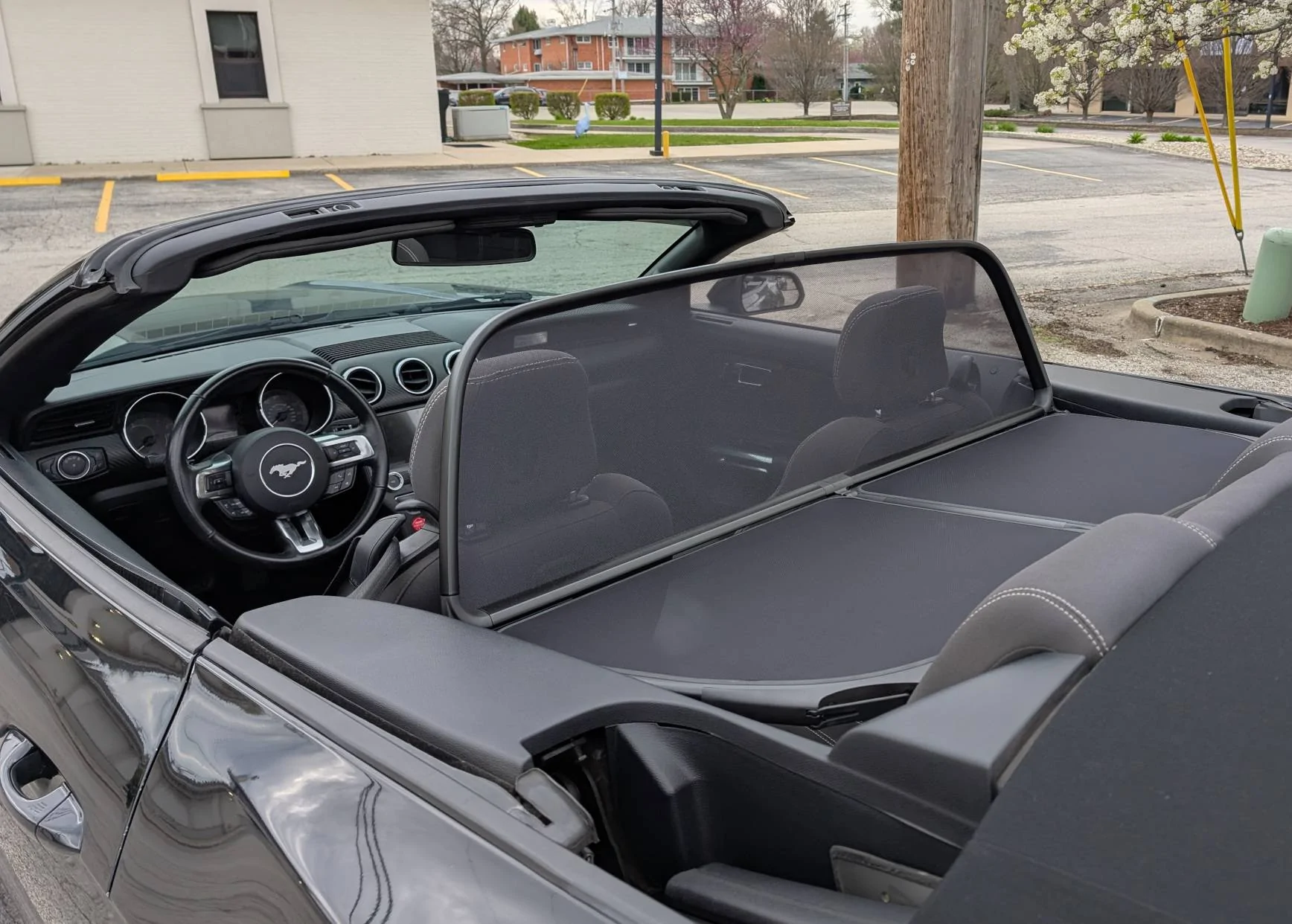

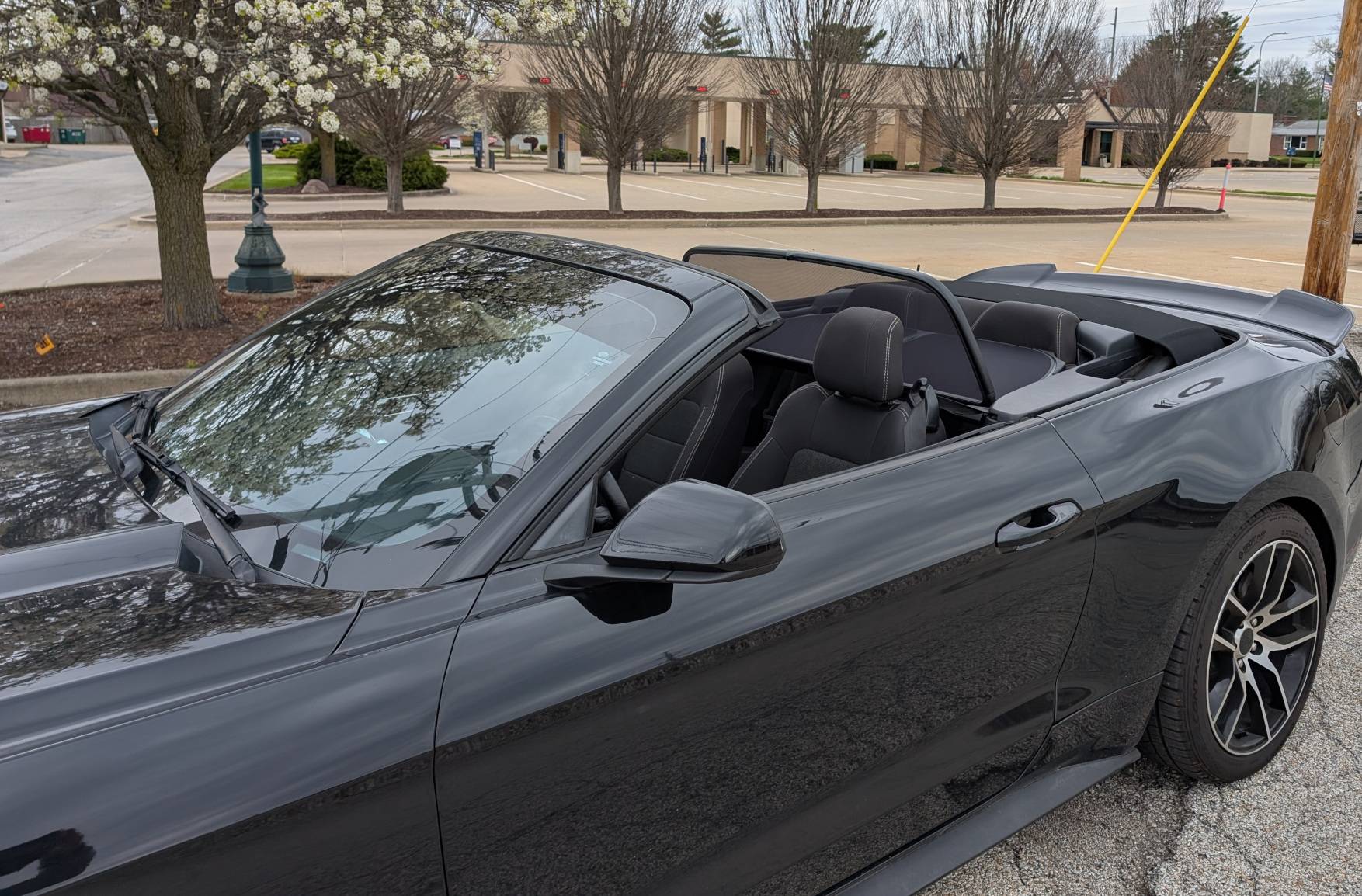

I recently ordered the Audi deflector from ebay. Arrived a few weeks ago, with the "I've never been used vibe." Had to wait weeks for the weather to improve. Installed this morning, using the sdiver68 drill-and-grommet method. Worked like a champ. Looks like it came from the factory with little deflector holes. Also purchased some little caps just in case.

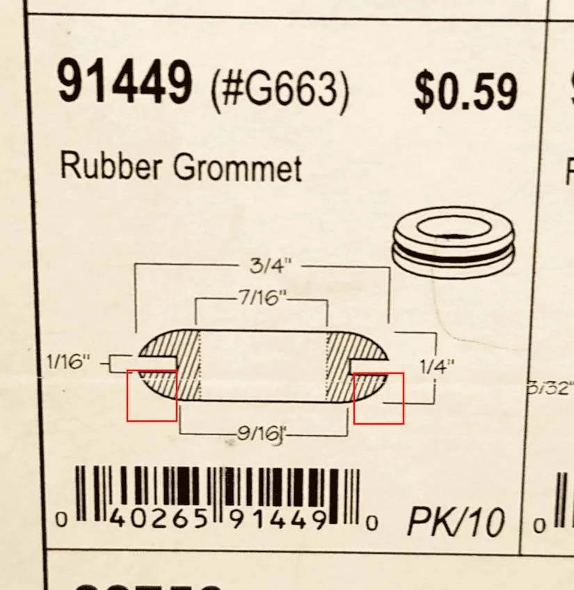

Note for those to use the grommet method: the plastic panel is pretty thick. I had to modify the grommets to fit properly. I just cut off the parts in the red rectangles below.
