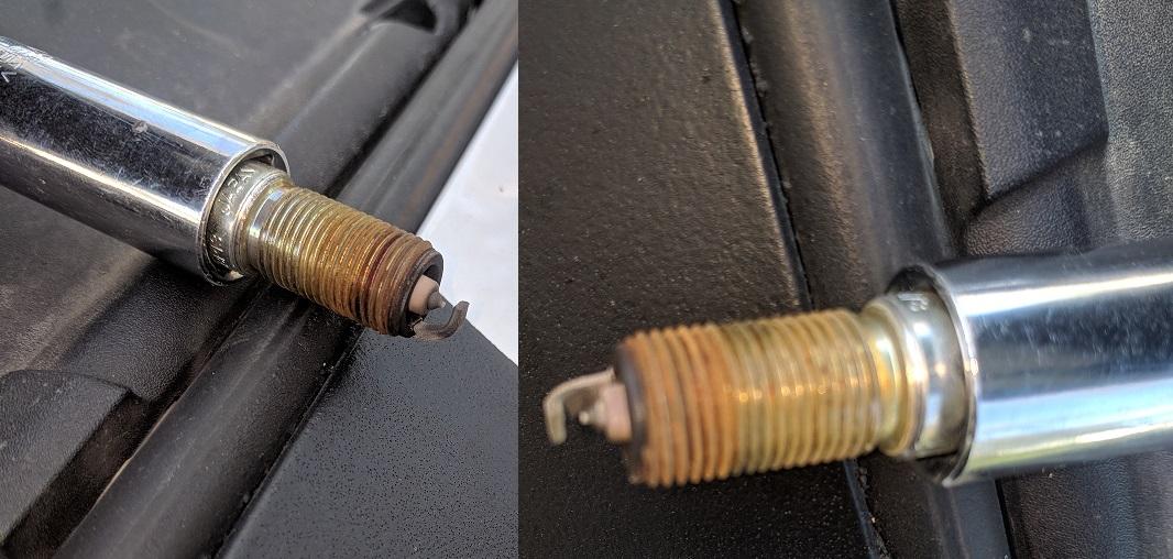

Thanks for your tips! I removed 2 spark plugs out of 6 quickly before to go to work. What do you think about it? (They have 78K).
Also, I heard it could be my upstream O2 sensors. Could it be possible even without a CEL? The car runs great when cold but when it warms up it's a total sloth lol. I heard on some cars they could disconnect their O2 sensors to test. Let's say I unplug my upstream O2 sensors. Does that mean whenever my car warms up I shouldn't have the problem anymore or the car would run even richer?

Just off the top of my head, those gaps look pretty big. Do you have a gap tool to check them? If not, they're free to maybe a $ at the auto parts store.
That's what I was thinking as well. However, I don't have any miss-fire or anything... I heard I can't gap iridium/platinum plugs so I never really looked into a tool for it.

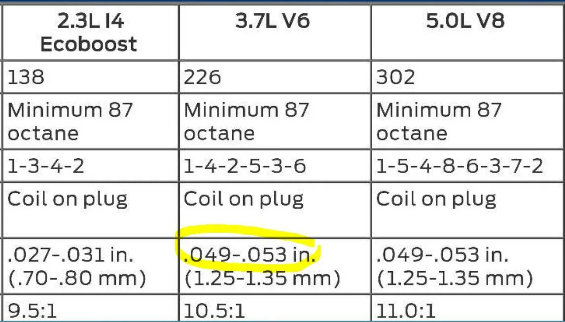

Alrighty, Tomorrow I'm gonna change my spark plugs. I was looking at getting Iridium. I found those Denso 4719 Twin Tip (Iridium). It seems that they come with a .040 gap. However, I looked at the Motorcraft SP-520 and it looks like they come with a .050 gap. I checked on the manual and it says the V6 (and V8) plugs needs to be between .049 and .053. The odd things is that the Denso 4719 are recommended for my engine at Autozone and Rock Auto... Should I just go ahead and leave them at .040 or should I just get my regular Motorcraft SP-520?
Thanks again guys for your help!
