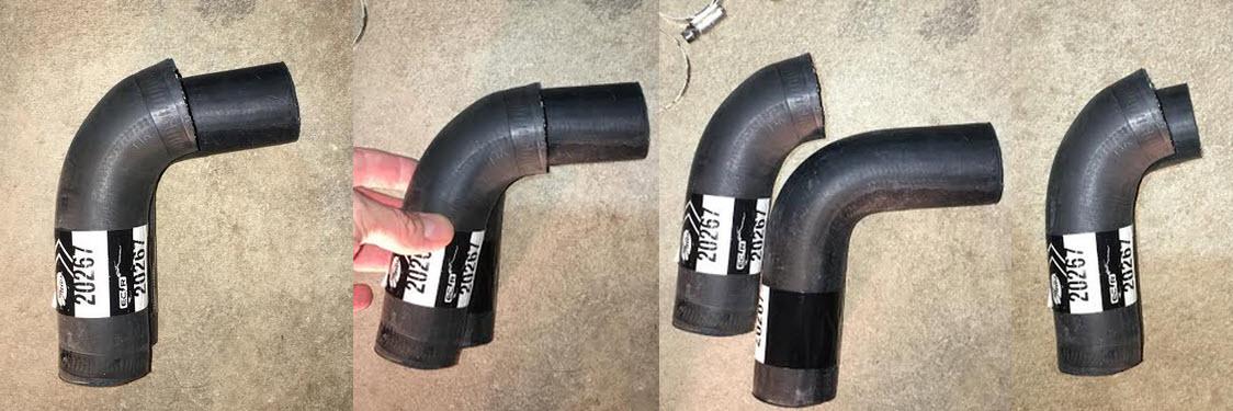

I'm just going to guess because I don't know. But my thought would be no because nothing is rubbing/hitting the engine/drivetrain/exhaust (basically anything metal that could transmit noise into the engine. Can only guess there are rubber motor/transmission mounts so the engine/exhaust and transmission is isolated from the chassis/body. But like the other guy up above said, maybe if it was hitting hard enough maybe. Sorry no real help. Yep, that area was pretty damn messed up on mine until I re-did it, still pretty tight though. Have you tried fuel additive to see if your knock goes away with higher octane? Helped me confirm my knock was real not false. Also, I ended up buying a new Gates hose (same p/n) that the surge valve hooks to from Rock Auto. It was actually shaped different than the one from the PC kit. It formed a tighter 90 degree, smaller inside corner. It seemed to help out, but it still hits the backside of the bumper facia, just not as bad.
The surge valve has two rubber hoses between it and the blower which is hard mounted to the engine, so wouldn't think vibration would travel back up that directions. Again, just a guess.

Yeah, my fit in there was pretty jacked, the filter literally hanging off. I may have cut mine too short. I will try and buy a replacement hose before putting the fascia back on in the morning. I hate taking that damn thing off

Yeah I hear you, I don't look forward to taking mine back apart to re-do my intercooler paint job. I was so anxious I just painted it, should have scuffed it up with some scotchbrite, the paint is flaking off. Bummer. Also, funny thing happened when I bought the hose from rock auto. The first hose they sent was just the straight section with the part ID on it. Looked like the remnent from someone's PC install that was returned for credit. Replacement was good though. Kind of made me laugh. I had no clue it would be shaped different than the one from the kit, but was a good surprise. No clue if they are all like that from rock auto or not.
Sorry no help on the knock info.
