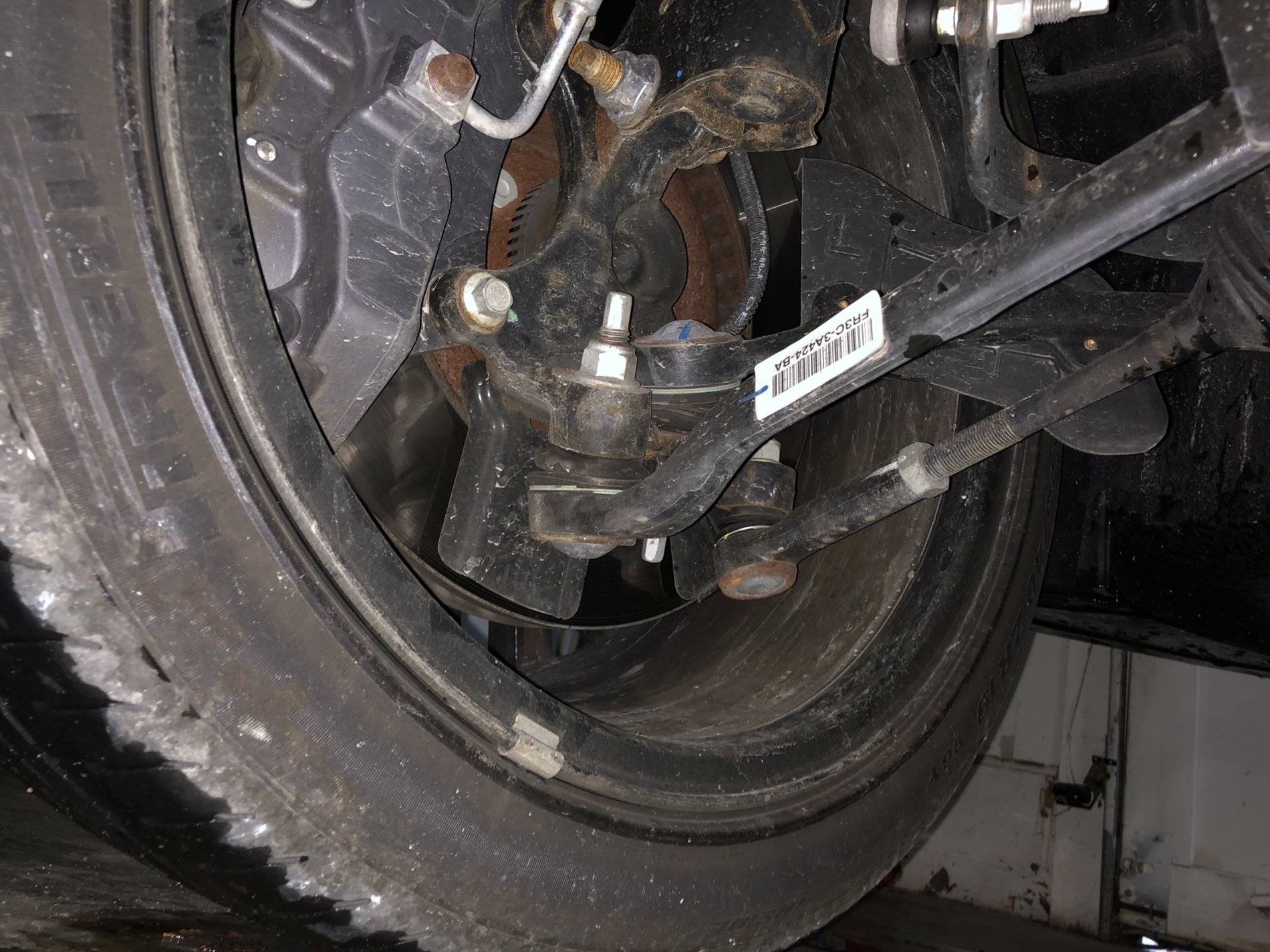

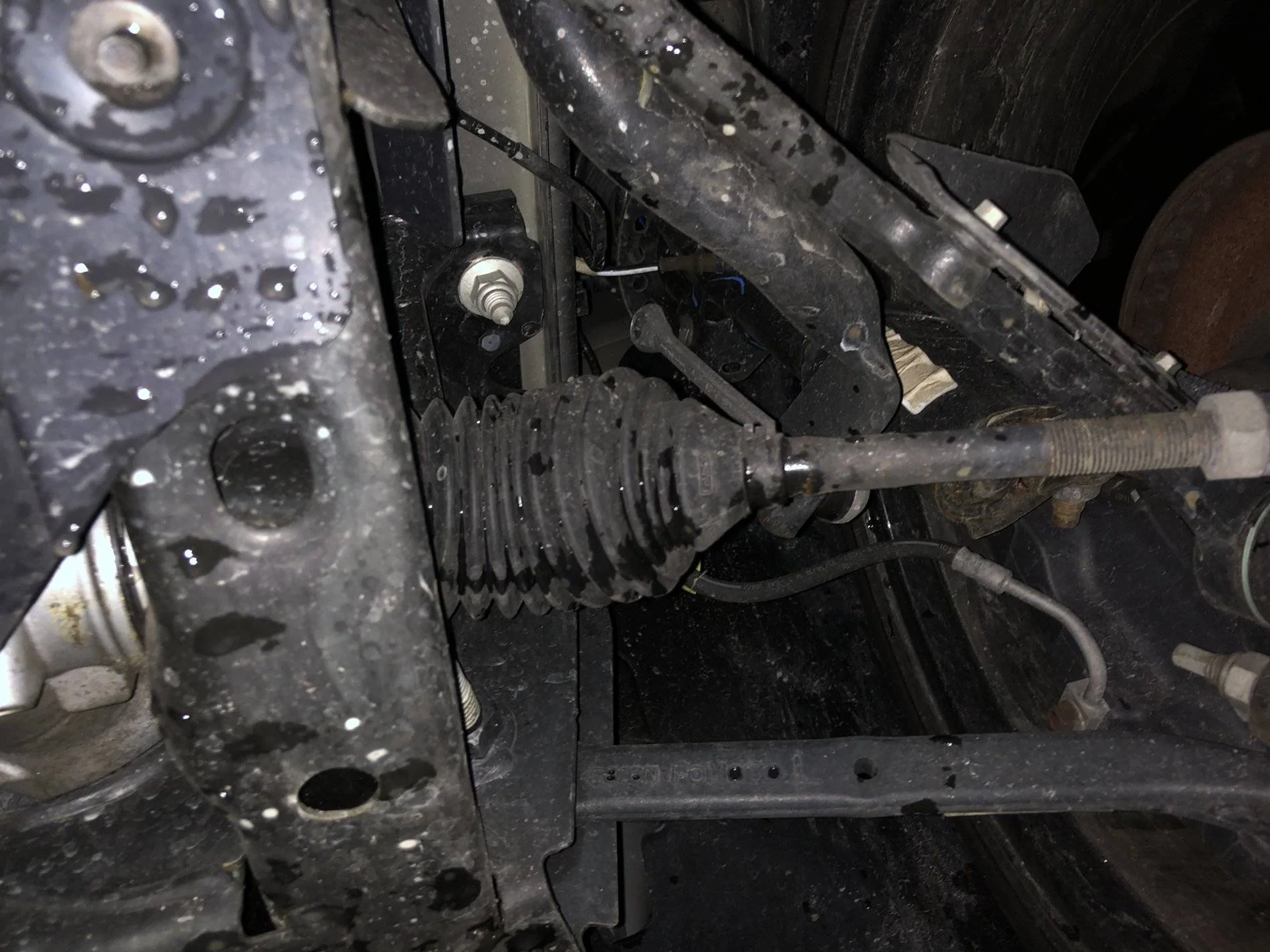

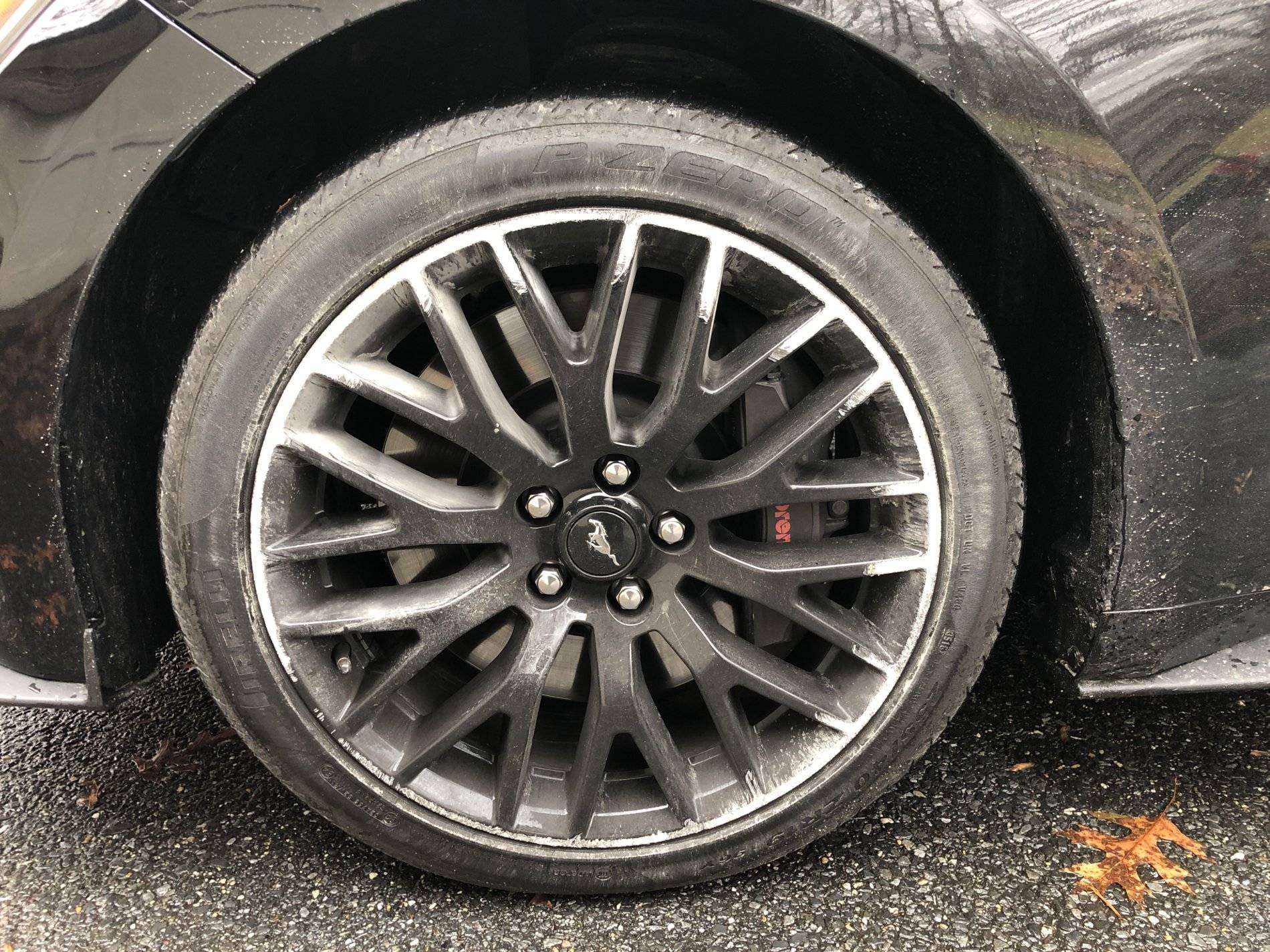

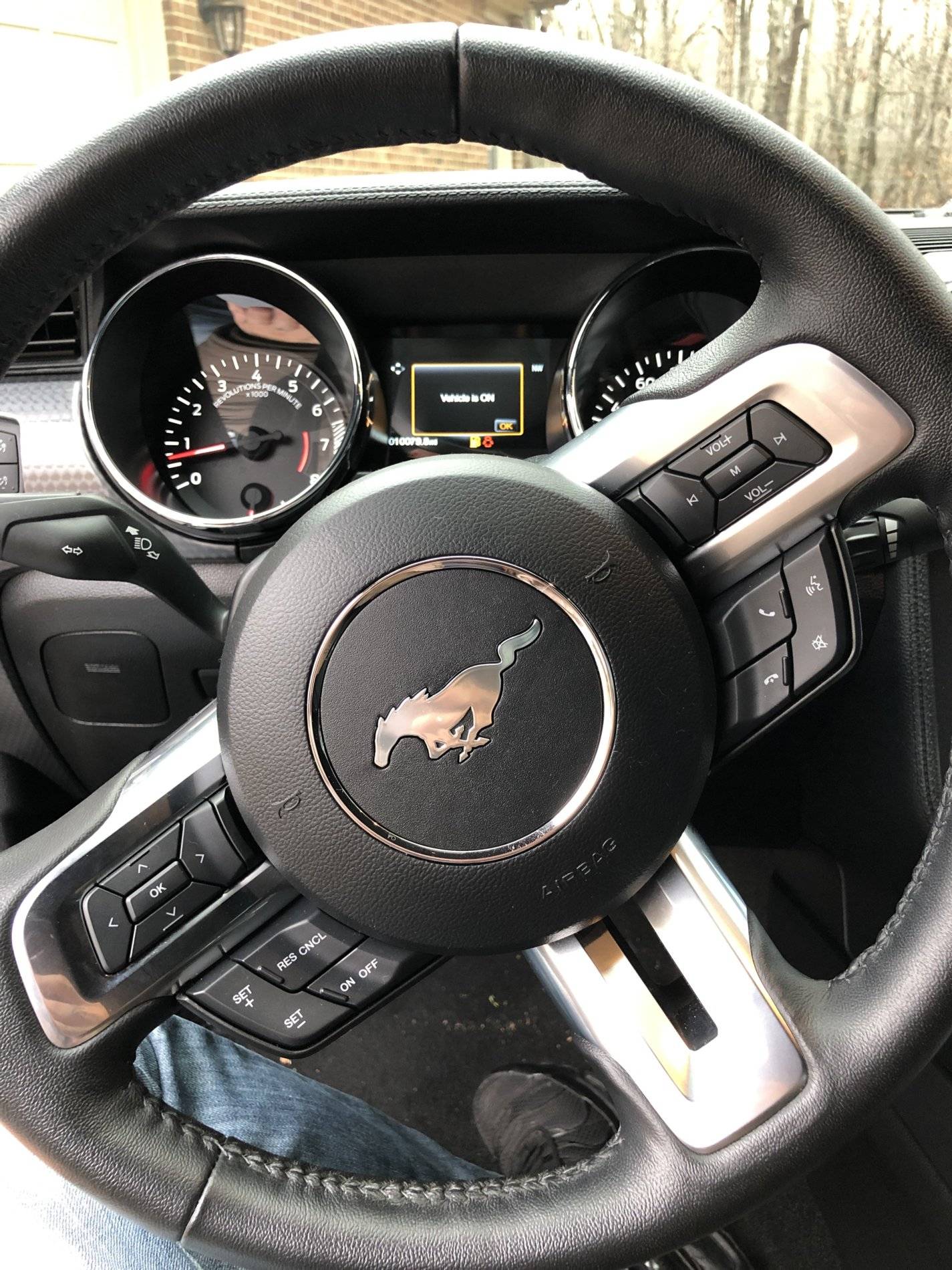

Well I got carried away messing around and I fishtailed and my front wheel driver side at the curb looks like my rear driver side wheel also hit the curb I was able to recover and that totally spaced out but now I notice my steering wheel is misaligned and almost 45° towards the left do you guys think I broke something or been something When looking around the vehicle all you see are curb rash is on the front wheel and the rear wheel no scuff marks on the bumpers no inner fender is broken when driving around it wants to drive straight but starts to lean leftTire pressure is staying good and some slight wobbly and a wobble noise at slow speed’s
Been there done that hit a curb with 80 km/h (49 mph) for me was just an alignment but I need 2 new wheels just like you. Also the wobbly and wobble noise according to my ford dealer is tires/wheels that are bend which make sense so once I get the new wheels and tires for spring season I will know for sure but 3 shops looked at the car and said there was nothing wrong with suspension.
However looking into your photos you probably have something bent so take it to a dealer.

Y’all making me nervous..... I didn’t think it sound that bad where I’d have to claim to my insurance to fix this? I’m going to take it to Alignment shop today and see what they got to say. Thanks everyone, F the wheel, I just want my steering wheel straight and was hoping for just an alignment I care less what the rim looks like

Take it to an alignment shop and tell them what happened. Ask them to check over both the front and rear suspension. Ask them to throw both wheels from that side of the car onto a balancer, because if the rims are bent, it’s definitely going to be visible when they activate the balancer. Let them tell you what they find and go from that point.

If those rims aren't bent and can be balanced just sand that rough area down an paint the whole wheel from 10 feet away no one would be able to tell.
