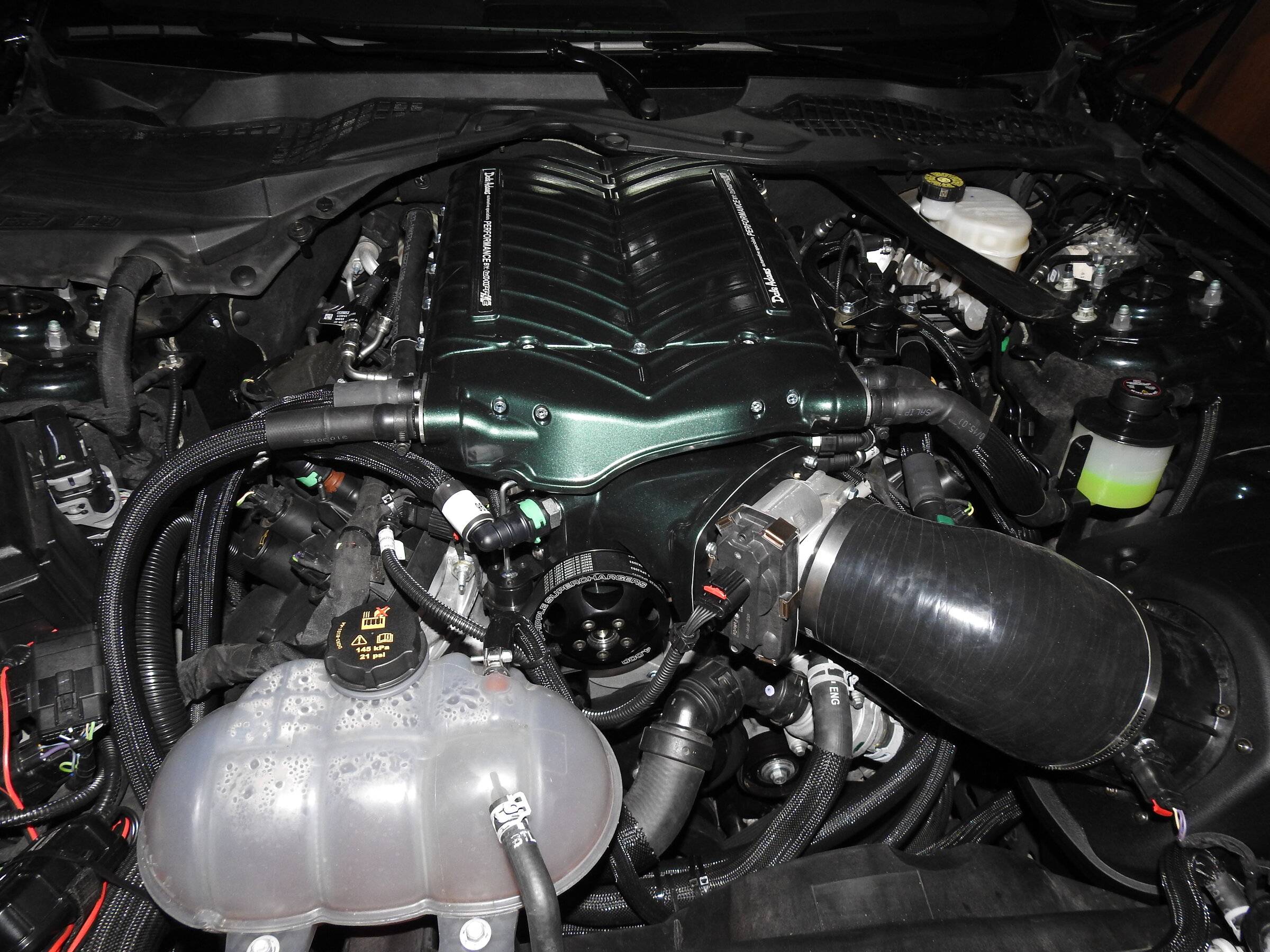

Whipple Stage 1 recently installed. I went with a modified Whipple tune and increased WTQ by 63% and WHP by 50% with a significantly louder 'cackle'. Torque wins races and substantially increases the "holy crap!" factor.
