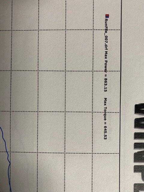

zero chance a blower only hit 890. The Gen 5 does wondrous things on this car, I wish I had one as I am a gen 3, but it isn't magic. That would be Injectors / fuel system, e85, ice box, LTH, spicy timing hero run.

863whp & 645wtq @10 psi Gen 5 pump gas/ torco, Lund tuned, American racing full headers & exhaust, id1300x, vmp Booster, gt500 ignition coils, gt500 oil pan & pump with boundary gears, tss crank gear, fluidyne radiator, 170 thermostat, gt500 valve covers, qa1 driveshaft.
