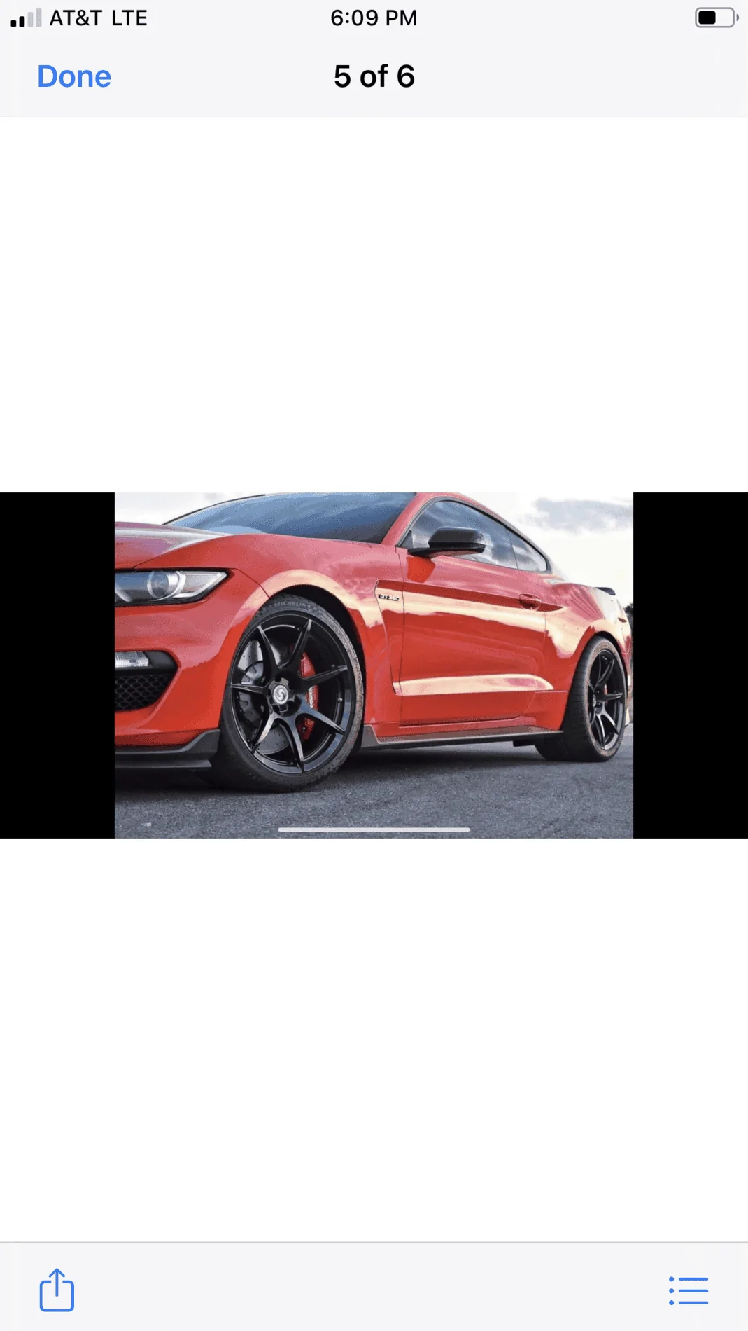

My only consolation is that his wheels did cost almost as much as my blower LOL
