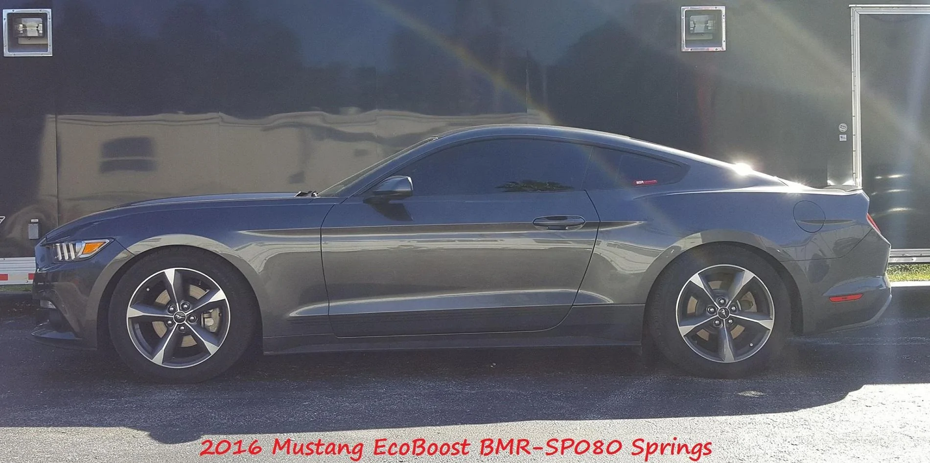

This is how an EBM sits on our SP080 Spring Set.Not enough of a drop in the rear for the look I'm going for. Prefer about an inch or so and a level static stance.
This is a good looking stance overall. Sure doesn't look like only .5" in the back though:shrug:This is how an EBM sits on our SP080 Spring Set.
It is...the back doesn't need as much (also doesn't jack the rear suspension geometry).This is a good looking stance overall. Sure doesn't look like only .5" in the back though:shrug:
