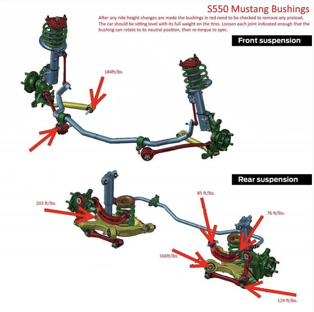

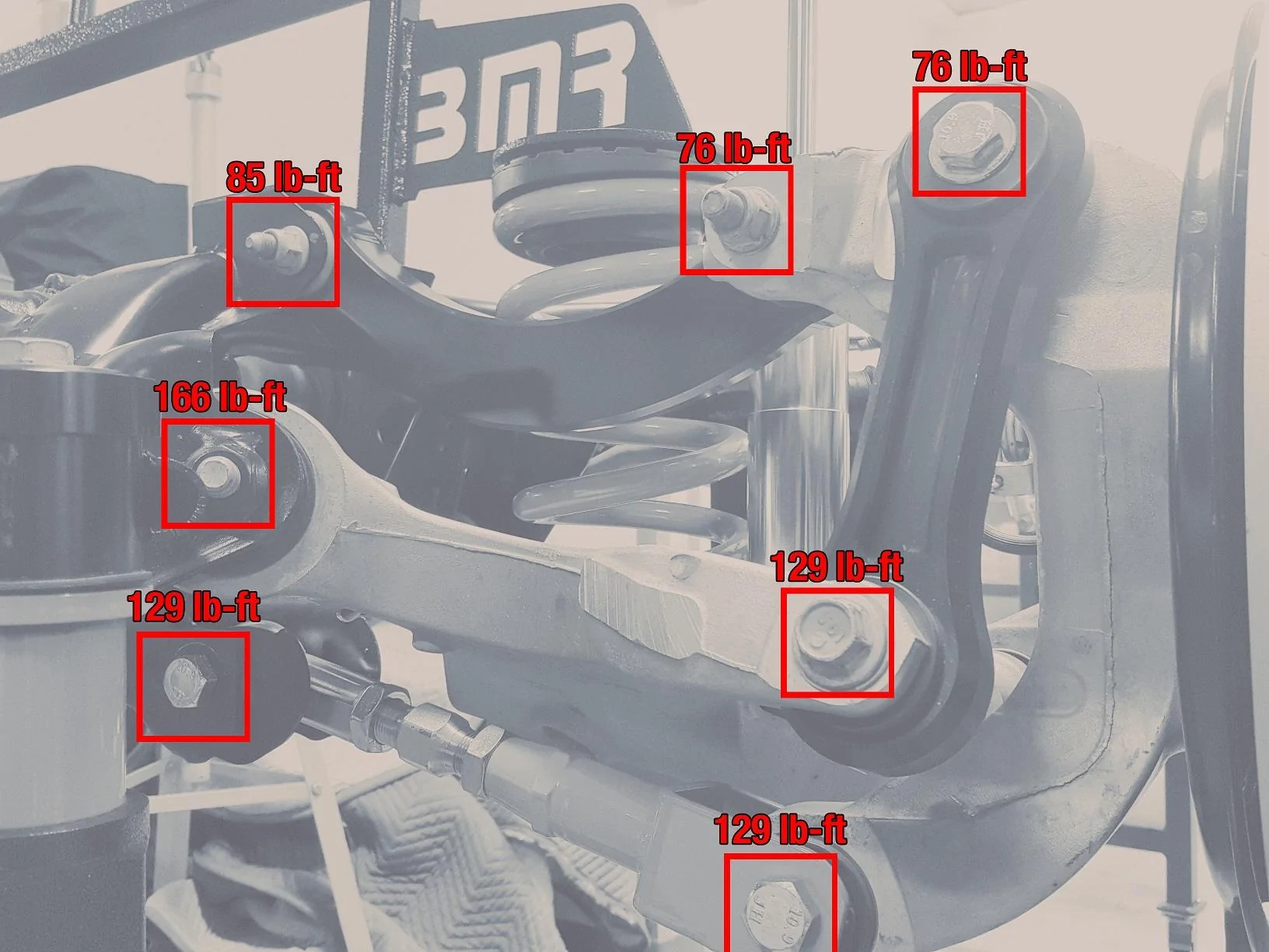

    I have the ford toe knuckle bearing and steeda lateral links with bearings. Is it still required to loosen these locations?
    Also these 2 pics show different points (vertical links). Are the vertical links included or no? I have steeda ones with poly bushings if it matters. 1.jpeg 2.jpg

    It is good practice to loosen and torque every suspension pivot point with the full weight of the vehicle sitting on the tires.
    Components that have a poly-bushing or a monoball/rod-end/spherical bearing do not technically "need" to be clocked or indexed at ride height, BUT...if the part has a protective rubber boot such as the Ford style (toe knuckle bearings) - indexing and torquing at ride height will help the protective rubber boot live a longer life.
    Polyurethane bushed components with a free floating (non bonded) center sleeve, do not really need to be torqued at ride height...but again, it is good practice.
    BmacIL likes this.

    It is shocking how much that inner control arm point (166 ft lbs) needs this, though really needs replaced with a bearing. I am loving the change to one.
